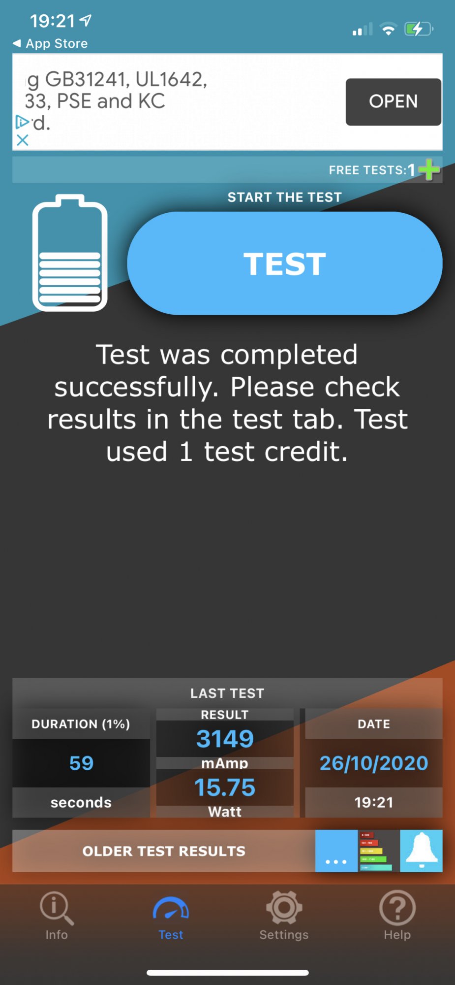

My Aukey 36W USB-C brick charges my iPhone 12 via MagSafe at 15W.
