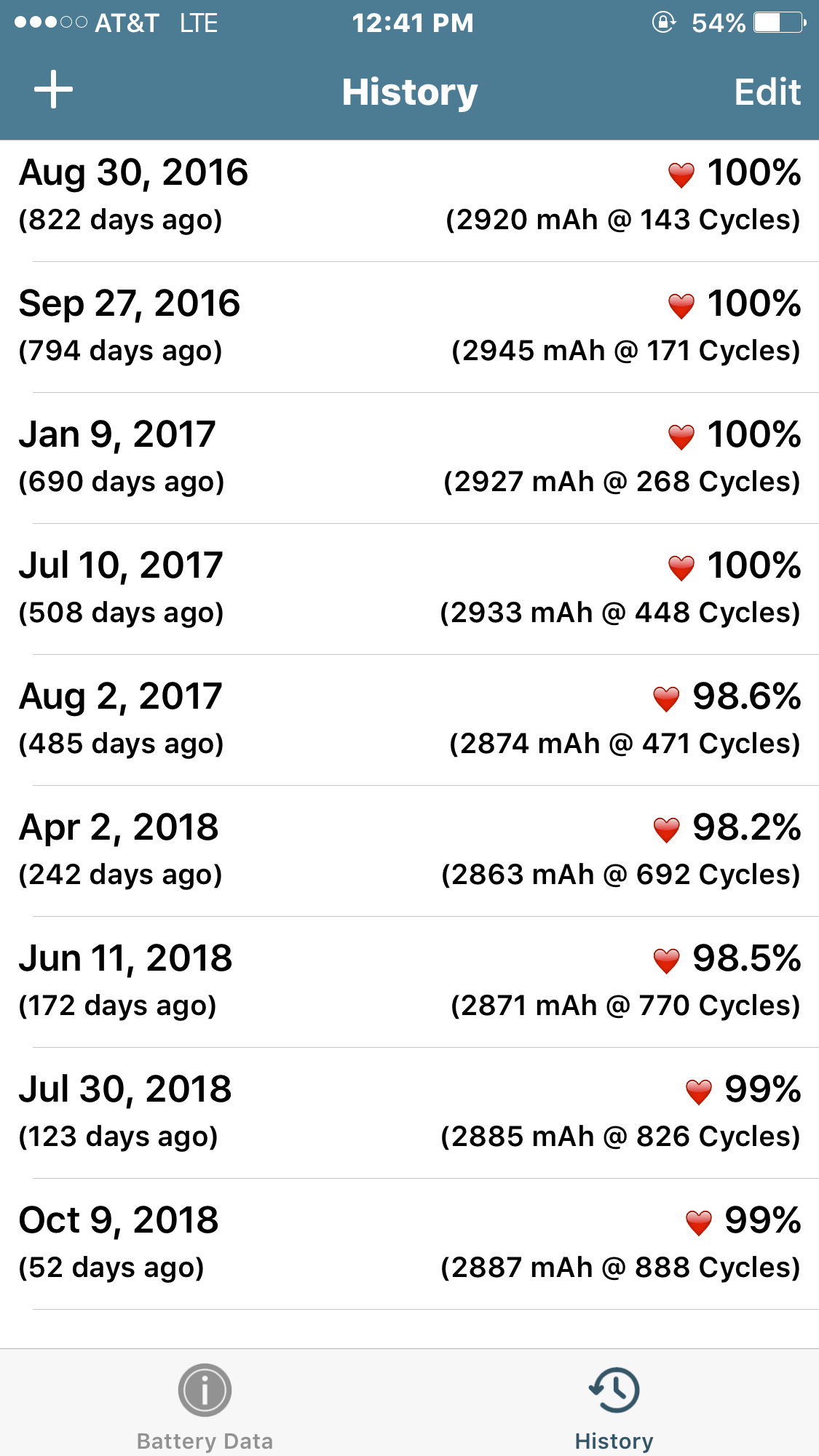

To counter your anecdote with my anecdote, I always charge my 6S to 100%, I let it drop to near 0% fairly frequently, and the battery performance is still at 100% after 6 months. The phone it replaced (Apple replaced it because of a GPS issue) was 1.5 years old, was treated the same way, and was still at 96%.

Battery degradation is chemistry. Happens with every battery-powered device.
If you want your battery capacity to last longer keep the charge between 80% and 20% as much as possible. Going to 100% and 0% destroys the capacity faster.
I don't believe this is true. This is advice from the old NiCad days, and is not applicable to Lithium Ion batteries.
