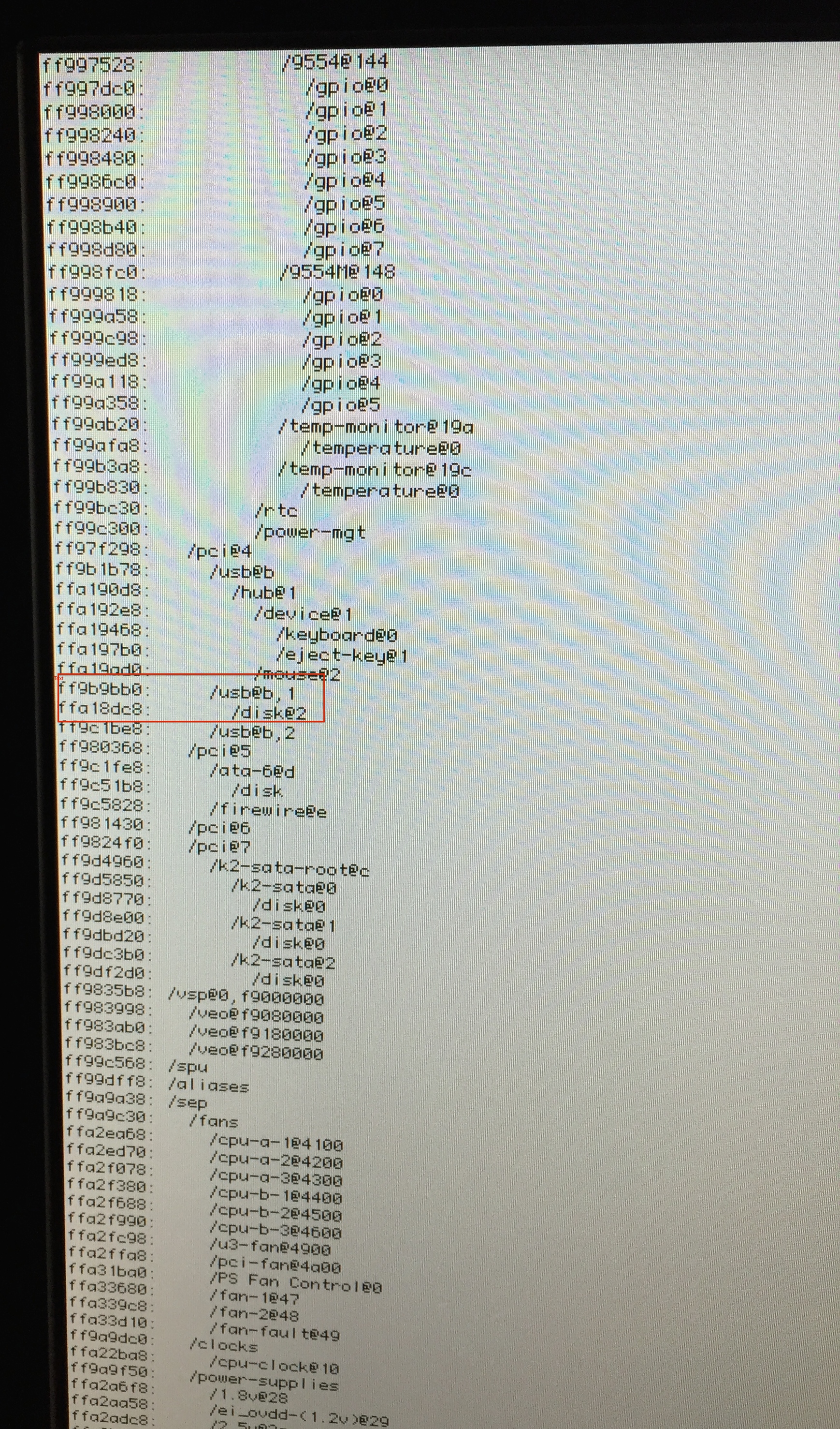

1. Boot to Open Firmware
2. Type Dev / ls , and parsed the list until I found this
(uploaded below also at full resolution)
3. Typed boot usb@1/disk@2, \\:tbxi
At this point, the screen goes black, I get a dark gray screen that flashes text on it too quickly for me to read, and then I get the gray screen with the stop sign.
I'll also add that at one point, I tried looking at the devalias output. I don't recall(and didn't photograph) the output, but found the alias that appeared to corresponded most closely to usb@1/disk@2 . This gave me the exact same result as when using the above procedure.

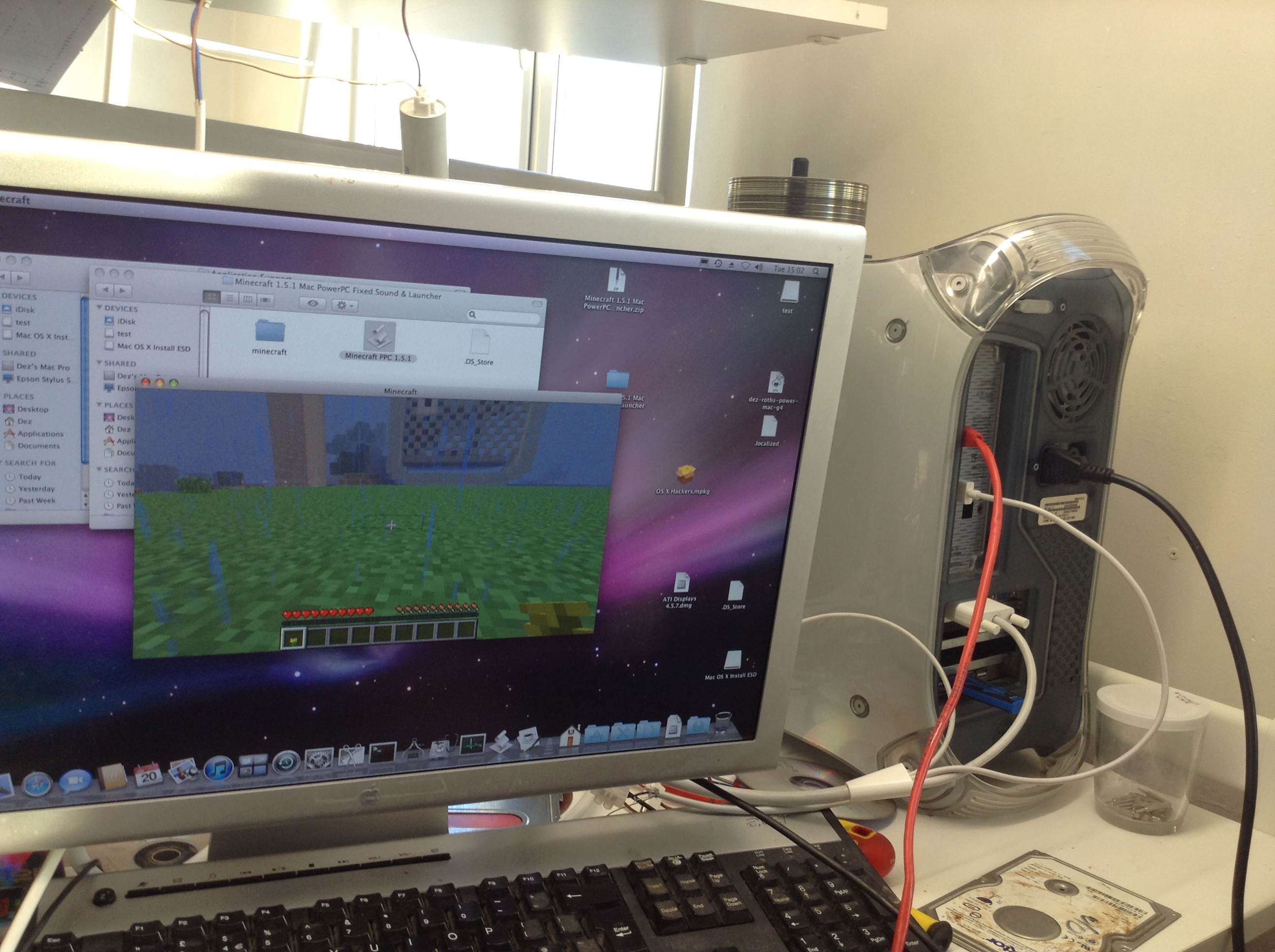

I would Have to disagree with this as I have 2 different USB cards and they both allow me to hold option and boot from a USB drive on both my MDD and sawtooth I suspect whats happening is they are being seen by OF as USB 1.1 Devices and during the first half of booting its USB 1.1 speed then the OS takes over and switches into full speed mode if that makes sense. In the pic attached I have my sawtooth booted from the blue USB stick you see plugged in
Booting from a non-built in USB port is not possible on PowerPC Macs. OpenFirmware does not properly initialize PCI USB cards until too late in the boot process to allow an OS to be booted from them.
I have installed Leopard on my MDD atleast a half a dozen times by booting off the Leopard USB stick i made with it plugged into my USB 2.0 Card works just fine infact i JUST did it 2 days ago i didn't install Leopard just booted the installer to make sure my ATA100 bus worked after the board swap.
