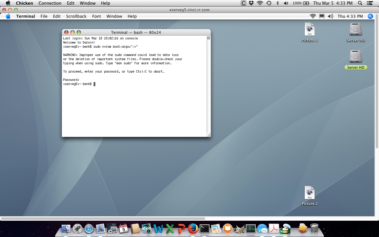

Thanks, just did that.
I love VNC-I'm laying on the couch now watching it snow, and was able to do it from my MBP. I'll try again when I go back upstairs to work on the Xserve directly again.

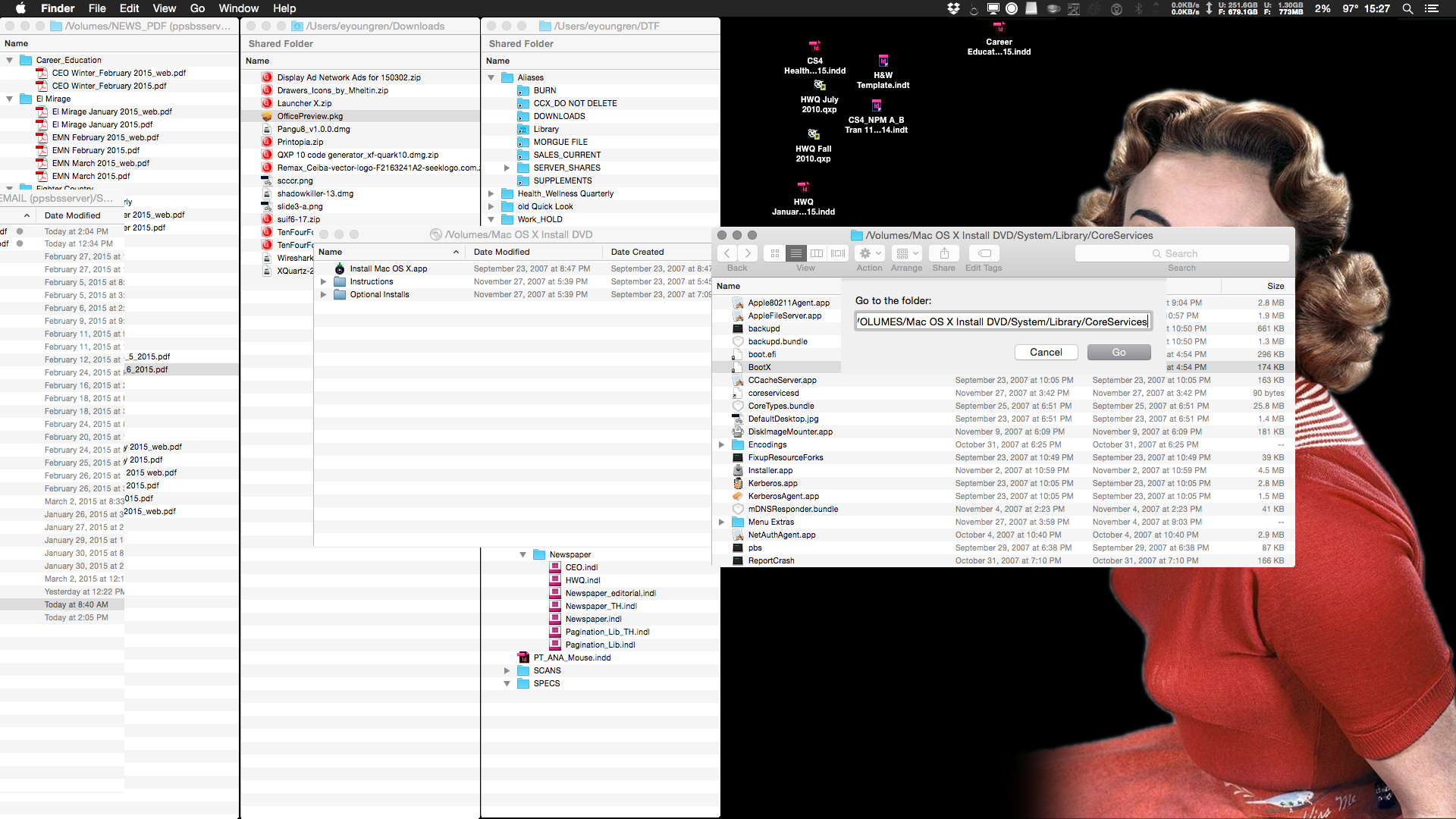

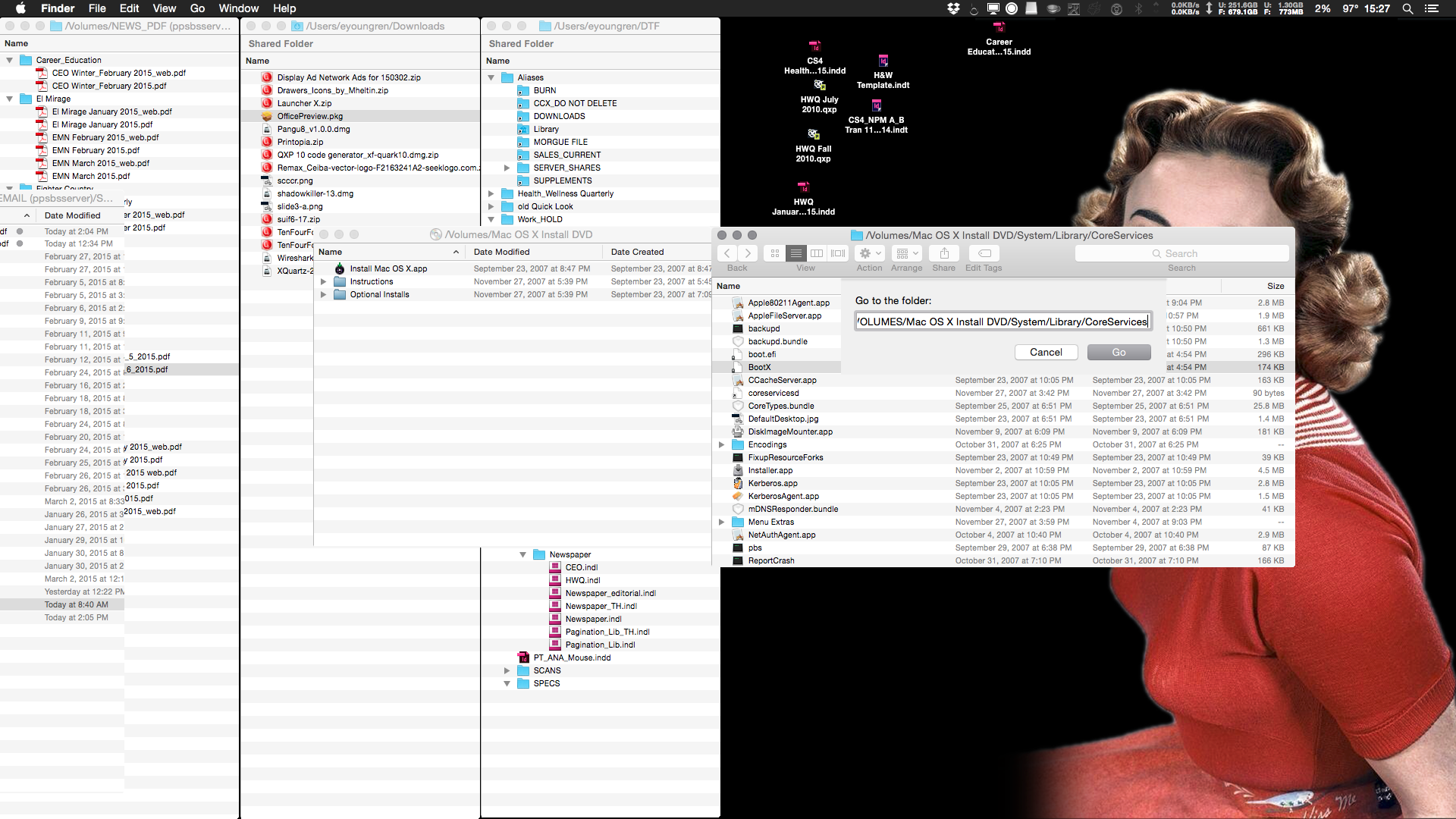

EDIT: Here's a screen cap of my OS X 10.5.1 Install disk. The window on the left shows what I see on the desktop. The window on the right shows the direct path (using CMD+SHIFT+G (Go to Folder)). So, the folders are there, just hidden.
If your folders are NOT hidden then maybe something is wrong? What happens if you tell Finder to go directly to that path?

Thanks-I just didn't dig enough.
Boot.efi, Bootx, and ReportCrash are all there in the Core Services directory on my flash drive.

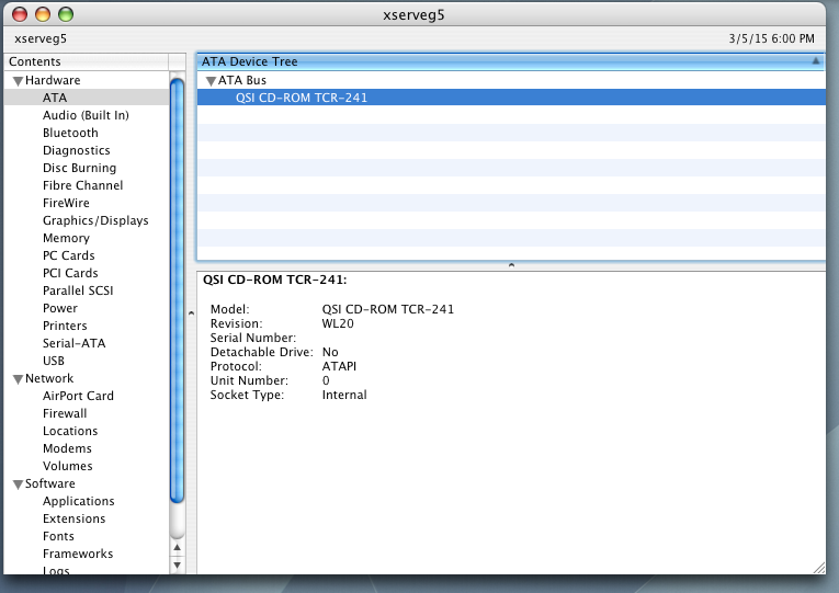

Does your xserve have just a cd drive?
Mine did, I ended up taking it out and replacing it with a superdrive from an intel white imac.
I actually just checked this, and sure enough you're correct on this-I suppose that's why it spit my install disk back out!
In the mean time, I suppose that it's down to a TDM install.
I wonder if a Powerbook DVD drive would work...
