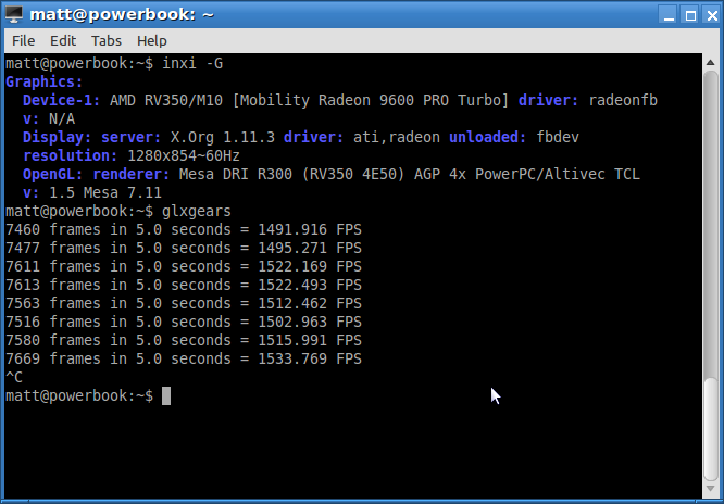

Holy balls! Thanks @sparty411 for showing me this! I just did the mesa downgrade on my powerbook running ubuntu 12 remix. What a difference. Before glxgears showed roughly 60fps, and now.....
Rendering in InterWeb is insanely better, page scrolling is smooth as butter, compositing works, videos seem the same as before. I have no trouble with 720p videos using xine. All in all... a nice experience for an old powerbook.

Well...after some fiddling, the downgrade is a 50/50 win/lose. Gaming-wise colors and polygons are wonky in the 3D games i tested like bzflag. On the upside glxgears output is impressive, and all 3 web browsers seem a bit more nimble. So for non-gamers like me its a win. 😉

Just done this on my Powerbook too...glxgears is up...but video playback is non-functional...let update manager restore to previous mesa but still no video.
Any easy way out of this?
I've never tried to upgrade back from the downgrade myself as I keep installing test builds of v4/macbuntu.
I have noticed however... with v4/macbuntu and the 3.13 kernel there is no need to downgrade mesa. With the proper yaboot boot params 3d still works (on our PowerBooks anyway). I get around 850-900fps in glxgears. Sure it's not 1500fps, but it's not a hack either.
Cheers
Before I downgraded, my v4 with 3.13 was peaking 70FPS in glxgears and OpenGL renderer reported as software rasterizer - after the downgrade, 1500FPS and OpenGL renderer correctly identified as hardware.
Now I'm back at the original mesa the broken video is down to mplayer library mismatches - is there a method for moving the files from the install disk?
Try this: vblank_mode=0 glxgears
That will give you a better reading.
To enable 3d you'll have to disable kms and radeonfb in yaboot otherwise it will use software rasterizer (which I find works just fine other than 3d gaming)

I had to copy the entire usr/lib from the live disk to restore video playback and although setting the suggested yaboot parameters seems to lever the GPU more, it returns poor video playback.
So...all in all, no to downgrading mesa for me.

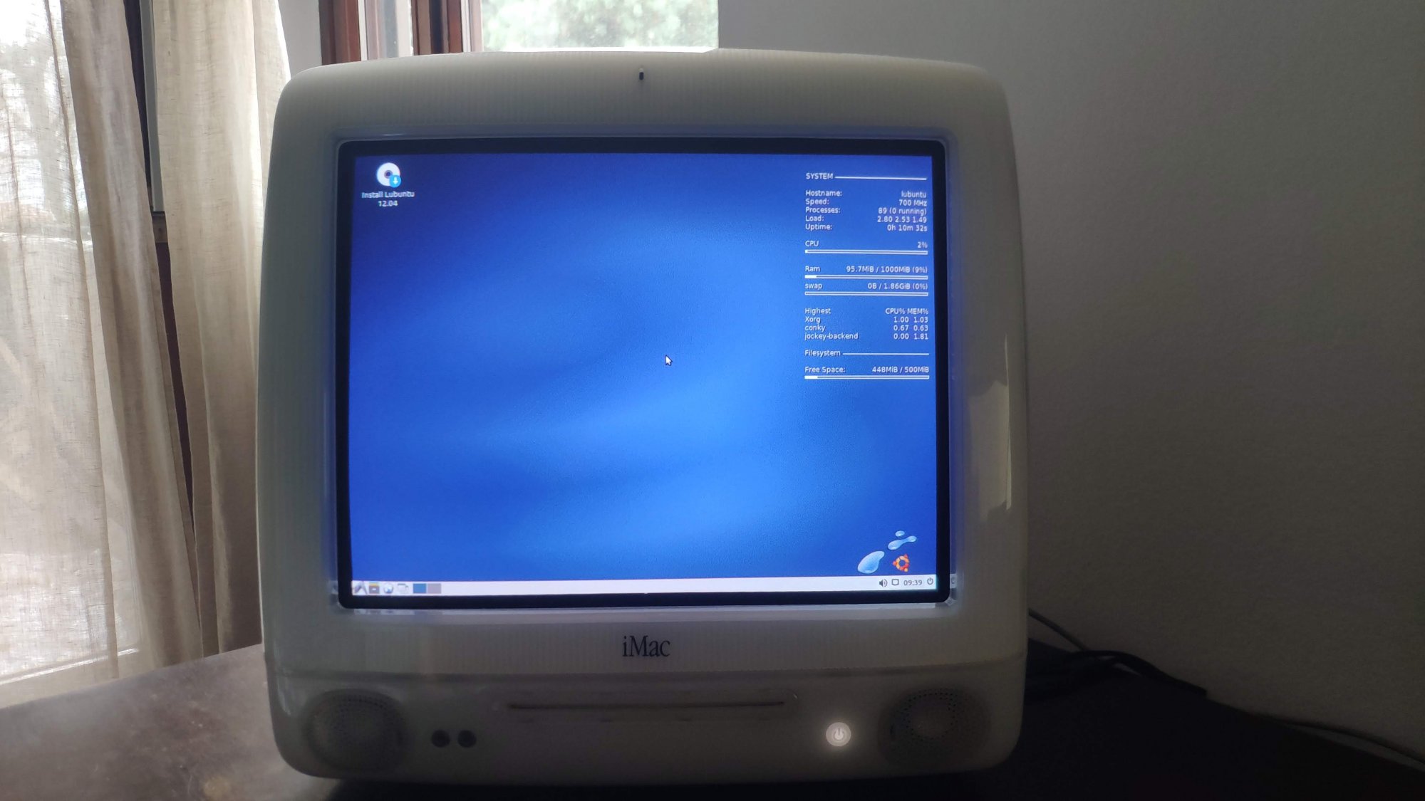

Francesco, I am also trying this on an iMac g3 with an R128 card but I am still stuck at a blank screen, I have been experimenting with Xorg.conf files but not very successfully. I am trying to use LXDE. Do you have any suggestions? Antonio

Ciao Antonio,
I have analysed several scenarios during the last months.
Having an iMac G3 with ATI Rage 128 working properly & with hardware acceleration enabled it's a matter of a delicate combination between xorg version, r128 driver version, kernel version and mesa driver version + extensive tuning of the xorg.conf.
I am going to create a specific guide for enabling it so that everyone can follow it.
For the moment the most recent system you can install with a decent speed and acceleration enabled is the combination: Ubuntu LXDE 12.04 + kernel 3.19 with security patches from 2019 followed by downgrading of MESA to version 7.11 and xorg.conf heavy tuning.
You can download the 12.04 mini netboot iso from ubuntu site and then select the Lubuntu desktop as package to install, or you can try the Lubuntu Remix 12.04 live cd/usb. I have posted here some of the steps where I explain part of the process:

Francesco,
