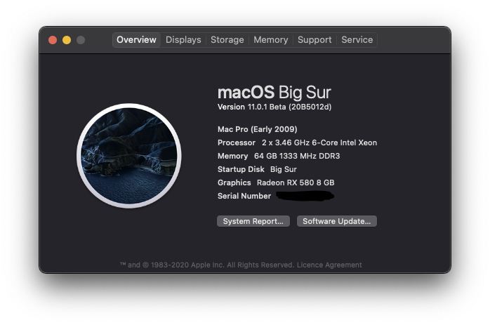

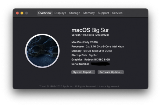

Thanks for the contributions from everyone so far and especially Martin - I finally have this to working with Big Sur Beta 🙂
Plenty more to do with figuring out how to tweak this monster but hopefully getting somewhere with this at last.
