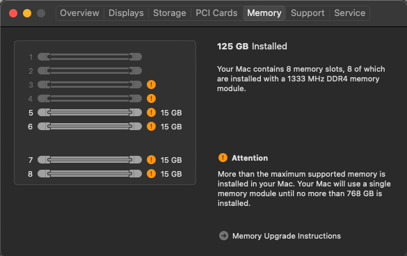

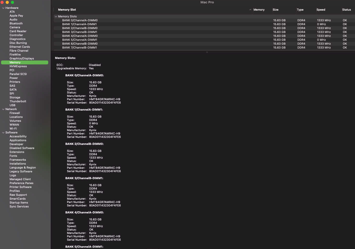

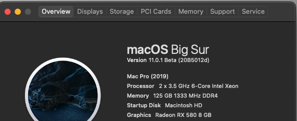

Interesting enough now, I run with 0.6.3...
I have right now 8x4GB which should showed 32GB but according to the screen shoot I run more.. And DDR4 please lol ahahahah..

1,2,3,5,6,7 have 6 slots, but you only installed 4 DIMM, doesn’t match
Euuuh not sure I understand what you meant, the MacPro has 8 slots right.. So right now I have managed to run 128GB filled in this oder 1-3 ; 5-7 it is still 4 slots and 4 DIMMs then when I get the other sticks it will be filled with the remaining which will be 2-4 ; 6-8 .. on the board you still read 1;2;3;4 -- 5;6;7;8 --
Unless I overlooked,
