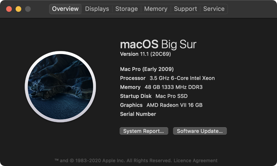

I currently have an MP4,1->5,1 (144.0.0.0.0, 2x5675, 64GB, RX570) booting OC 0.6.3 from an NVMe EFI partition, then into Catalina 15.7 on the same NVMe drive (marked as internal). That's my primary system right now. I need to be able to boot into Big Sur for testing (I don't plan to use it regularly, unless I discover that it contains something indispensable, which seems awfully unlikely). I'm assuming that the Barry K. Nathan micropatcher will work its magic on my system just as it has for many others.
Questions:
  1. For installation, I'm going to remove my NVMe (and all other drives) and do a clean install to a blank SATA SSD. After installation, I'll replace my NVMe (et al) and re-bless OC. Is that sufficient? I know OC will (should) find the bootable Big Sur on the SATA SSD, but do I need to do any OC tweaking for a Big Sur boot? Also, it seems like having OC out of the picture during install should streamline things and reduce possible errors, but is there any compelling reason to include OC in the Big Sur installation process?
  2. On a related note, to make Big Sur work in the above scenario, do I need to upgrade to OC 0.6.4, or will 0.6.3 suffice? (I'm firmly in the "if it ain't broke, don't fix it" camp, which includes upgrades/updates).
My thanks go to everyone working on this, and to anyone who bothered to read this far. ;-)
Interesting that you have OpenCore on the EFI partition of the NVMe drive. I thought that didn't work and was required to be on the EFI partition of a SATA drive. 🤔
Anyway, I can tell you I had no problems with Big Sur and OC 0.6.3 and I even updated to Bug Sur 11.1 with it. But now after I updated to OC 0.6.4 using @h9826790 prepared package I have the problem described here:
Might just be me, though...
Hi all, is it safe to update to 11.1 ?
Very smooth for me, no problem at all.
Reactions: Enricote and zoltm
