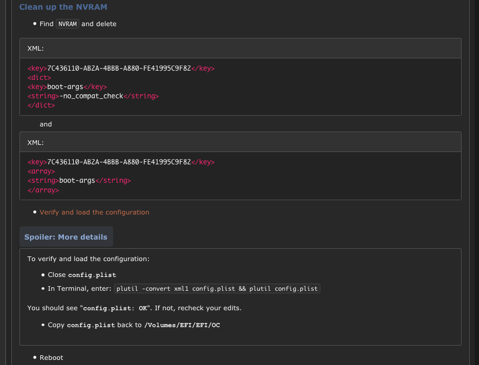

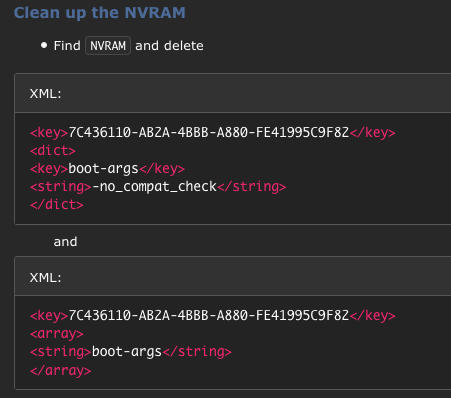

For those that have configure the Hybridzation portion, I could use a second set of eyes on this...

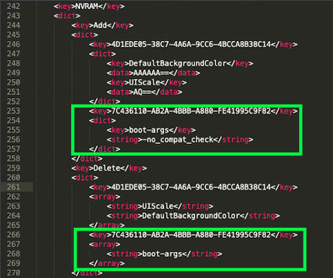

does this seem correct for the "Clean up the NVRAM" ?
I started off with Martin Lo's config.plist, which has more parts/pieces that is described in post#1
So unsure if I need to retain the csr-active-config through run-efi-updater parts or nuke them?
The info in Post#1 shows this:

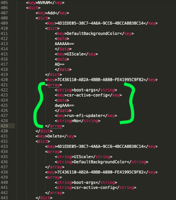

Martin Lo's OC Pkg looks like this (untouched)
So I am unsure if I need to be removing line 405 and then change the tags for line 403 && 404 and nuke lines 406-409 ?? I also reached out to Martin on his youtube video. This is very confusing.

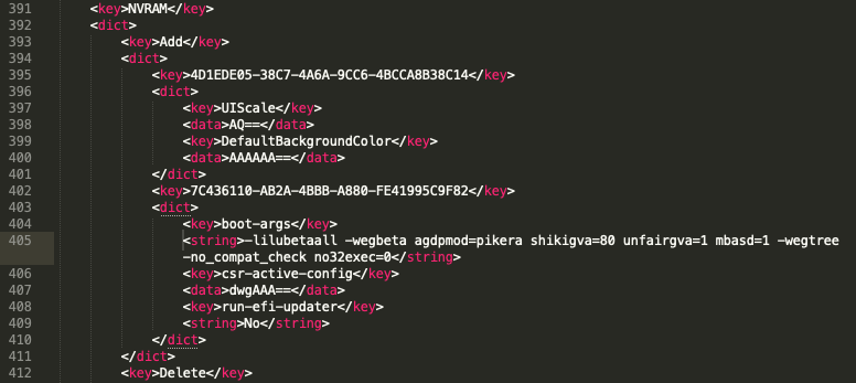

UPDATE: Side Note, Also attempting to enable SIP in this same section, I noticed that trying to disable SIP using the BigSur Recovery Partition DOES NOT work. I'll need to get my OEM GPU back in and either boot from a USB installer or see if my vanilla Mojave recovery will allow SIP to be disabled, then I can reattempt this.
Martin's package is like a Swiss army knife. It contains almost everything you'll ever need. On the other hand, the approach in the guide here strives for minimality.
If you want to use SIP as intended by macOS, then you should not be setting csr-active-config in OpenCore. Also, run-efi-updater does not work in Big Sur.
If you've already done the hybridization as described in the guide, then you can go ahead and delete the key and corresponding dictionary block in the Add section and delete the key and corresponding array in the Delete section.

If you've opted for the hands-on approach described in the guide, then I would recommend building your configuration from the sample file provided in the guide.
That's because you've enabled SIP in OpenCore. That setting takes precedence.

Per your comments, I need a little more clarification:
The very next section after Hybridization says to keep the key [Post#1 - Clean up the NVRAM]
You are now say to delete the key/dict in the Add and Delete sections. Would you be able to modify the Post#1 to match what you are suggesting?
As for SIP, I am wanting to have OC manage this, so I will need to boot into recovery with mojave and disable it, then reboot. Once that is complete, I will need to update OC config.plist with:
where dwgAAA = OFF and AAAAAA = ON (per Martin's instruction)
....but you just mentioned to Delete the Key/Dict for NVRAM.
Maybe I am mixing 2 things up here?
Martin Lo's implementation doesn't cover Hybridization.... So if you elect to use Hybridization, then you cannot delete the NVRAM key/dict from the Add/Delete sections? Or am I incorrect on this?

Yes, you are. Unless you already have a good understanding of how to configure OpenCore, you should not try to adapt the configuration from Martin's package by following the guide here. Martin's package is intended for users that want all the features without being bothered by the details of the configuration process and don't mind running with settings that are really intended for debugging, such as boot arguments and SIP override.
It does. Everything is already set up in the most generic way possible.
What I am saying is consistent with the guide: "Find NVRAM and delete..."

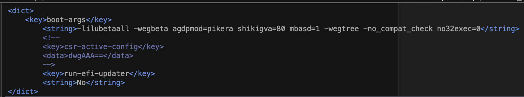

You don't have to delete keys when experimenting with config.plist, you can comment out lines...
e.g. like this:
<key>csr-active-config</key>
<data>dwgAAA==</data>
This makes my SIP work normal
"Added support for xml comments in plist files" from OpenCore 0.6.3.

I do apologize.... After re-reading for the 4th time, I see the error of my mistake.
I was stuck in a path from the previous step of "Change THIS TO THAT", when this step wants 2 parts removed.
Remove THIS and THAT (The boxes below).
Couple more question on this...
  • Is the "Clean up NVRAM" instruction part of the Hybridization and Related settings" ?
  • What is the purpose of removing these two sections?

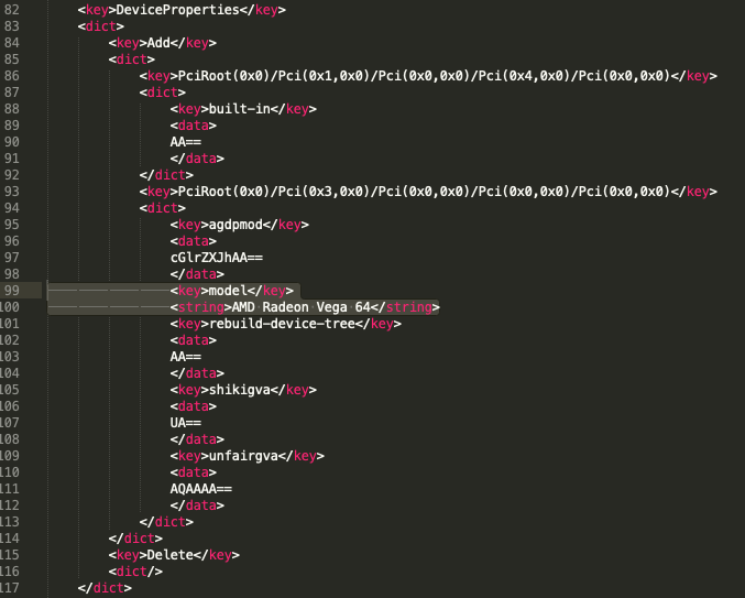

Another item.... This refers to the cosmetic issue some have experienced with Vega 64's showing as NA in VideoProc
I have the following set:
Set the key/string for model and name
Is there a specific number of words that are allowed for the string? 3 vs 4?
AMD Radeon Vega 64 ?
AMD Vega 64 ?
Or is placement of these 2 lines critial withing the dictionary?
And made sure DeviceProperties was enabled
Rebooted...
But still getting:

I suppose that cleaning up the NVRAM is part of the "Related settings," but it's not a functional requirement for hybridization; it's a recommendation that is consistent with how OpenCore and other Acidanthera projects are designed so that boot arguments are for temporary configurations.

....then I unsure how/why I am not getting the prepended "AMD" to display on my graphics card.
I'll revert the changes I mentioned for this issue and chalk it up as an "unknown" issue for now.... especially since it is purely cosmetic at this point.
Should someone else have any possible solutions to this in the future I will revisit the issue.
