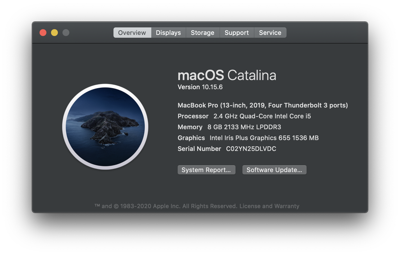

Had sort of the same problem just now actually I was dumbfounded because of what happened. In my case, I was rendering a 7-minute lyric video I made using after effects (mostly text and a JPEG with a turbulent displacement effect) with about 90% battery life. Been rendering for about 30 mins to an hour (the fan was almost on full power bc of the render so it was loud at this point). I checked my percentage after rendering and it was at 10%. I understand that the render is the main culprit but from 90-10 in less than an hour? Is that normal? For my 4 month old 13" MacBook Pro 2019. Was brand new when I bought it. 😞

Sounds normal, not actual numbers but, you can use 10W and go for 10 hours, or use 100W and go for just 1 hour
