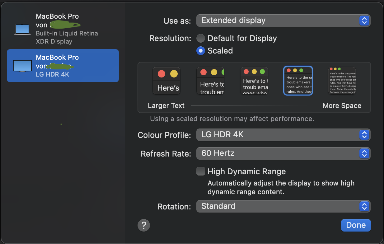

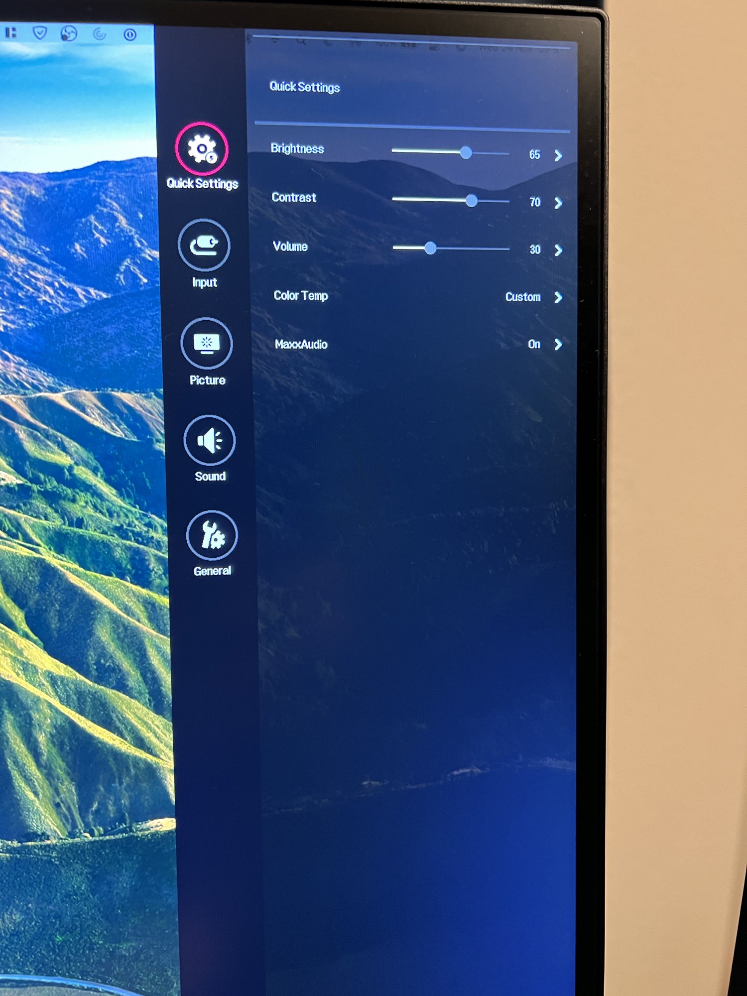

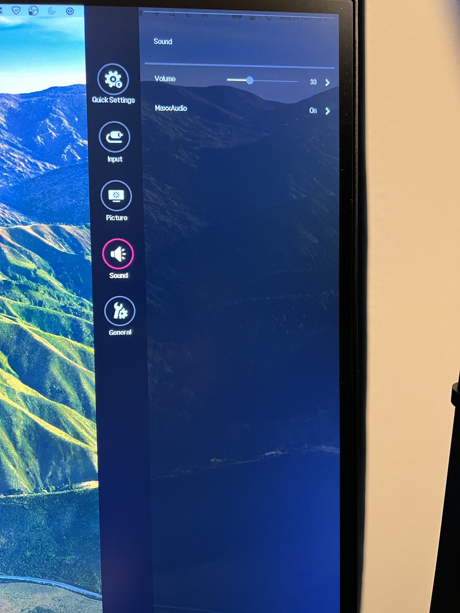

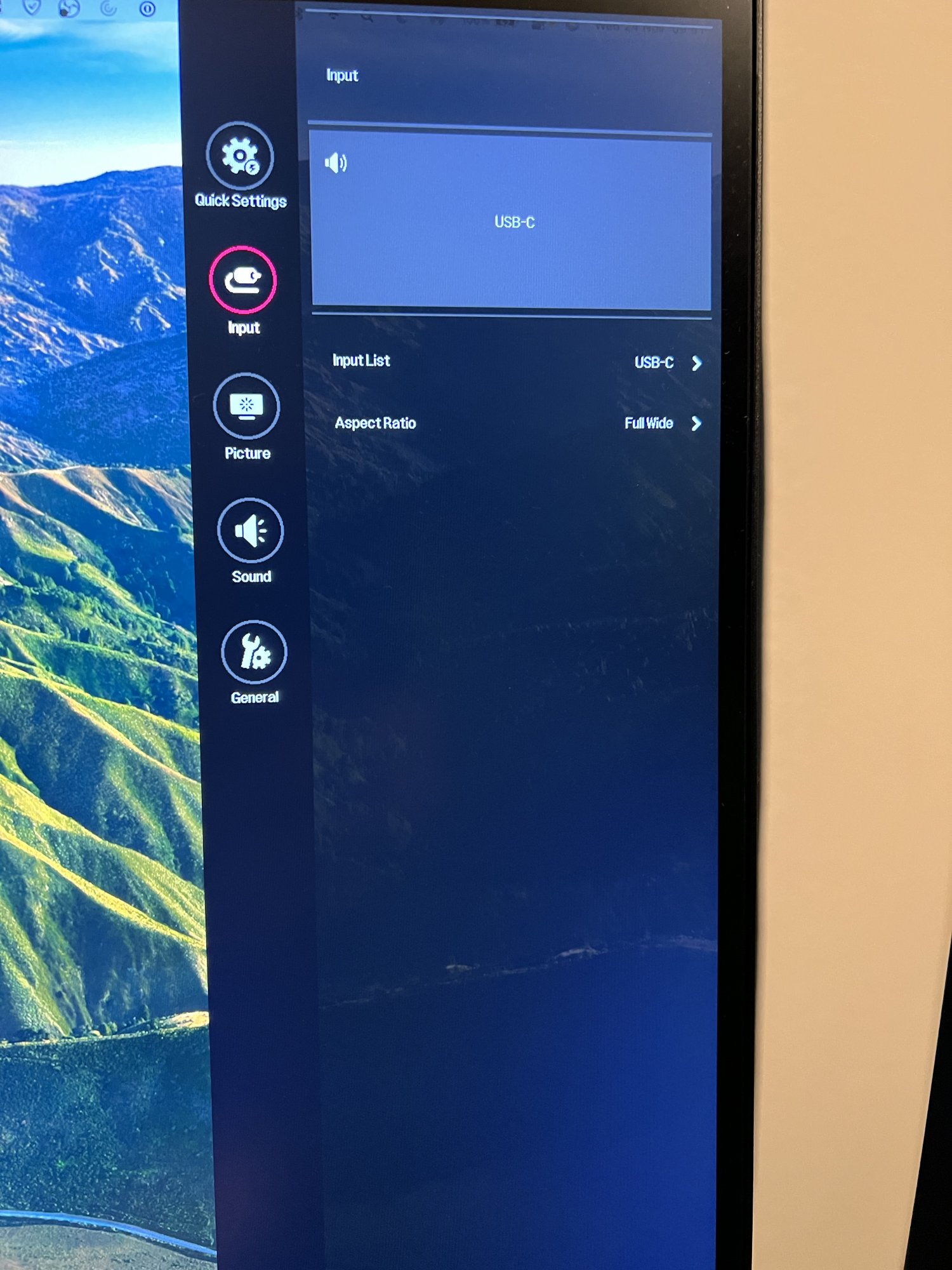

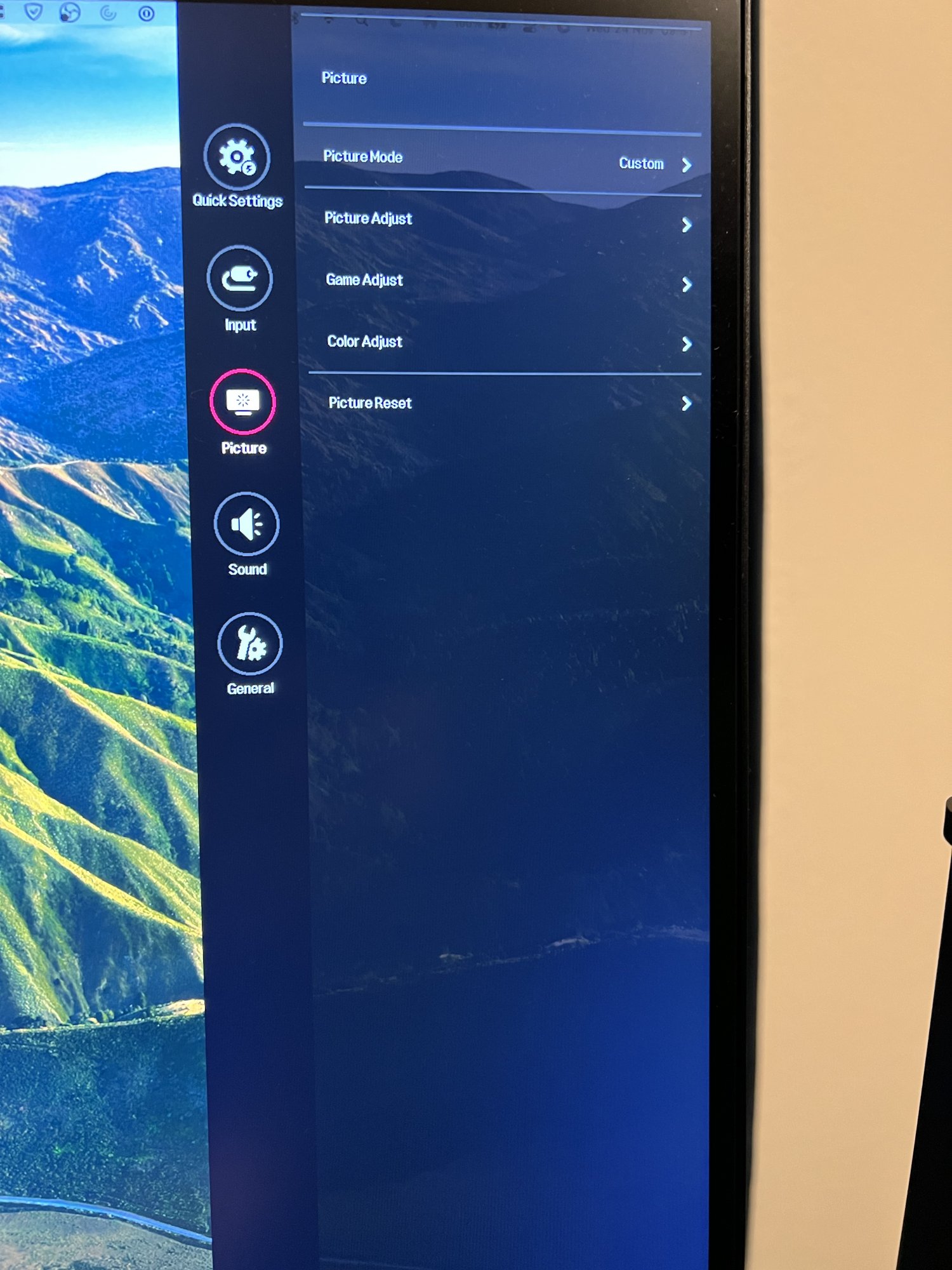

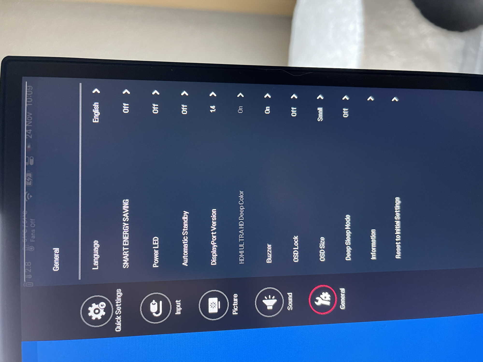

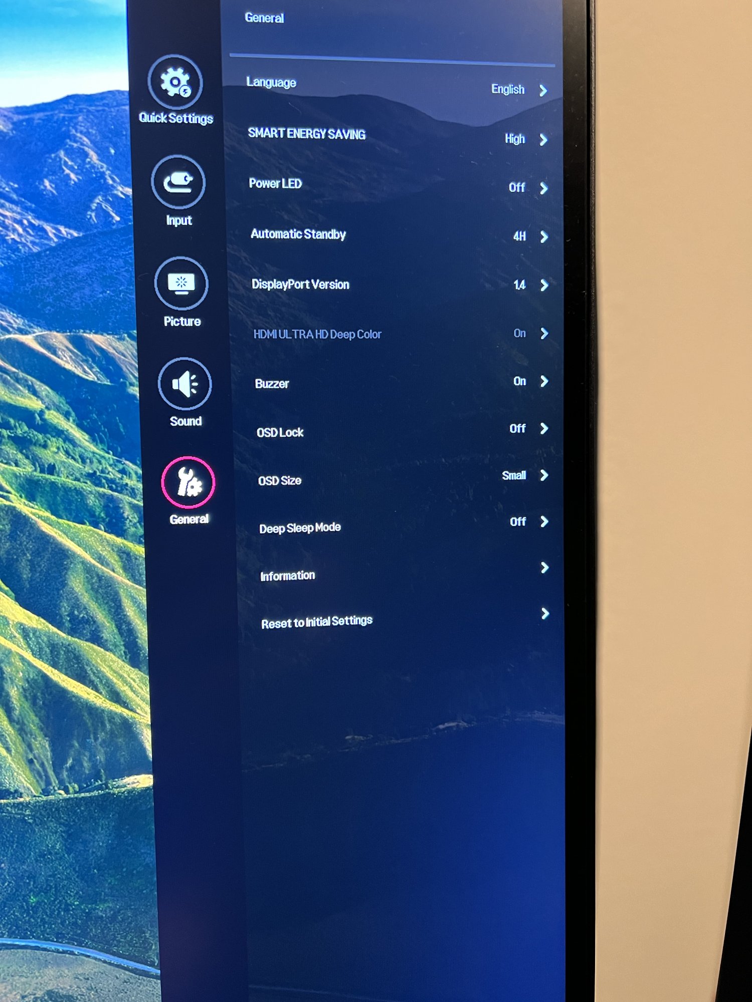

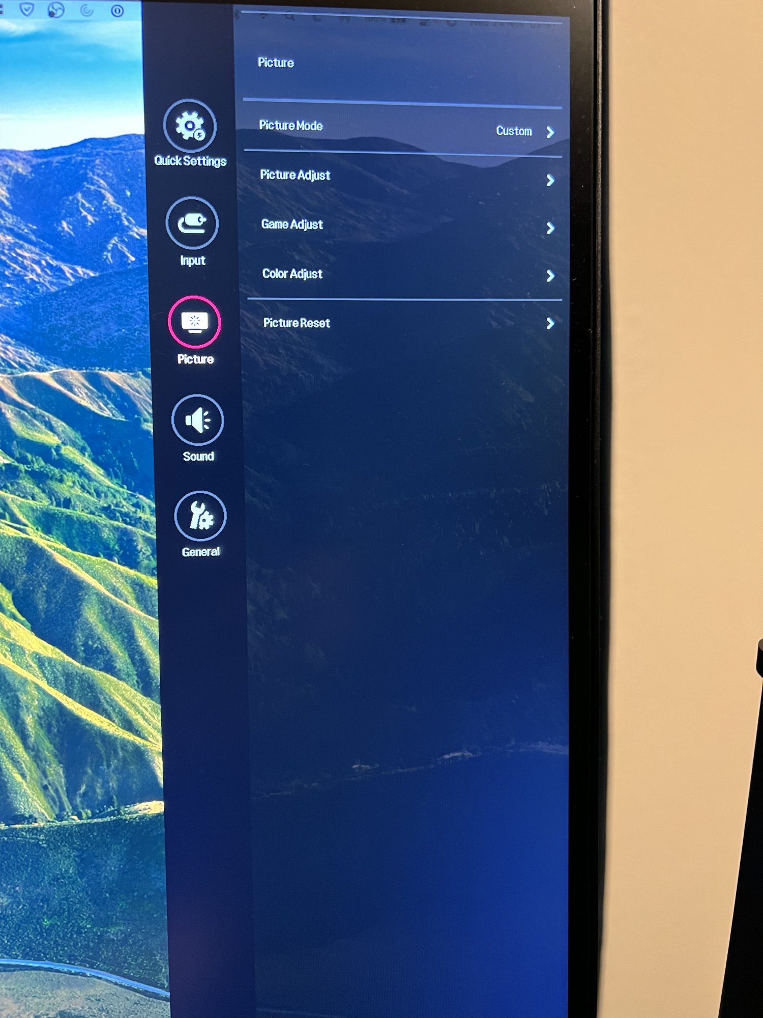

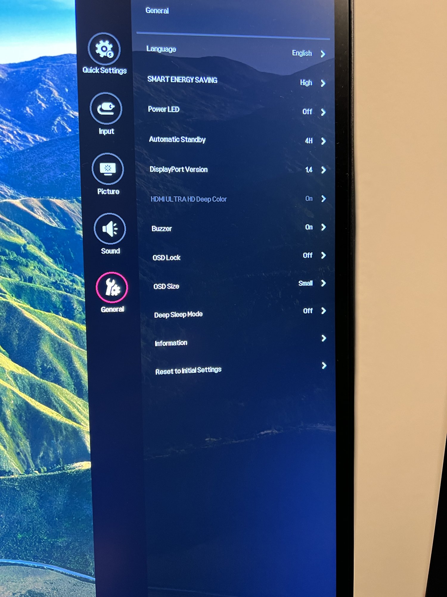

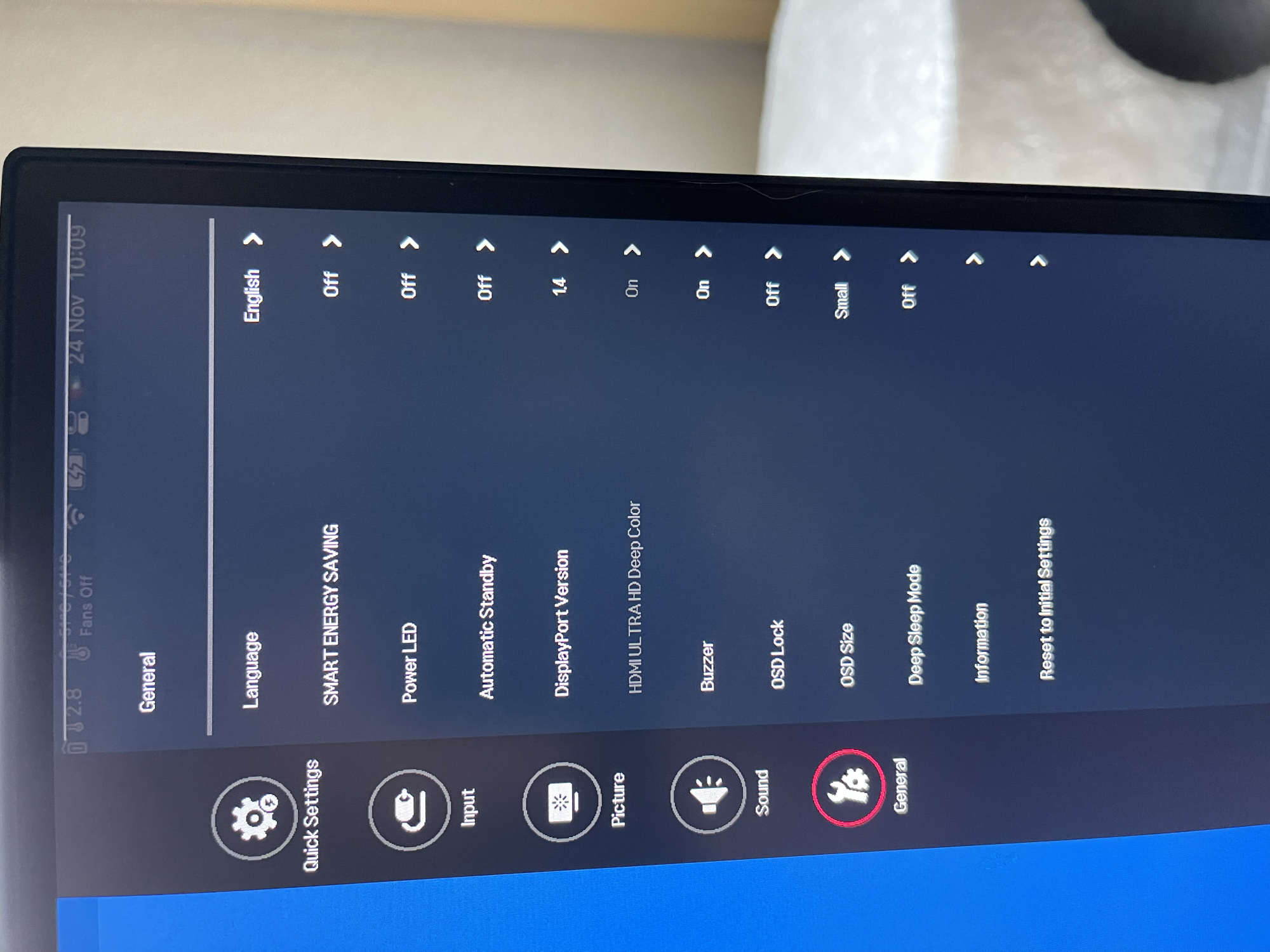

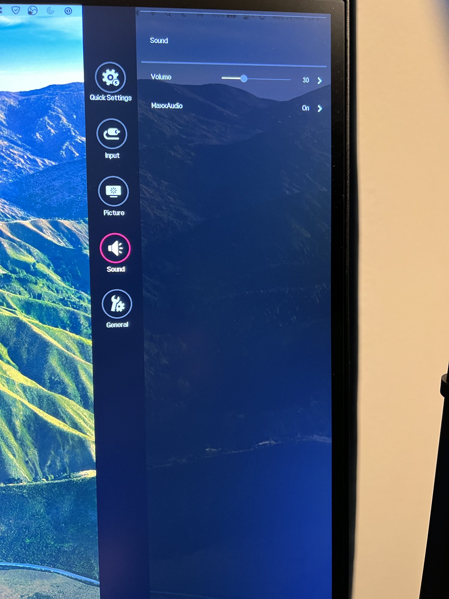

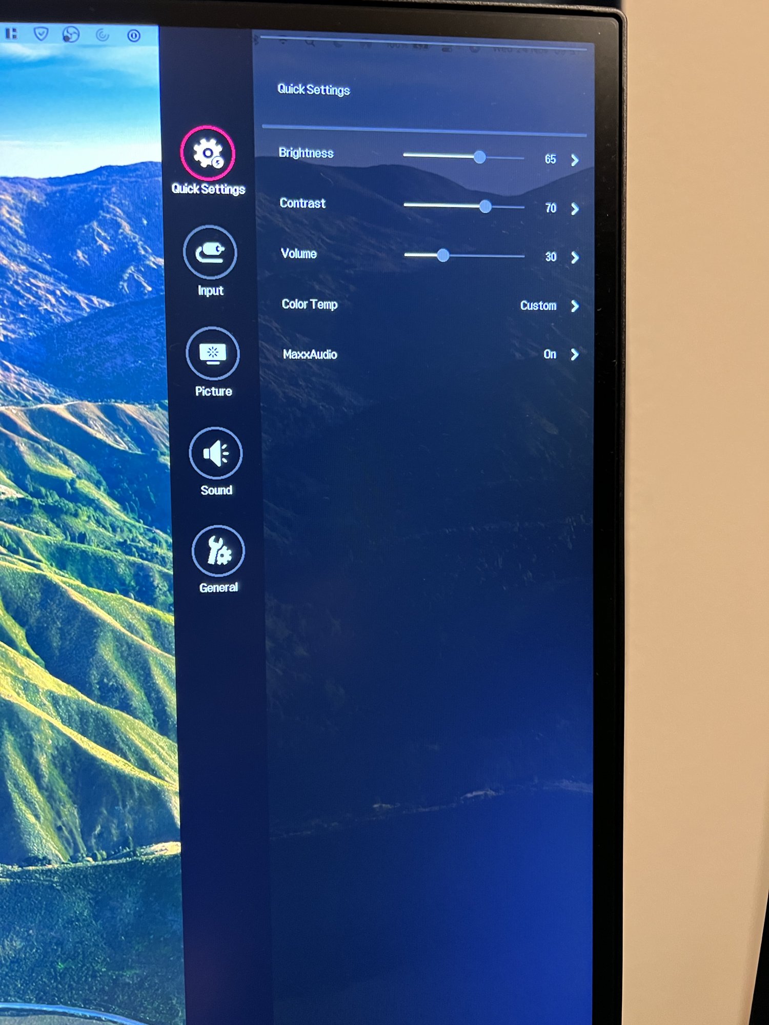

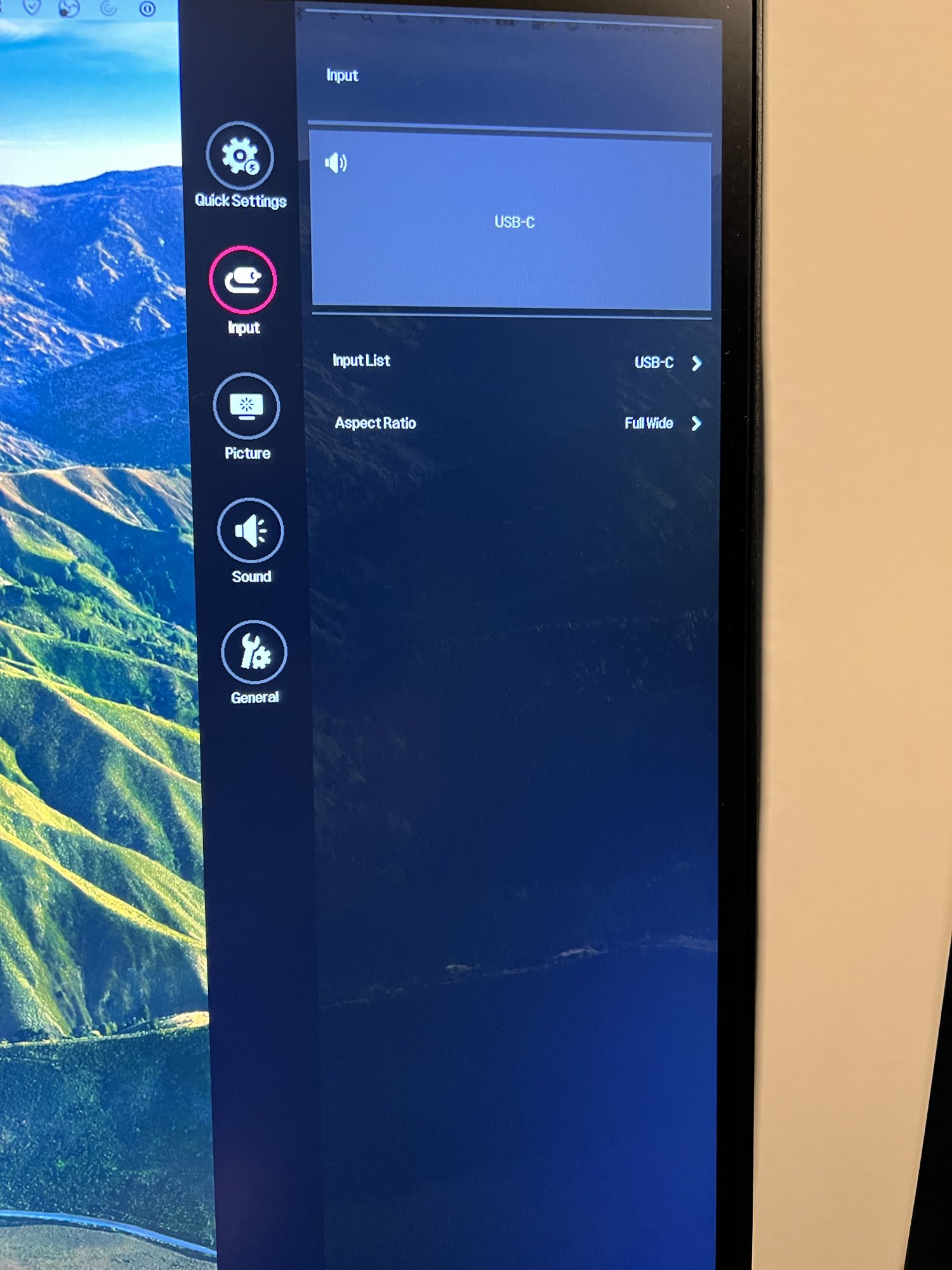

Strange, I am using the same screen on the same machine and I never have it wake up. Would you mind sharing the settings on your screen. I can then compare them to mine and tell you the difference.

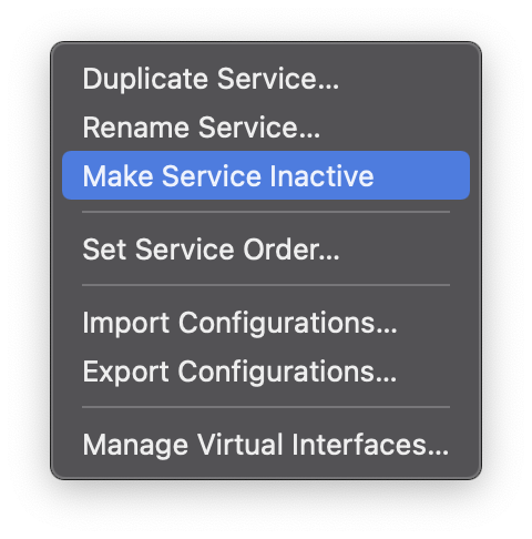

I have been plagued by the same problem with my LG 34WK95U display. It's only been a couple of hours since I think I found a solution, so caveat emptor. With this out of the way, here goes:
1. In System Preferences -> Network, note how the display exposes a "USB modem" to macOS.
2. Inactivate it, using the context menu at the bottom of the list.
3. Click "Apply"
I'll follow up here re: whether this fix actually works long-term, but I wanted to share this idea early so that more people can give it a try, too.
