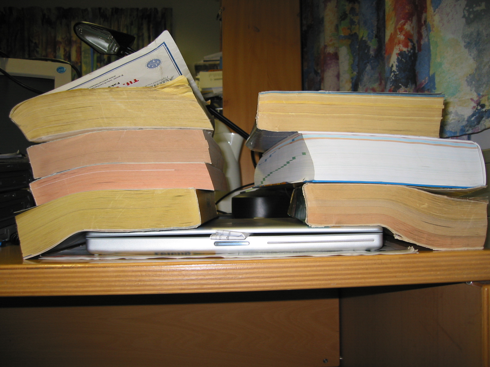

here is how i fixed the gap problem on my AlBook some years ago, i will add that this laptop runs jut fine to this day.

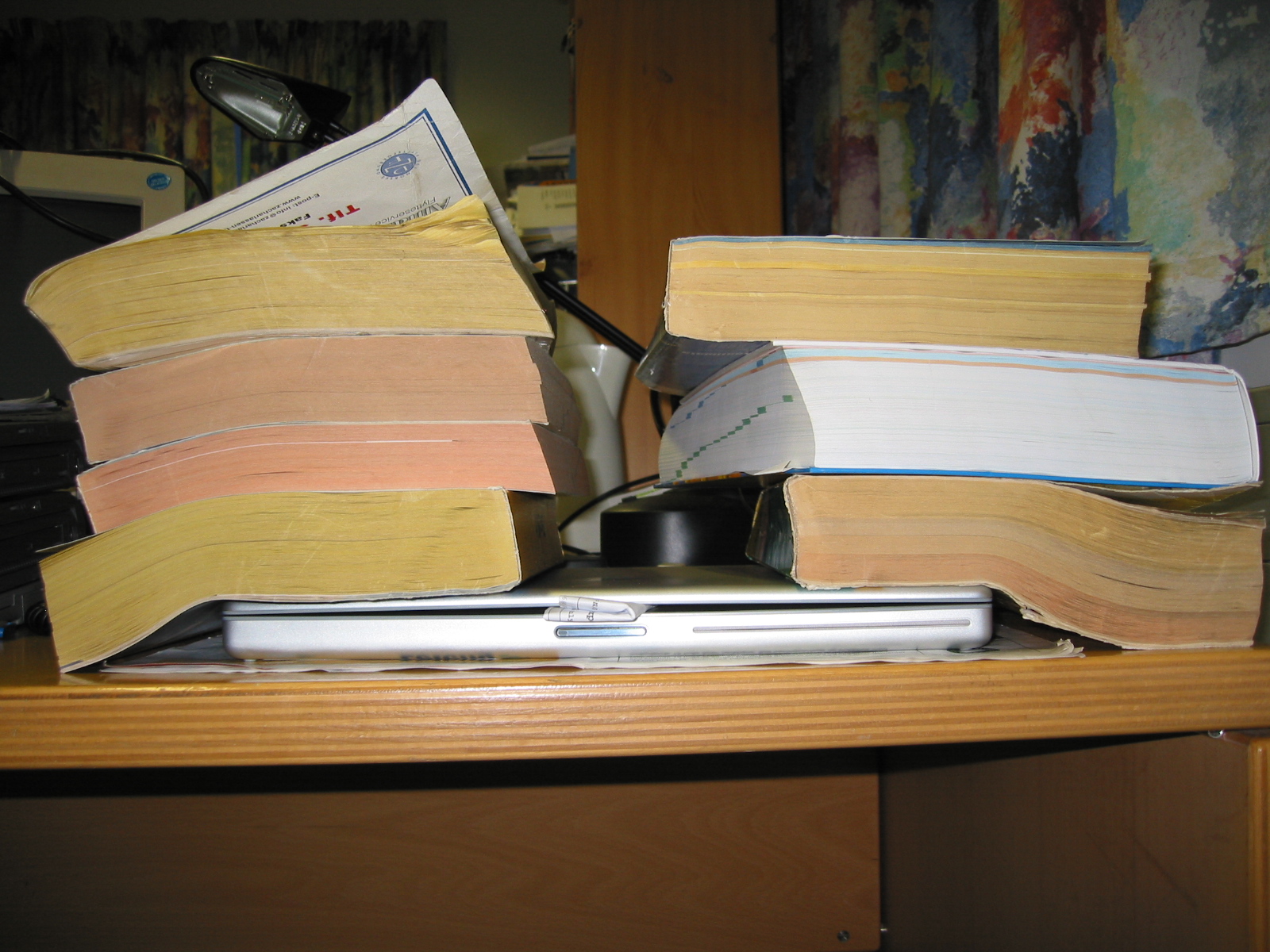

Hahahaha! That's the best thing I've seen all day.
Does this really work? Is it a permanent fix or do you have to do it every so often? How long should you keep the weight on before removing everything? Just curious, seems worth trying.😛
it did help at the time, i didn't really check lately as it's my little brother who owns it now. my 2.16 C2D MBPro sits flush so i didn't have to try my method on it 😀 if you wanna try, just leave it as long as needed, aluminum is a soft metal so be careful.

I could be wrong, but wouldn't it be slightly safer to only put the weight on the very edges of the screen (the 3/4" or so of the frame)? Otherwise there is no support to keep the screen from bending too far in places and possibly making contact with the keyboard, depending on how the weight is distributed on top.
you're probably right and i officially deny any responsibility in case of damage due to the use of this technic to adjust the gap 😀
