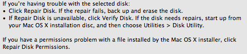

I put my Home directory on the 1TB in my HDD bay and I have OS X on my SSD in the optibay. Disk Utility will only let you repair permissions on a drive with OS X installed.
How can I repair permissions on my home directory?
Think that sums it up.
To use your repair disk use either a disk image or a remote disk utility.
Details of how to do the latter are linked below...
how-to-really-enable-dvd-drive-sharing-on-a-non-air-macbook
The button for "repair disk permissions" is grayed out because OS X is not installed on my HDD. I have another user account set up that has its home directory on my SSD, so when i log into that one, i am able to "repair disk" on my hard drive because it can be unmounted, but i still can't repair disk permissions.
