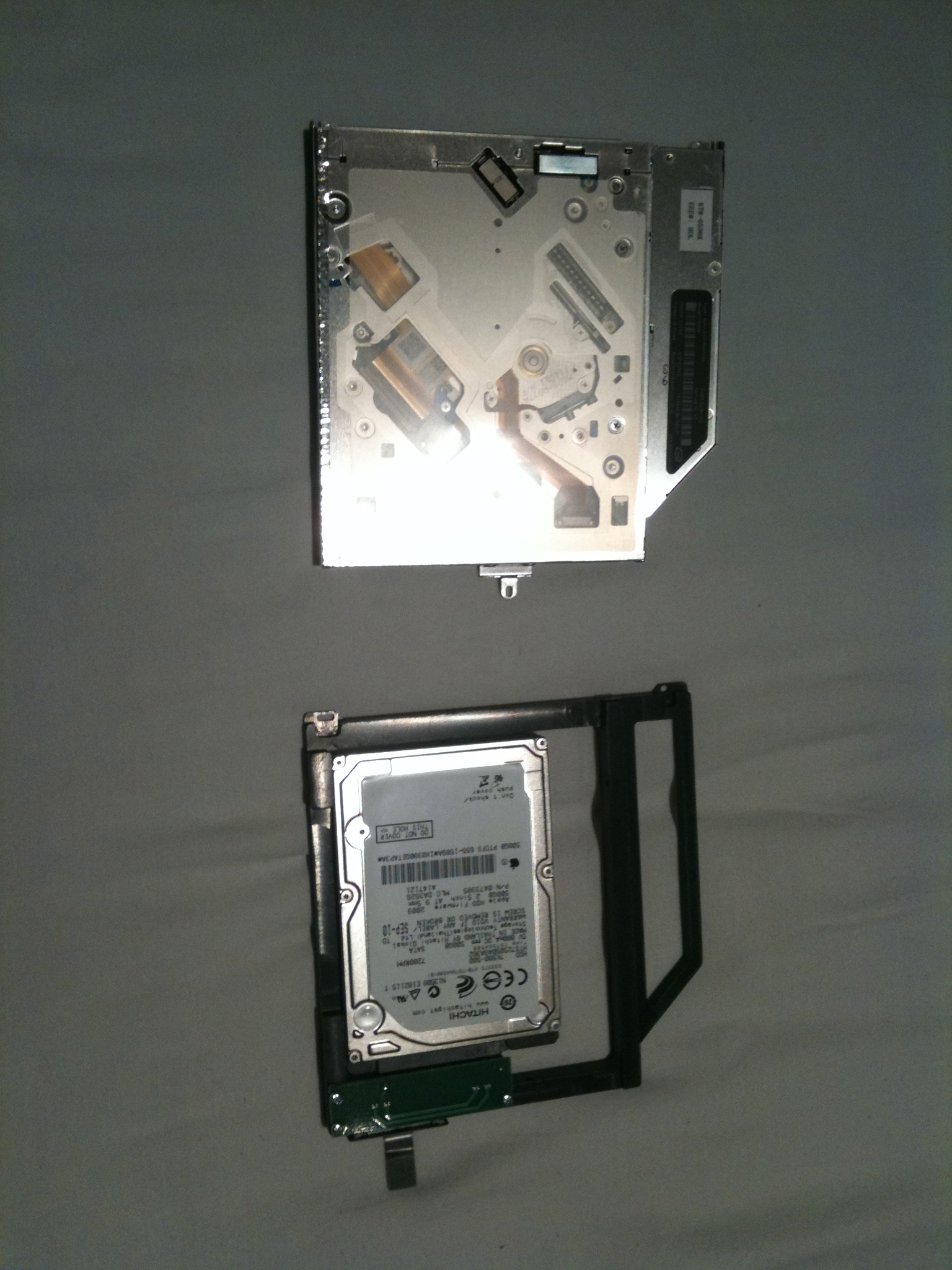

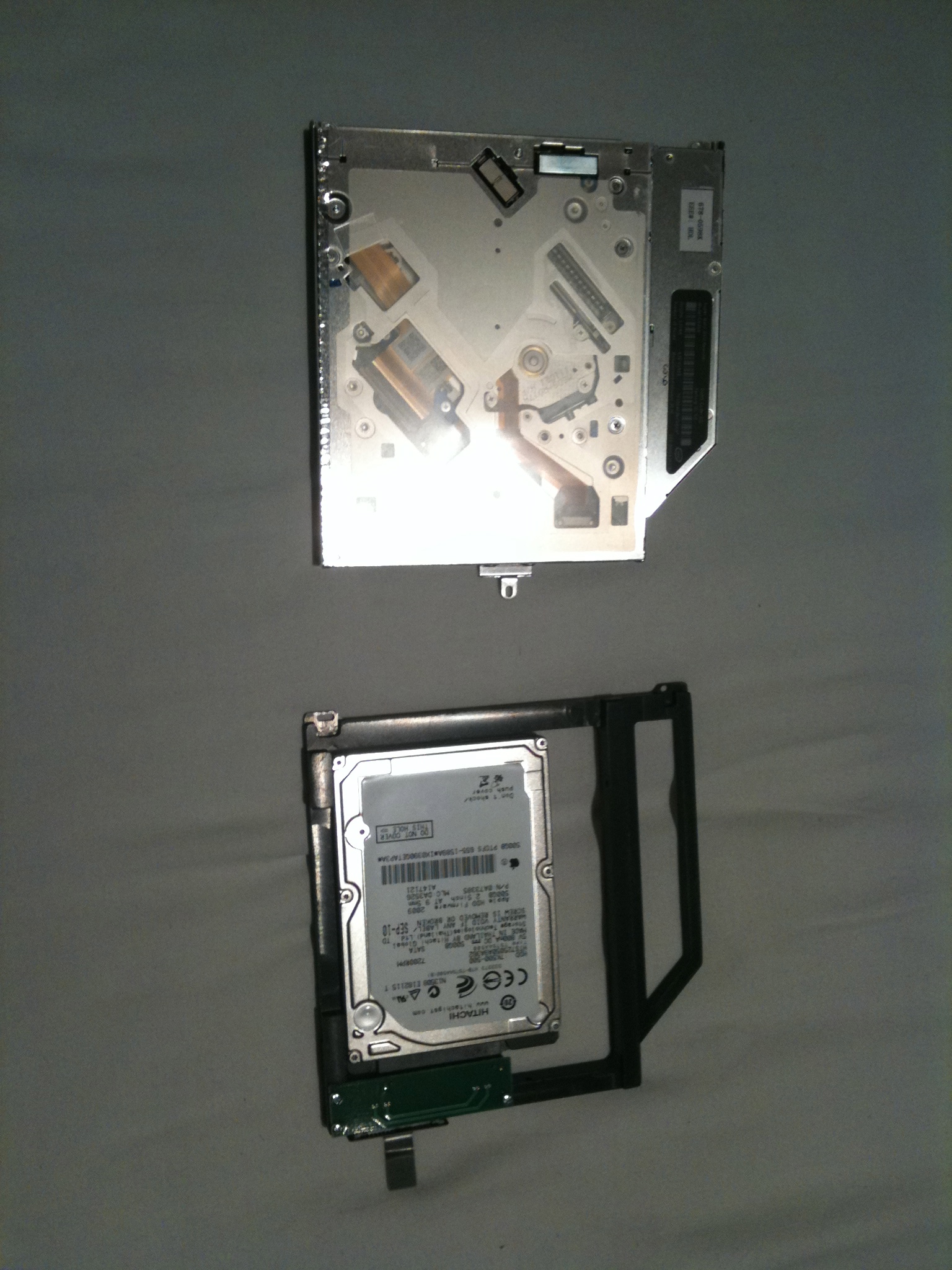

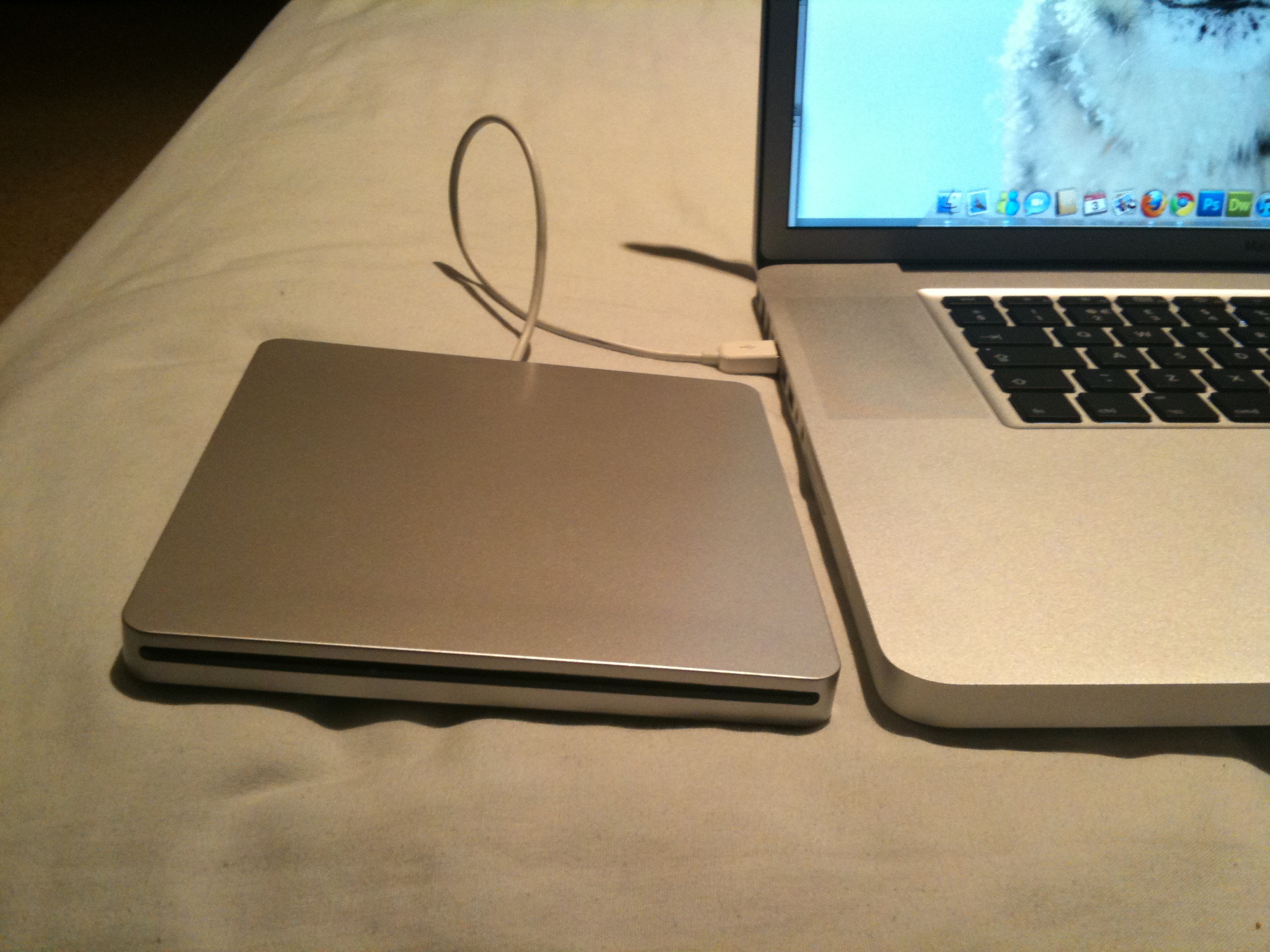

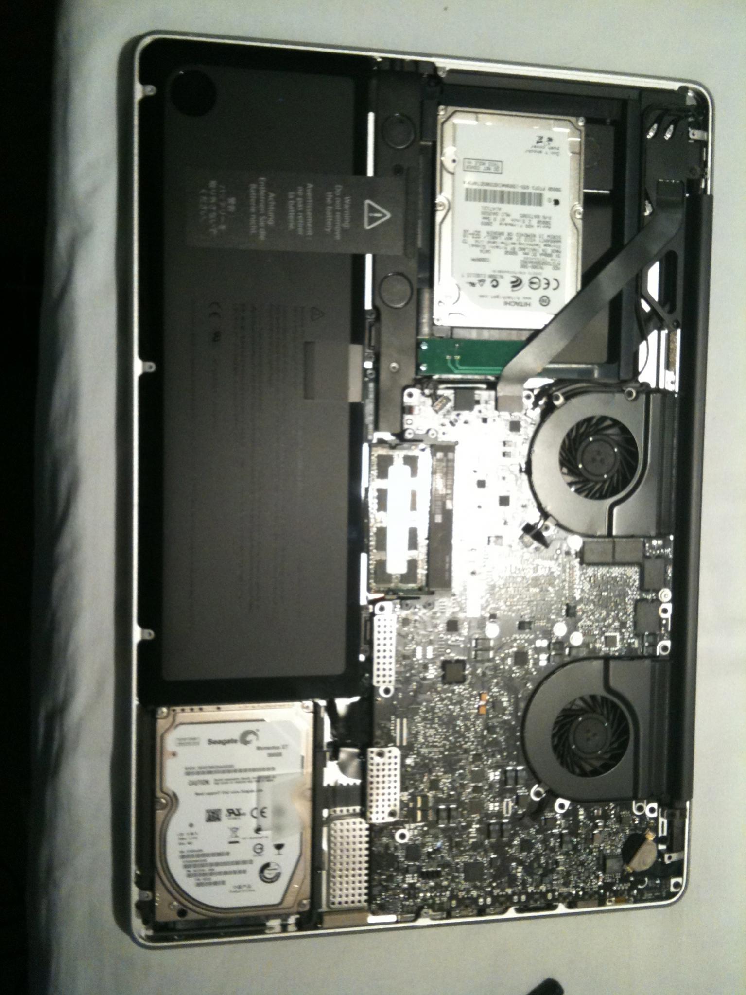

Not sure if any one has posted this but Maxupgrades.com do an excellent cheap alternative, here's a pik of mine that I did my self 2 weeks ago .. it took me about 30mins to do as I was being extra careful, You get all the tools you need but no instructions..I followed the iFixit guide and it worked perfectly...
