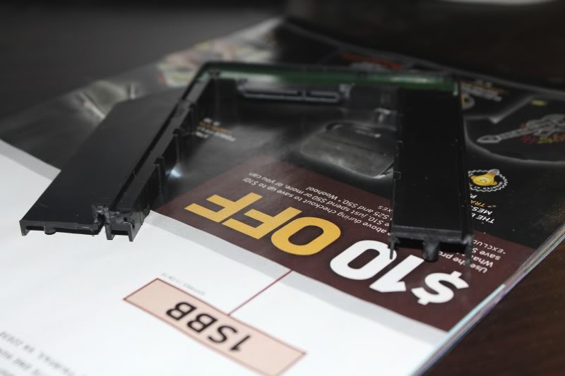

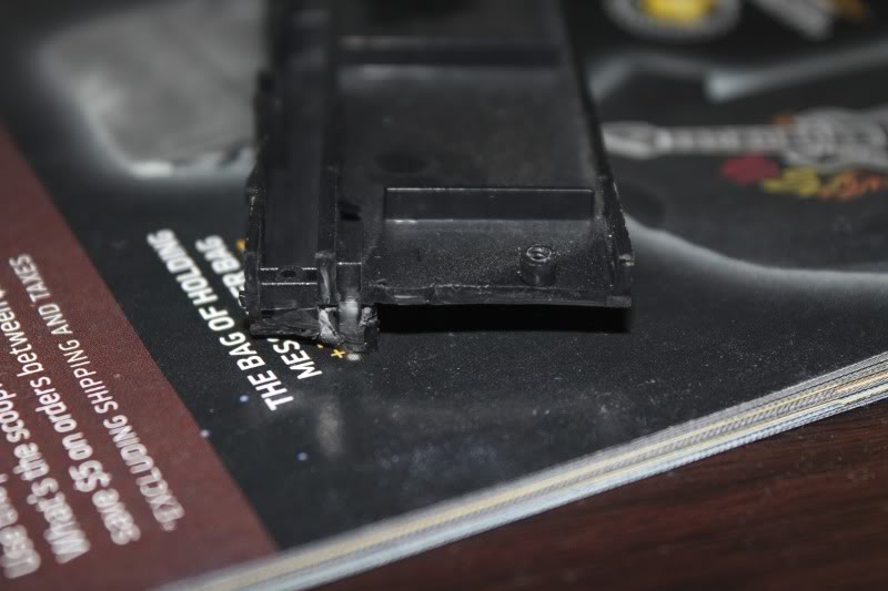

This is from one of mine.
*note* I trimmed it roughly, you can take more time but i didn't bother as no one will see it when installed. I also removed the metal covers because they are purely cosmetic.
