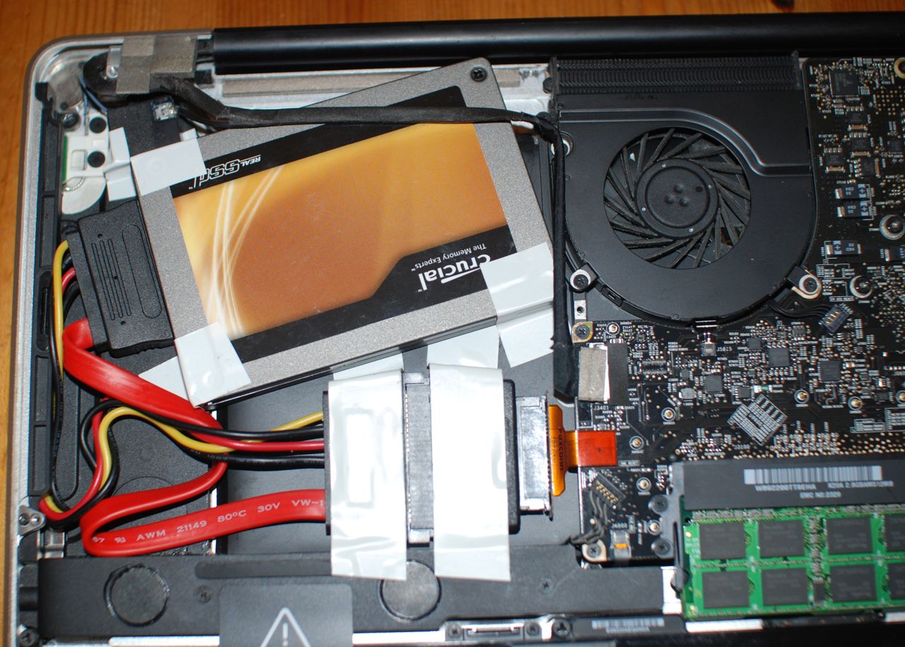

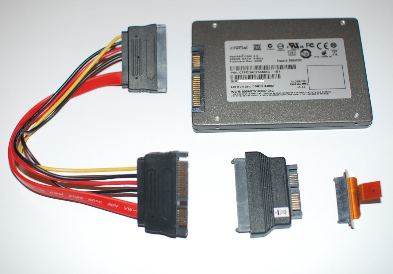

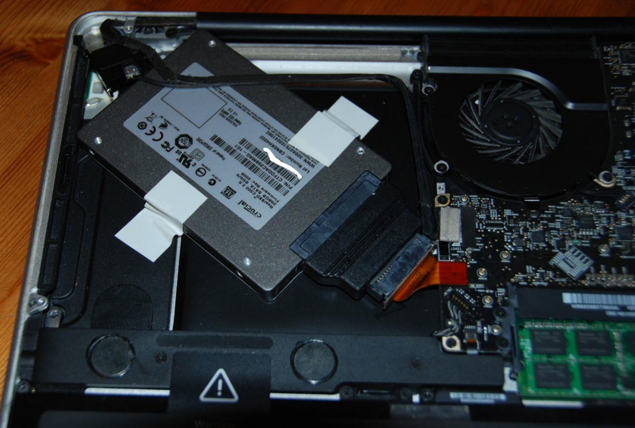

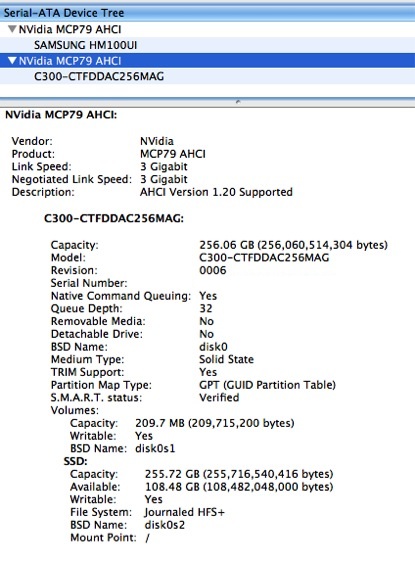

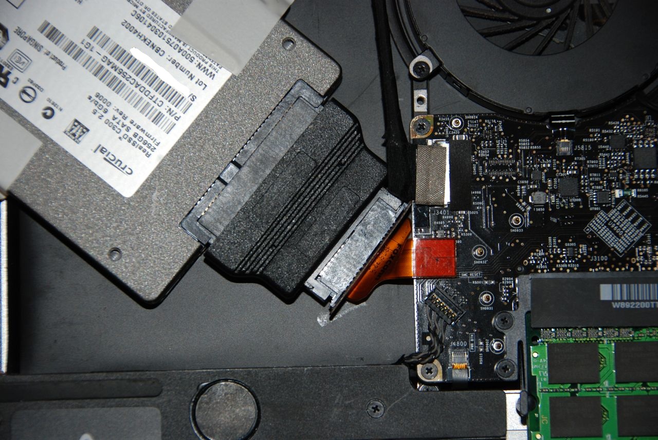

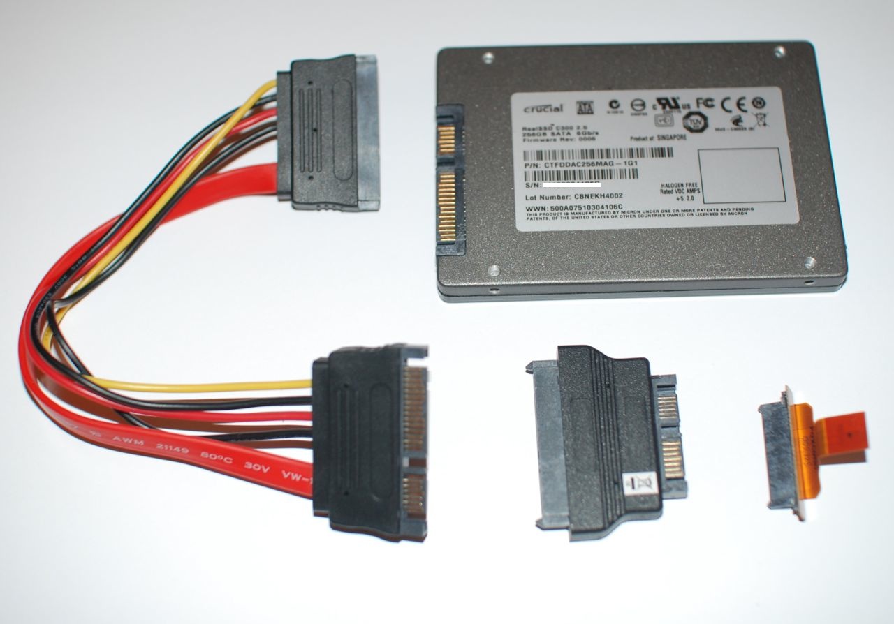

I just installed a Crucial C300 in my unibody MacBook Pro. After trying various combinations, I've ended up using a simple adapter in the superdrive slot.
Method 1

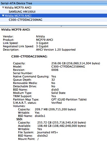

Cheap disk caddy off ebay. This cheap 'n cheerful caddy fitted perfectly in the superdrive bay, but unfotunately the nVidia SATA controller only reported a 1.5Gbps negotiated link speed. The neatest option, but not the fastest. Must be the cheapo caddy causing the link speed to drop, I thought. Time to try an alternative.
Method 2
Motherboard connector > 13 pin to 22 pin SATA adapter > cable > SSD.
Alas this also only reported 1.5Gbps negotiated link speed. Hmmmph. How about removing the ribbon cable in between the adapter and the SSD?
Method 3

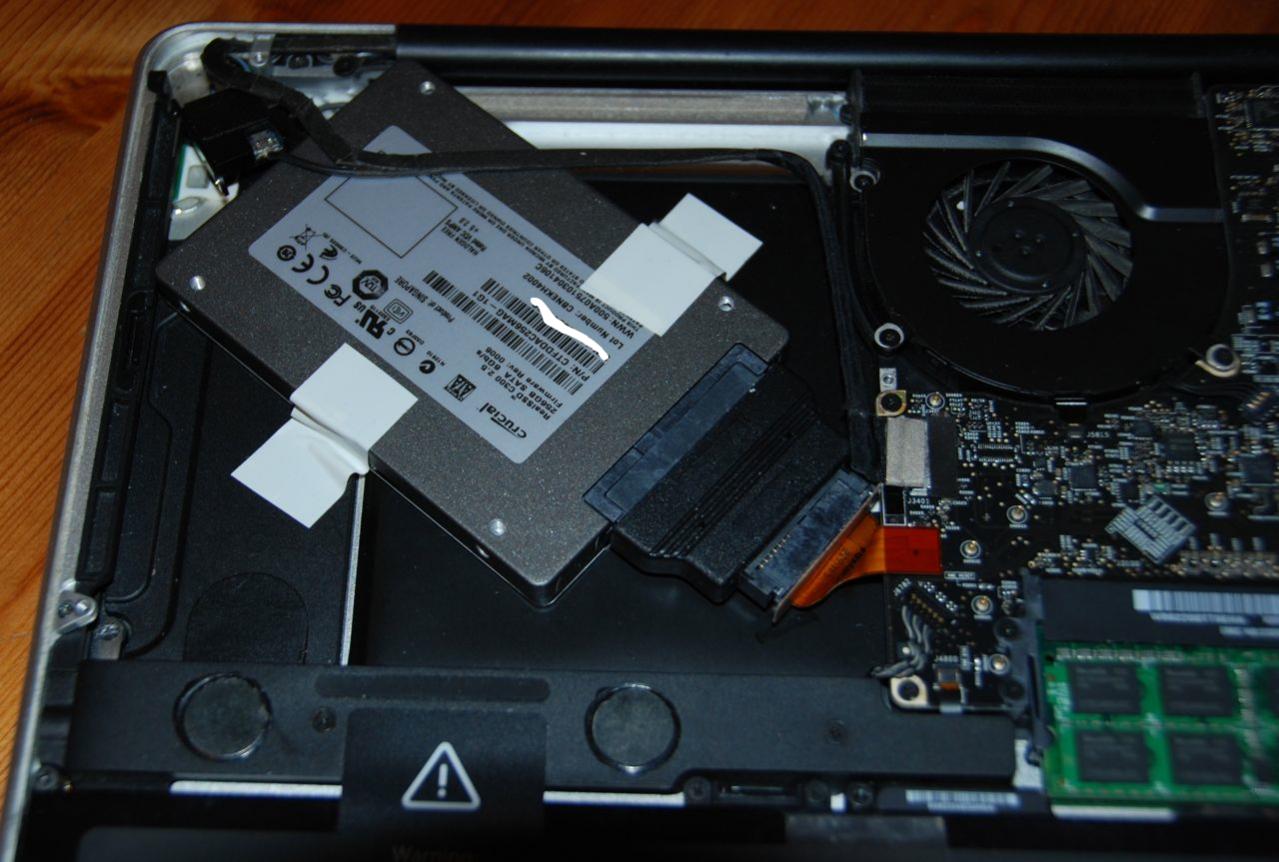

Motherboard connector > 13 pin to 22 pin SATA adapter > SSD.
The only issue with this is the kink in the motherboard connector. A bit of tape was required to stop the mobo connector pulling away from the adapter.
So for anyone thinking of doing this, you can do it with a £5 adapter 🙂

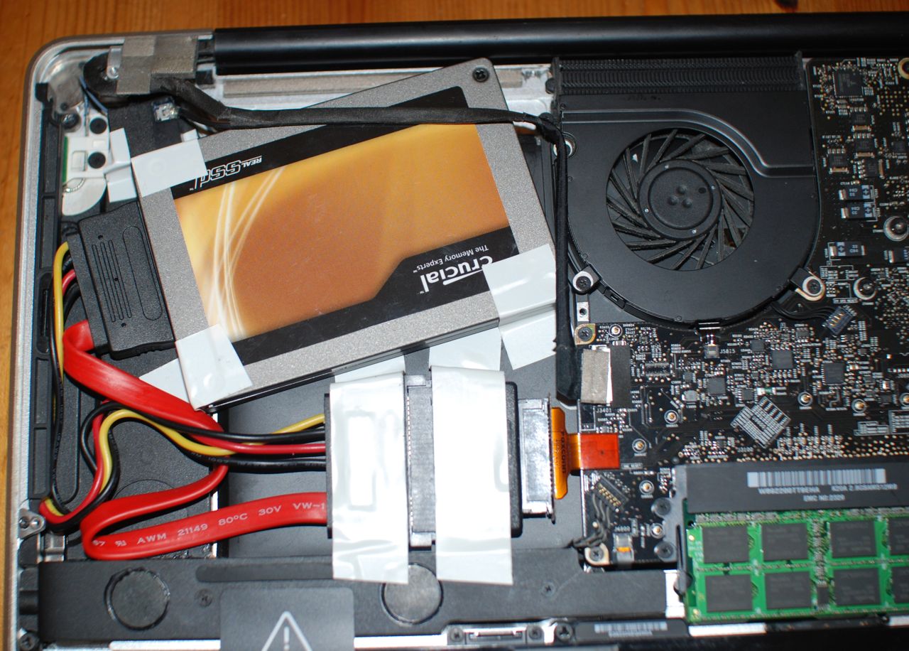

Method 1
Method 2
View attachment 281572View attachment 281560

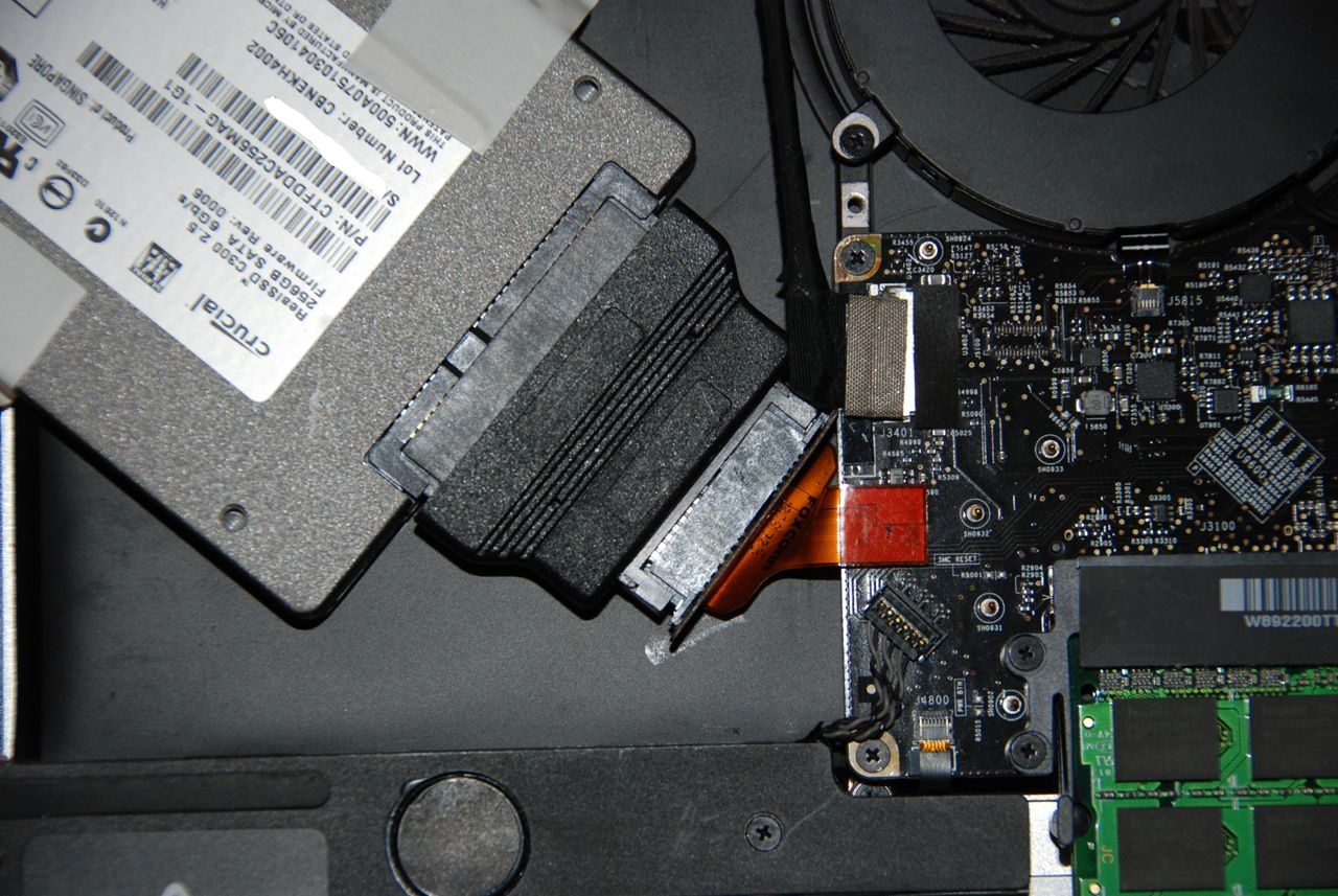

Method 3
View attachment 281573View attachment 281574
I put a 1TB mechanical drive in the regular hdd bay. It's thicker than the original drive, but it fits fine.
😱 Holy god. Two thoughts... First, don't you worry that the SATA connection to the logic board is going to come undone? Secondly, I guess whatever works.
I can't decide if it's brilliant or madness. I'm leaning towards madness though....
That did cross my mind 😛 However it's been fine so far (2 weeks or so). Apple kit is built take abuse 🙂
I bought the $25 IDENTICAL adapter, then spent another $30 on a used macbook air external superdrive, bought an unlocked USB to SATA adapter for $6, popped open the external superdrive and soldered in the new board. Now it works on any computer, mac or PC, is powered off a single USB port, plays DVD's without any extra software, and matches my macbook perfectly. It's also very solidly built, and as an additional plus, the macbook's superdrive sits safely tucked away in a box, while the less expensive 12.5mm drive in the external superdrive gets tossed around in my laptop bag. With a little automator and key remap software (about 10 minutes of work) you can even get the eject key to spit out the disk. It's also bootable, I really consider it the perfect DVD companion to the macbook.
