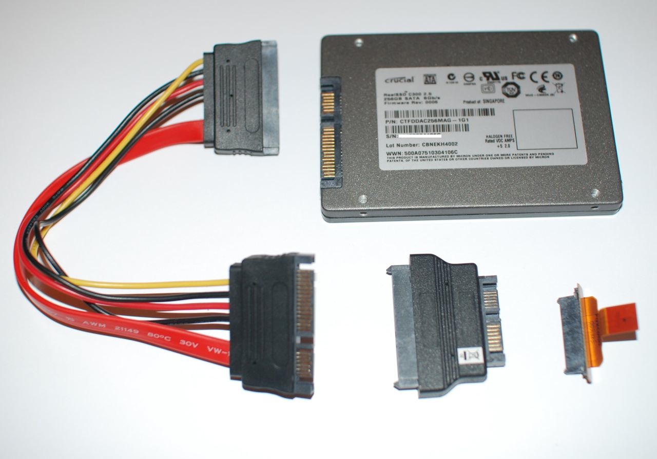

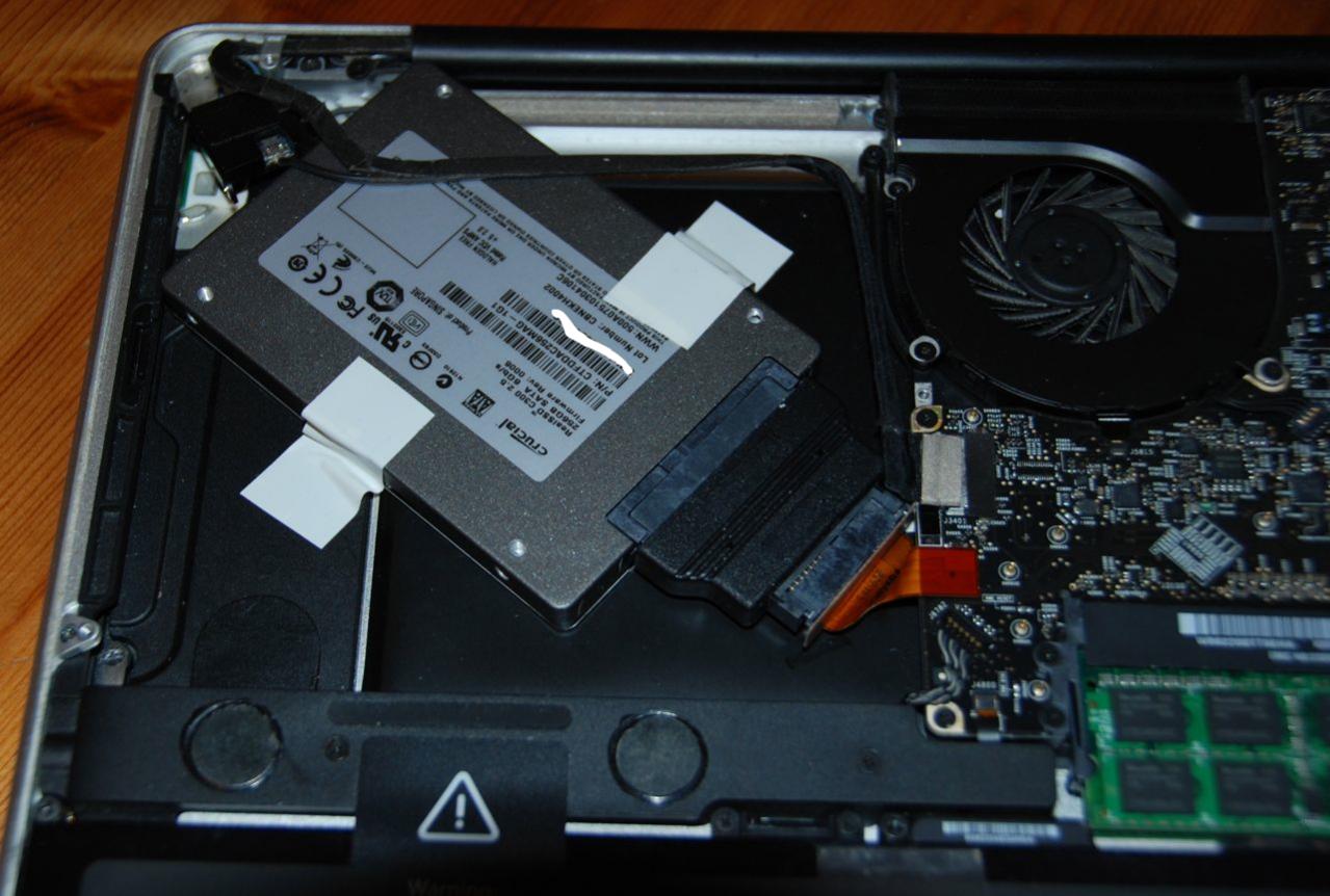

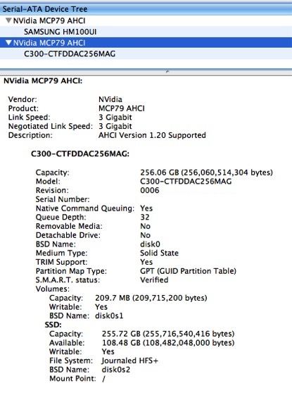

I just installed a Crucial C300 in my unibody MacBook Pro. After trying various combinations, I've ended up using a simple adapter in the superdrive slot.
Method 1
Cheap disk caddy off ebay. This cheap 'n cheerful caddy fitted perfectly in the superdrive bay, but unfotunately the nVidia SATA controller only reported a 1.5Gbps negotiated link speed. The neatest option, but not the fastest. Must be the cheapo caddy causing the link speed to drop, I thought. Time to try an alternative.
Method 2
Motherboard connector > 13 pin to 22 pin SATA adapter > cable > SSD.

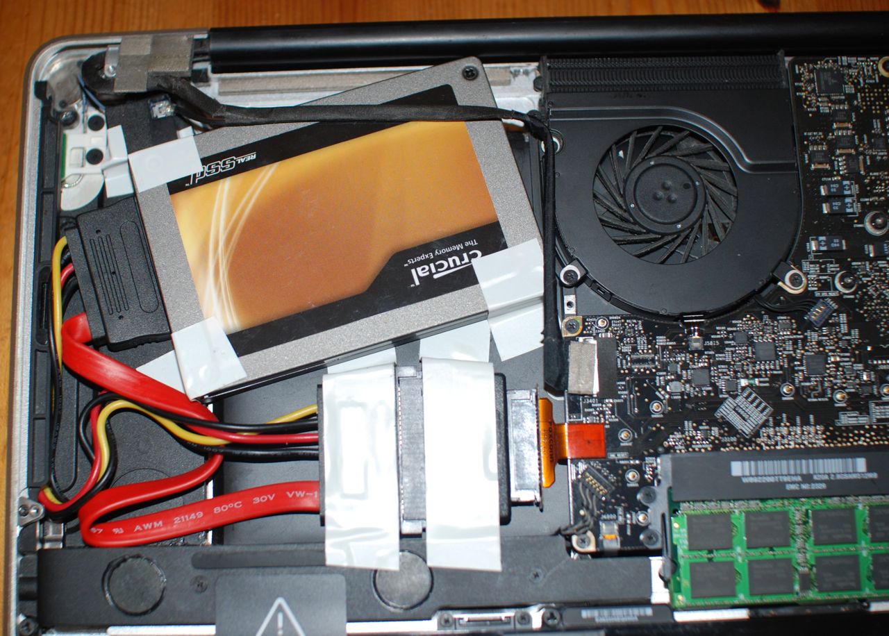

View attachment 281572View attachment 281560
Alas this also only reported 1.5Gbps negotiated link speed. Hmmmph. How about removing the ribbon cable in between the adapter and the SSD?

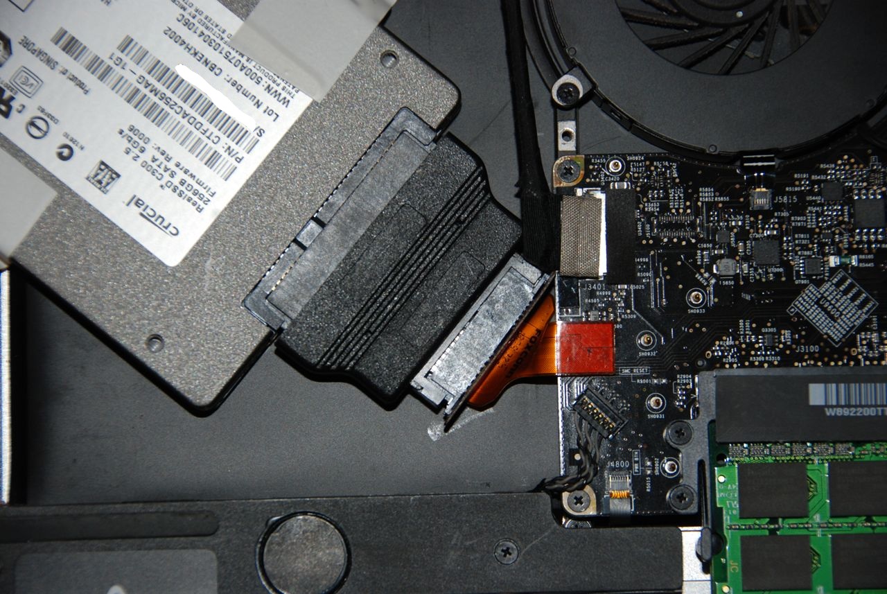

Method 3
Motherboard connector > 13 pin to 22 pin SATA adapter > SSD.
View attachment 281573View attachment 281574
The only issue with this is the kink in the motherboard connector. A bit of tape was required to stop the mobo connector pulling away from the adapter.
So for anyone thinking of doing this, you can do it with a £5 adapter 🙂

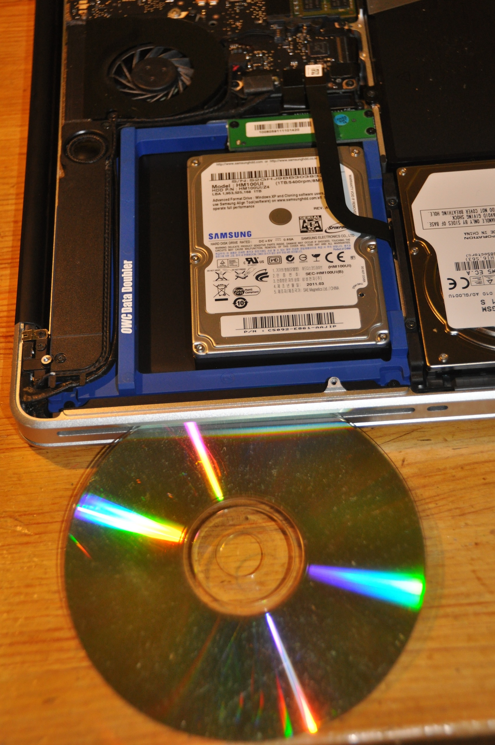

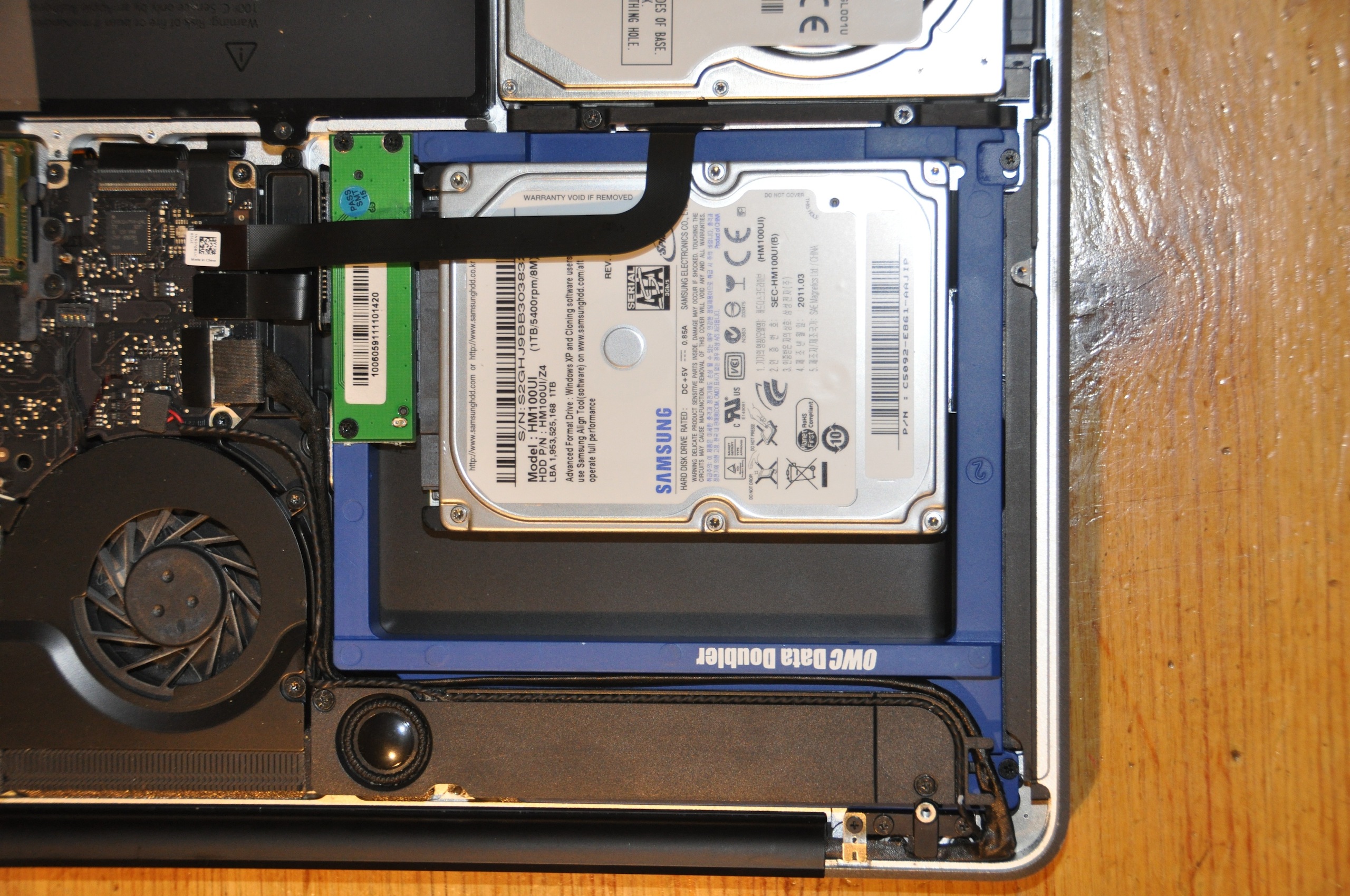

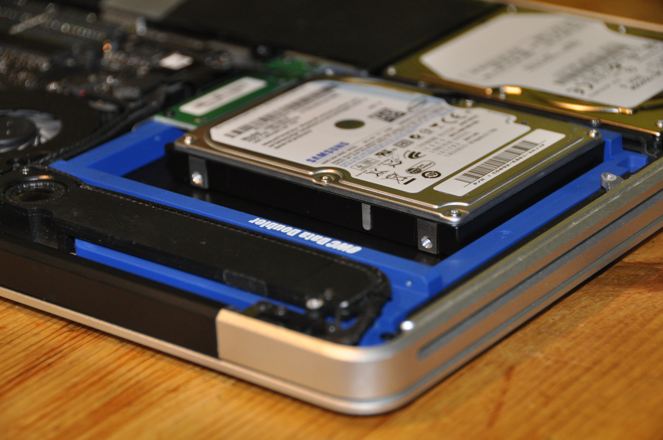

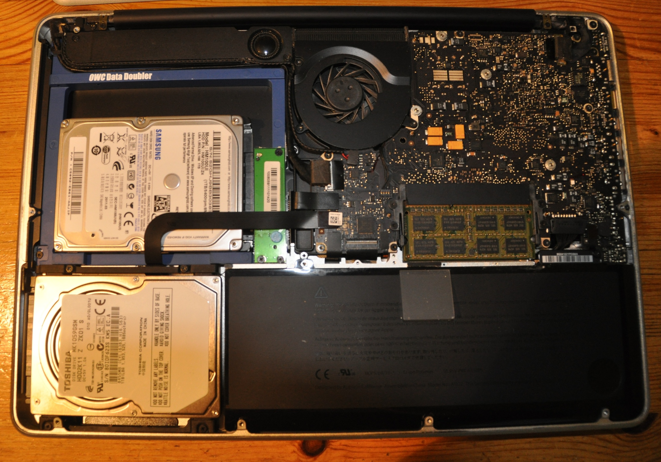

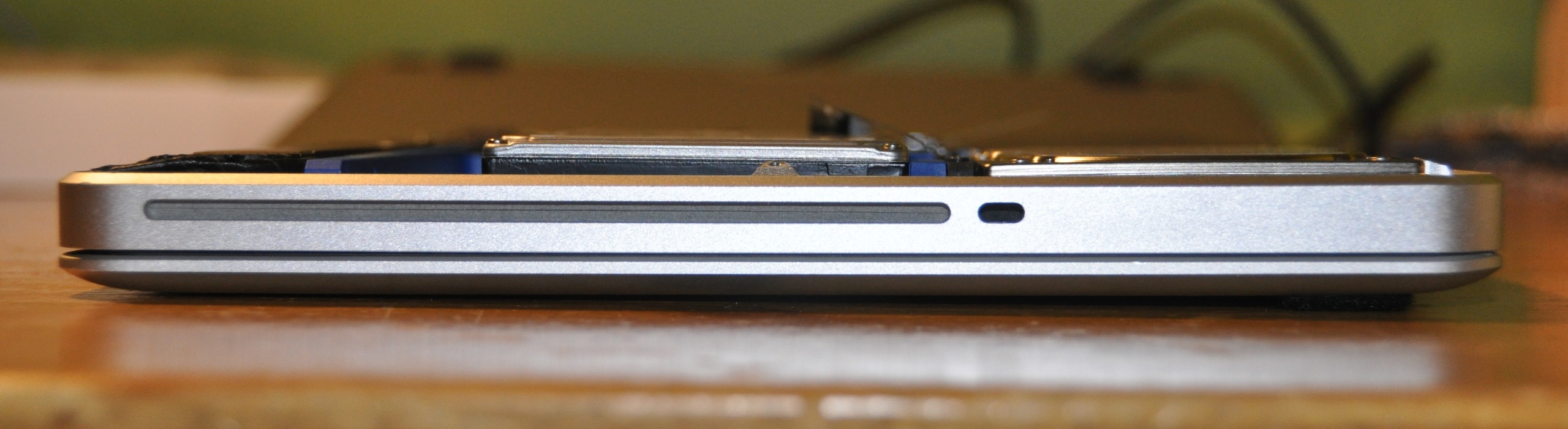

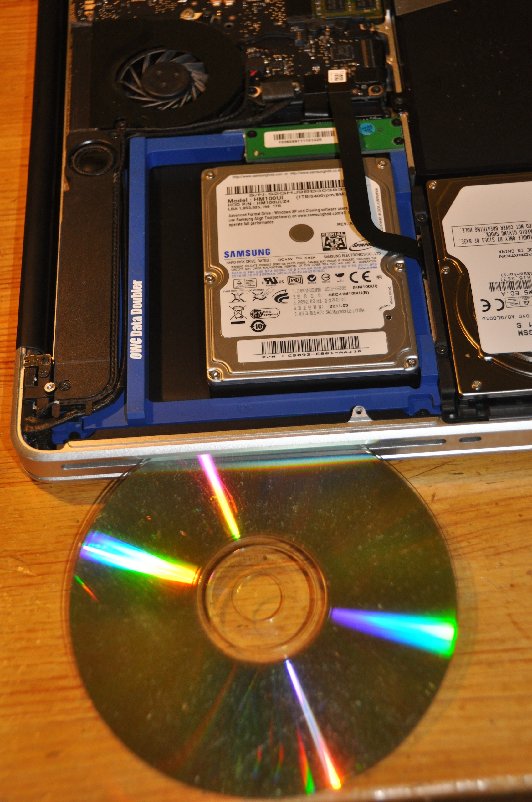

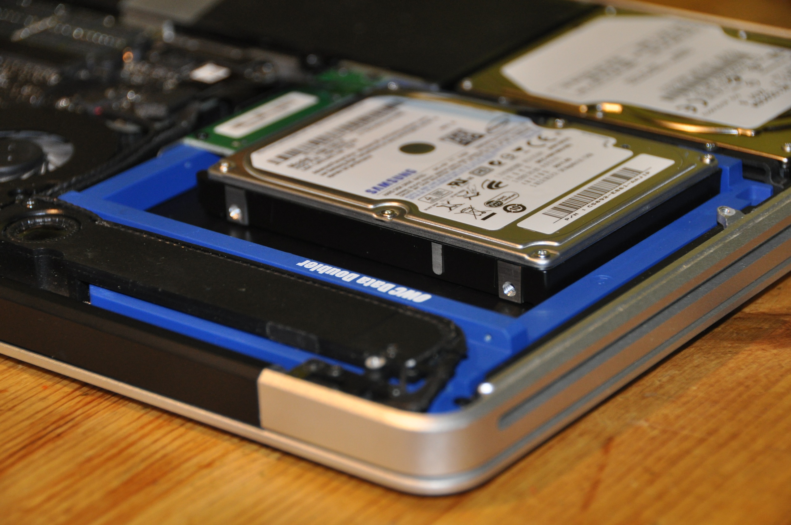

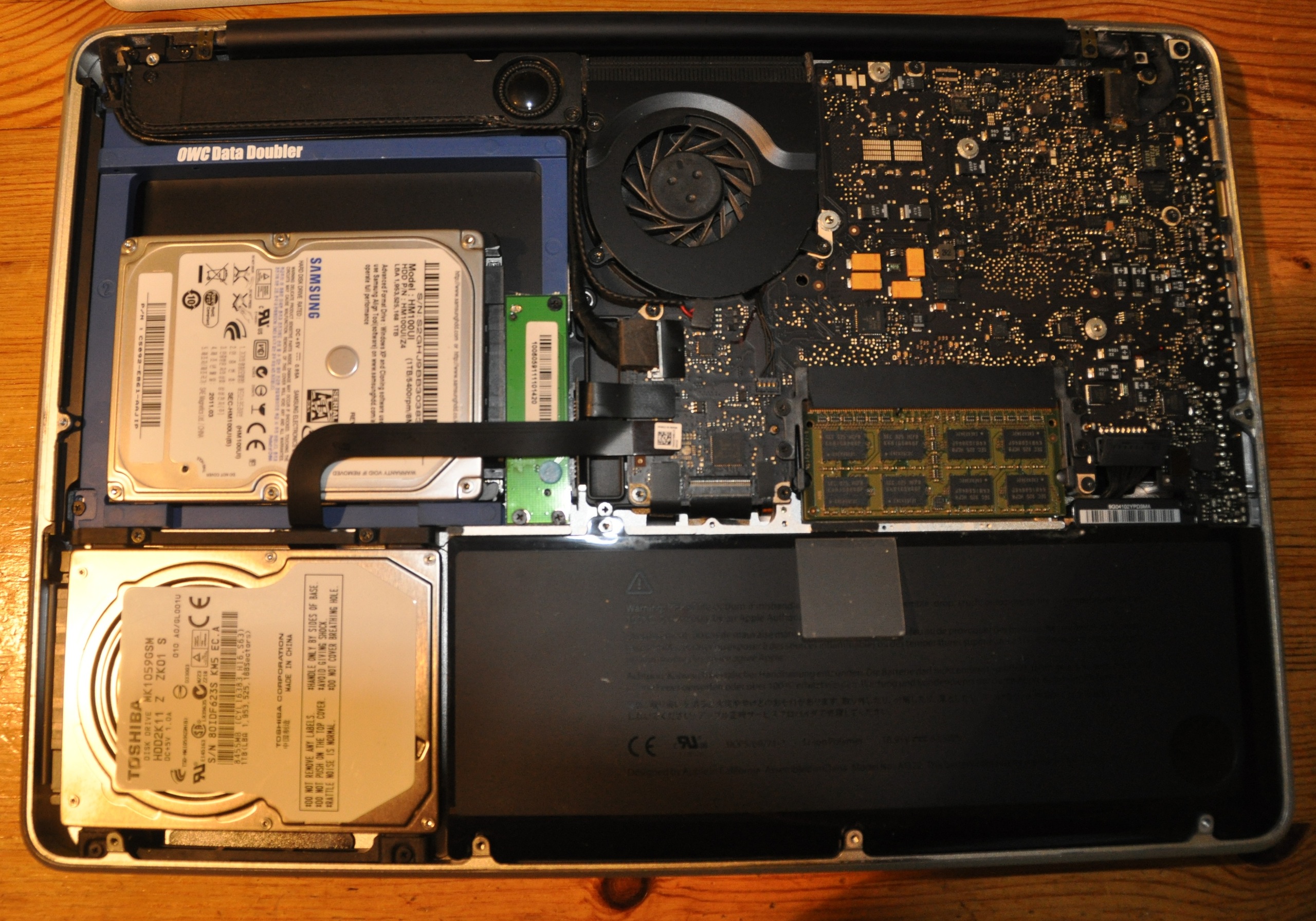

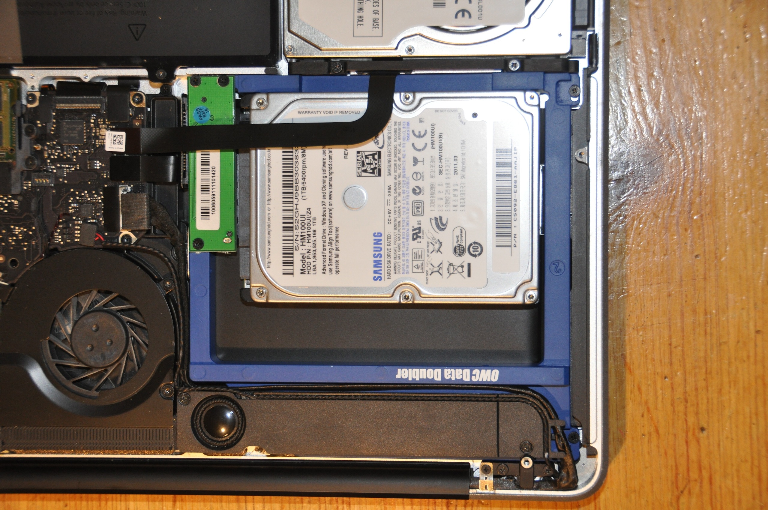

Okay, I tested a 12.5mm drive with the OWCDD in a 13" 2010 MBP and it does NOT fit. You might be able to screw the cover shut, but it would stick out a few mm and does not fit nicely.
Nice piece of kit though, feels very good in the hand. Solidly built.
Video review shortly.
Man, the CD just looks so tiny and cute compared to 2x 1TB monsters! Haha, it's no accident that it's all dusty.
