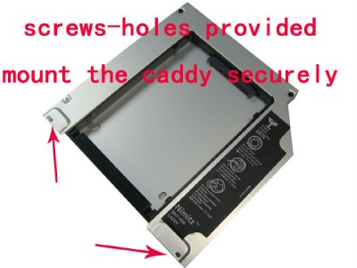

I noticed that nimitz** has two different $28.99 "2nd HDD caddy Apple OptiBay SuperDrive Replacement SATA" listings:
My question is, which one should I buy for my 2011 15" MBP?
P.S. I bought my MBP from Amazon on June 3 and can confirm it does have SATA 3 6Gbps in both drive bays.
I mailed nimitz about this, here is his reply:
The normal version fits poor. it has not the holes to fix the caddy.
see pictures: http://img.auctiva.com/imgdata/3/4/5/0/2/7/webimg/477372499_tp.jpg
you should buy the special version for your macbook 2011.
regards.
- nimitz**

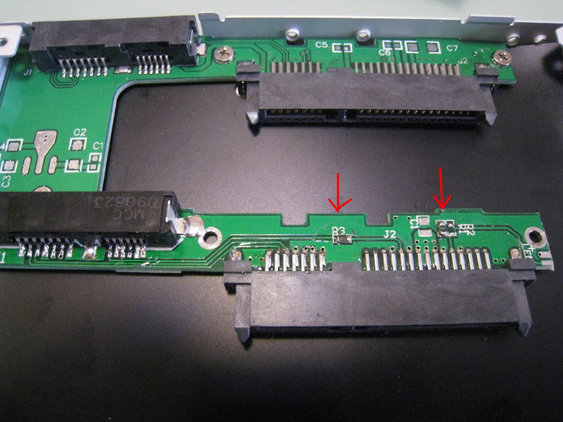

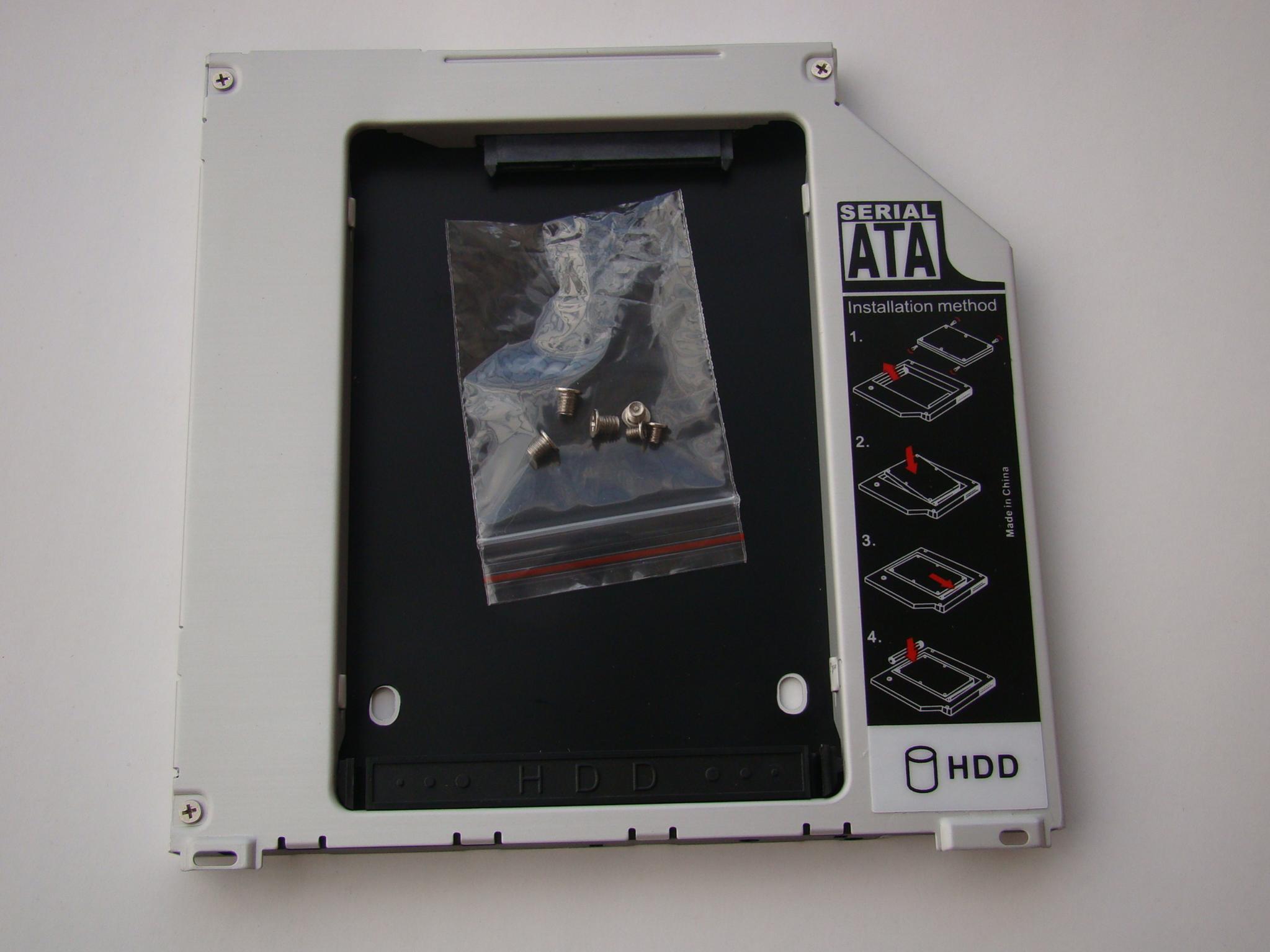

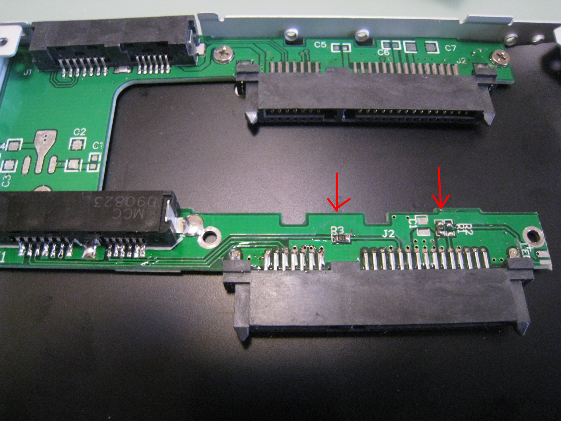

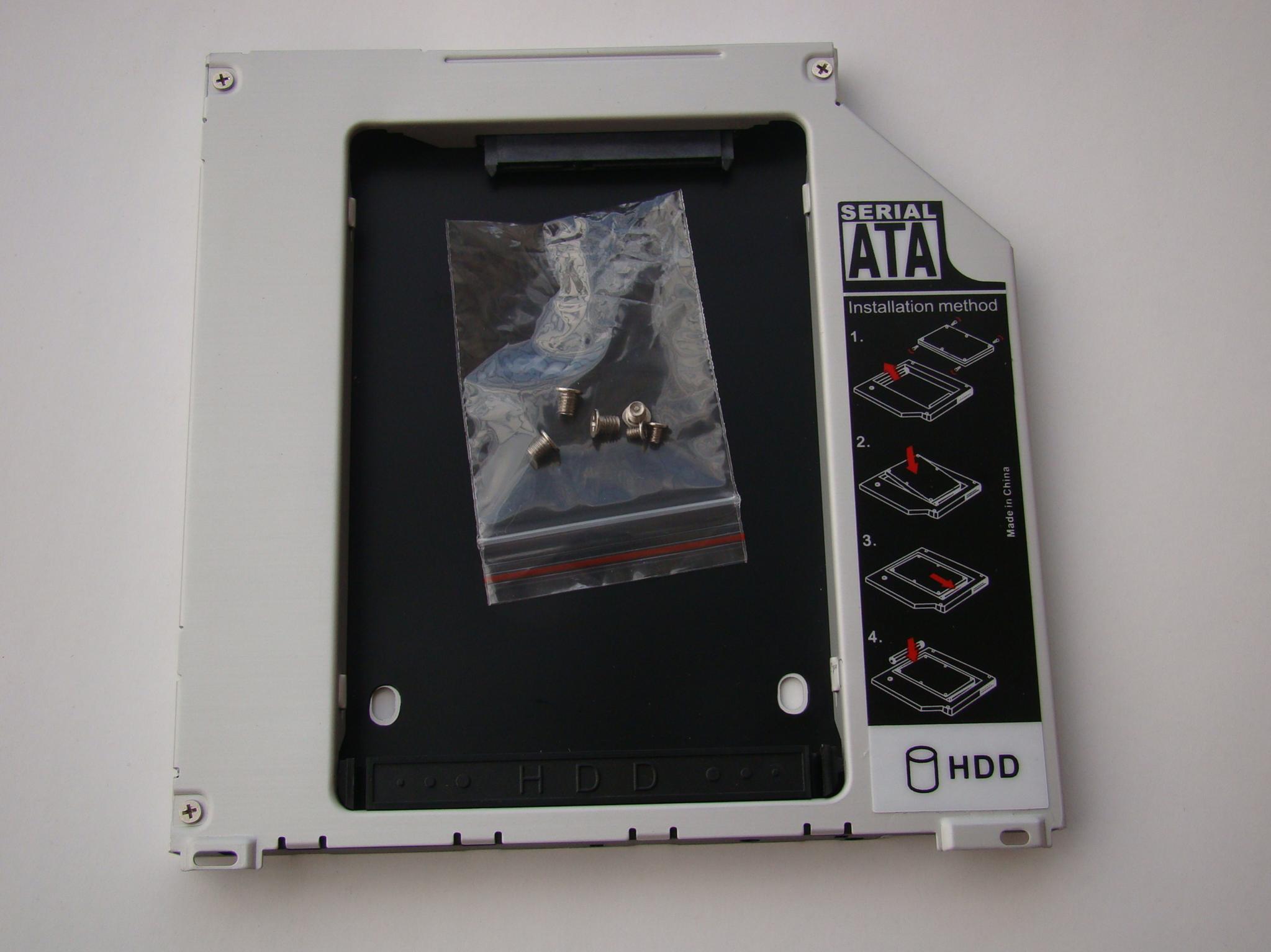

i like many others have put in a second harddrive in my MB5,1. i originally bought the one that has the FENVI Label on it. it worked like a dream with my OCZ SSD, no problem at all, no lose parts or noise as the SSD is not spinning in the optibay.
i then bought another one see attached, physcially have the missing holes as per the optical drive that came with the MB. i swapped that one in, hoping that would be more muscular. and it did hold the drive in very rigidly and it would just work. however, having the same SSD with the same OSX, it was very upset, first it didnt know where to boot on the apple icon jumping to the folder, i pressed OPTION to boot, it saw the drive, but won't boot. i tried a few more times, it finally went into OSX. but no application ran on the new Caddy, even firefox and safari just jumps on the dock and spit out with the error reporting, then OSX just quit altogether. obviously i went back to the fenvi caddy, no problem at all. anyone had these kind of troubles?
then i took both Caddy out and dissembled both units. looked at the PCBs on both the latter one have two resistors on some of the pin lines (e.g. pin5 from the left) that the one that works do not. the one on the right seems to be a 0 ohm resistor. but i don't have an ohm meter, so i dunno. any ideas??
obviously best of both world is to have the working PCB with the rigid Caddy, but i had to return the rigid one becoz simply it wasn't reliable pushing data out to me MB.
That bottom one seems to be soldered together by a complete retard 😱
The missing resistors means that those lines are not connected to each other at all. In other words there's an infinite resistance between those lines. If the one that works is the one without the resistors, you could try to remove the resistors from the bottom one.
i concur... i would believe the top one (fenvi) is machined. bottom one (e-Sun) hand soldered and very badly done. obviously fenvi is more expensive than the e-Sun one. Again, i don't have an ohm meter. the track seems to indicate resistors R1 and R2 are in parallel. but R1 is printed 0. only to believe it is a 0ohm. The other single resistor seem like, anyone have with the SATA connector pin 5, and with that resistor, what is the purpose? why is it making OSX crash? and why would they do it that way? to create a low pass RC (with really ***** capacitance on the connector)?
