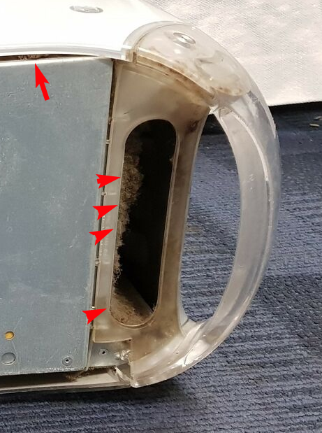

I've quite a few MDDs and a bit of (on-going) history with them. In fact, the one you’re considering is my favorite configuration. I think their PSUs are weak and prone to failure (especially at this point in time - 20 years later). I've also replaced quite a few MDD failed PSU's.
However, some of that PSU weakness might be directly attributable to the PSU being taxed also with providing power to ADC monitors. (A reason I don’t use such monitors and opt for DVI monitors instead.) *Video card in that listing does also have a DVI connector.
AND both time and internal temperature take their toll as well… which brings me to this:
Seller might have taken the time to blow down the internals of this MDD but neglected to clean the front air intake. With so much dust (and possible cigarette smoke residue) left untouched, this leads me to wonder what the main CPU fan blades AND the PSU fans might look like. I can envision a PSU full of this same fuzz and residue… and possibly weakened more over time by this - and with increased internal operating temperatures (cooking capacitors?).
Maybe once owned by Arthur Brown?
So, while I don’t know if this is a good price for an MDD in the U.K. - I might shy away from this one, especially if I couldn’t preview it’s performance and fan condition(s) in person. I can only imagine the internal state of its’ PSU and if it has anything like what we see on the air intake, inside. Not good.

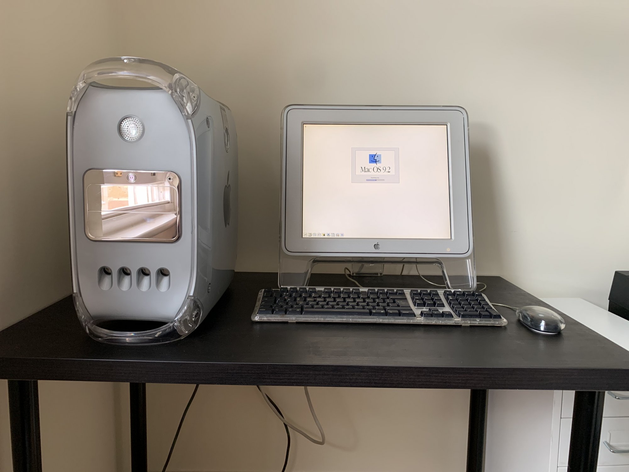

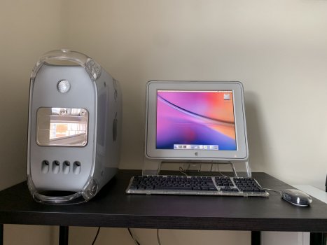

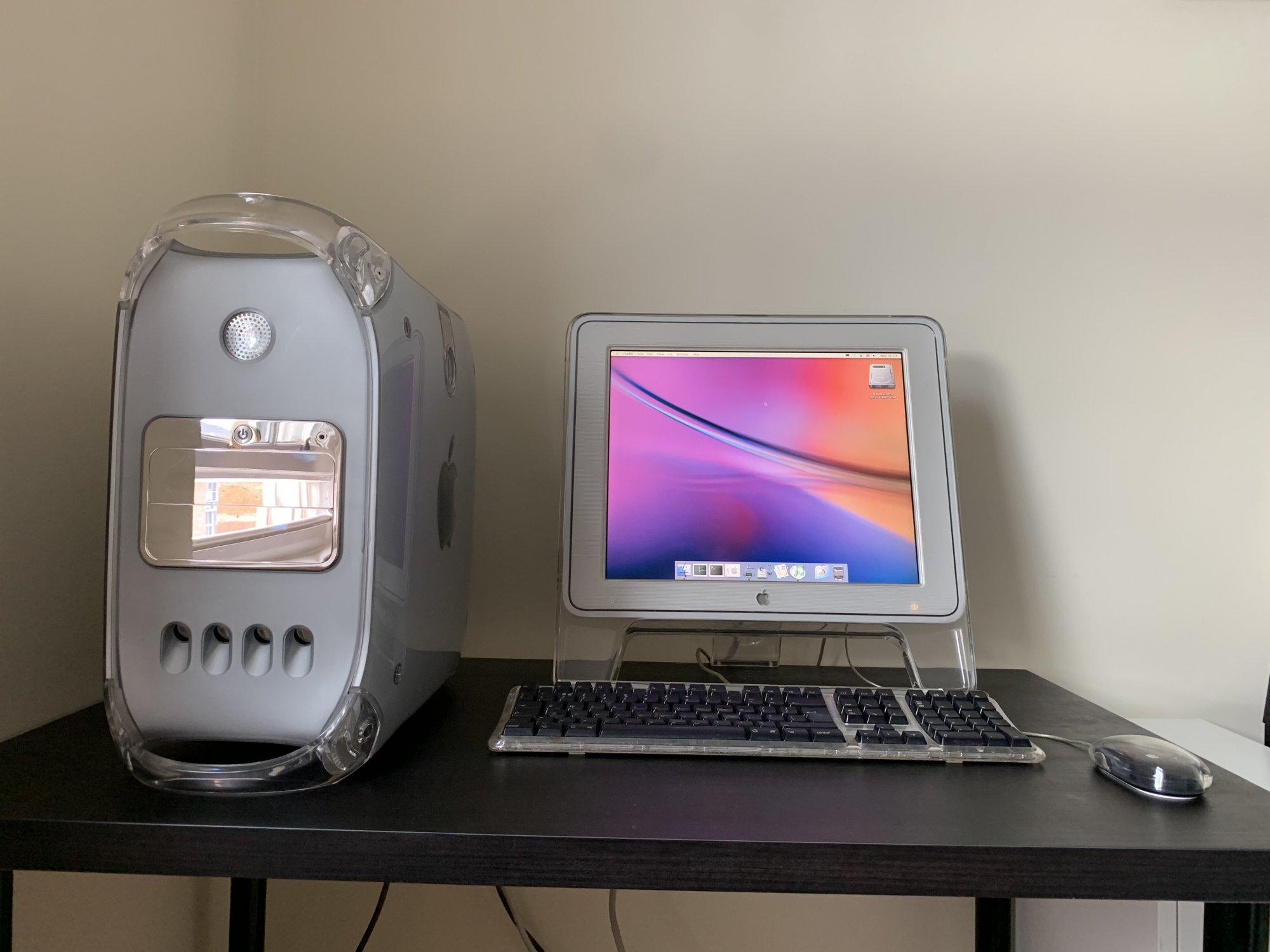

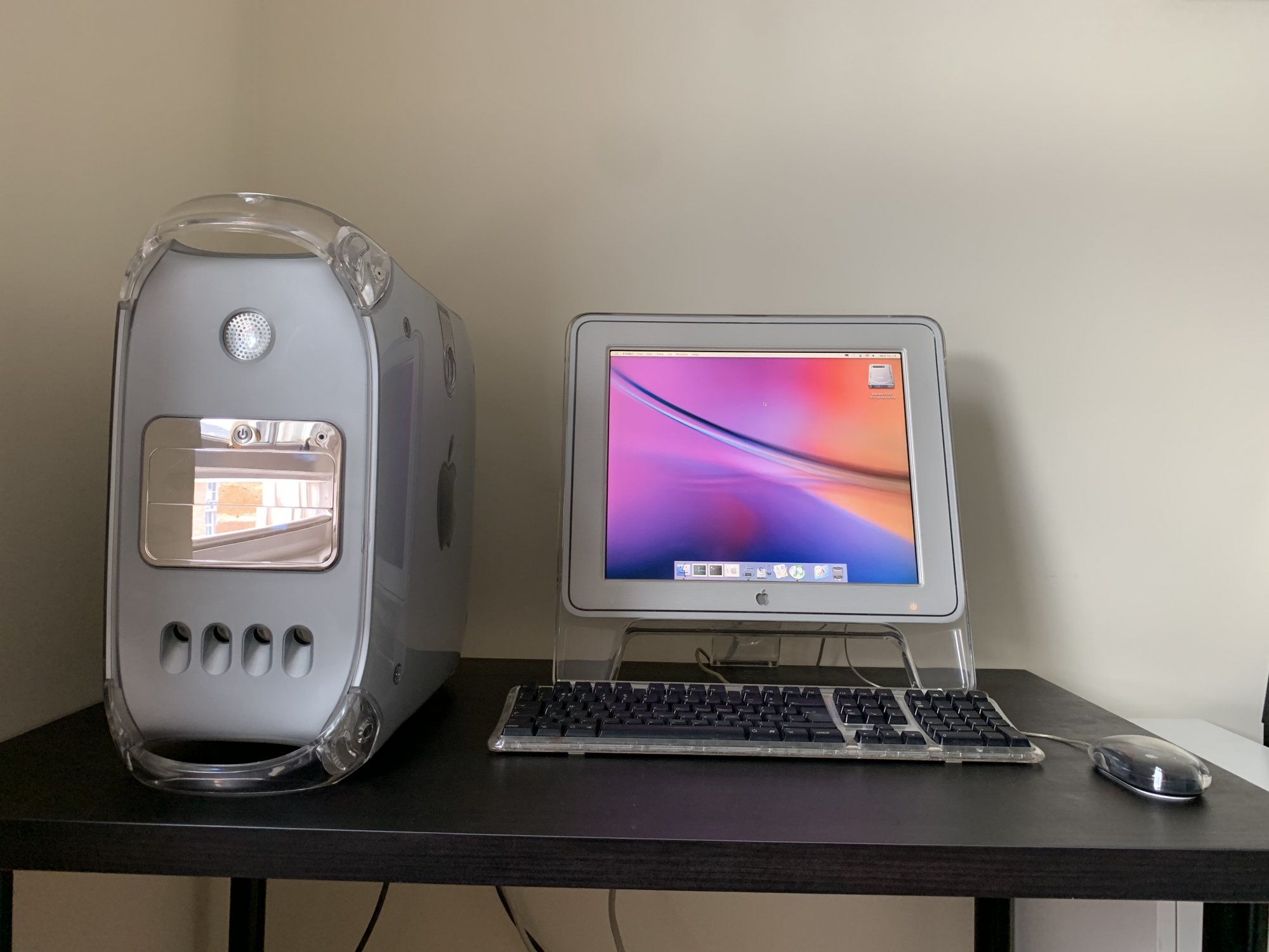

Looking at the size of the ADC and the res of the screenshots I get the feeling that it might be just the 15" version (1024x768).
