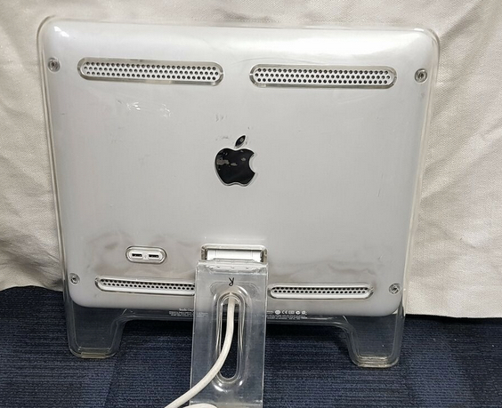

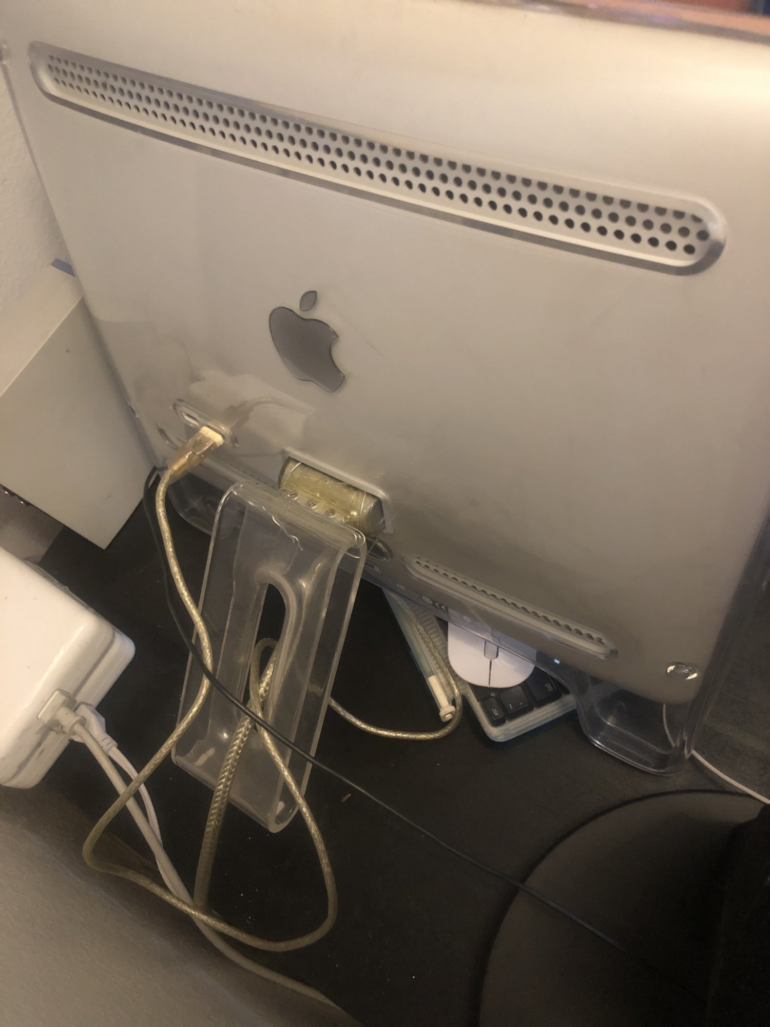

Yanno, looking at my 15" ASD, the monitor in the auction could be a 17 inch. I noticed its grates are different. My 15 has one long grate while the auction 17 in question has two like my larger ACDs. Check out the back shot from the auction below.
See what I mean? I dont actually own a 17" studio display to verify. The vent change could also be a revision update I suppose but I'm not up on Apple Studio display revisions. Anyhow, something to ponder. I am a big fan of this generation monitors. What a striking and innovative design. When you think about it, at the time they came to market, most other quality flat screen options had a much bigger foot print.
