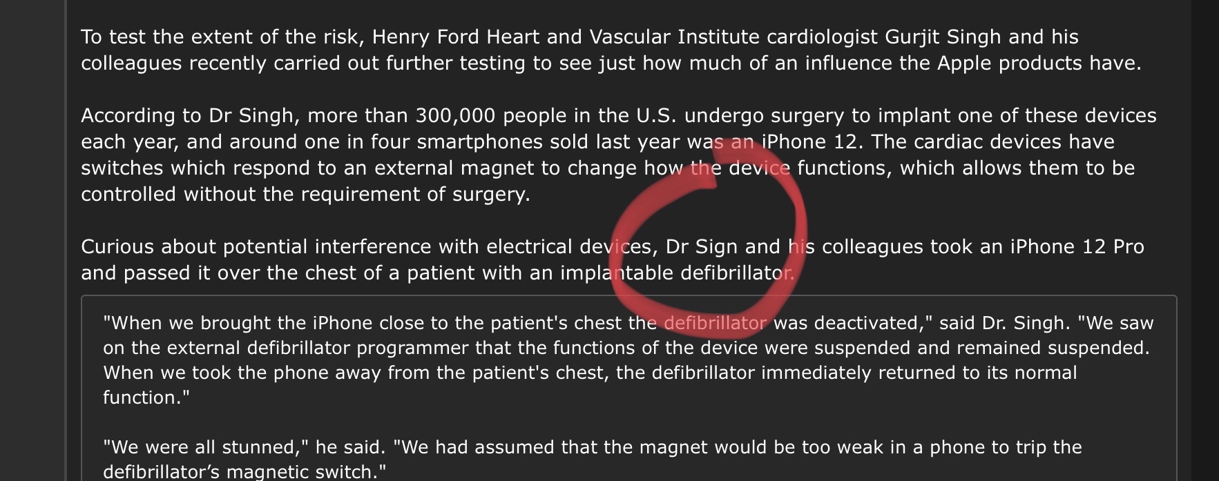

Tim Hardwick, quick heads up: your autocorrect being too aggressive . In the paragraph “. Curious about potential interference....” it should be Dr. Singh not Sign. ;)
Curious about potential interference with electrical devices, Dr Sign and his colleagues took an iPhone 12 Pro and passed it over the chest of a patient with an implantable defibrillator.
