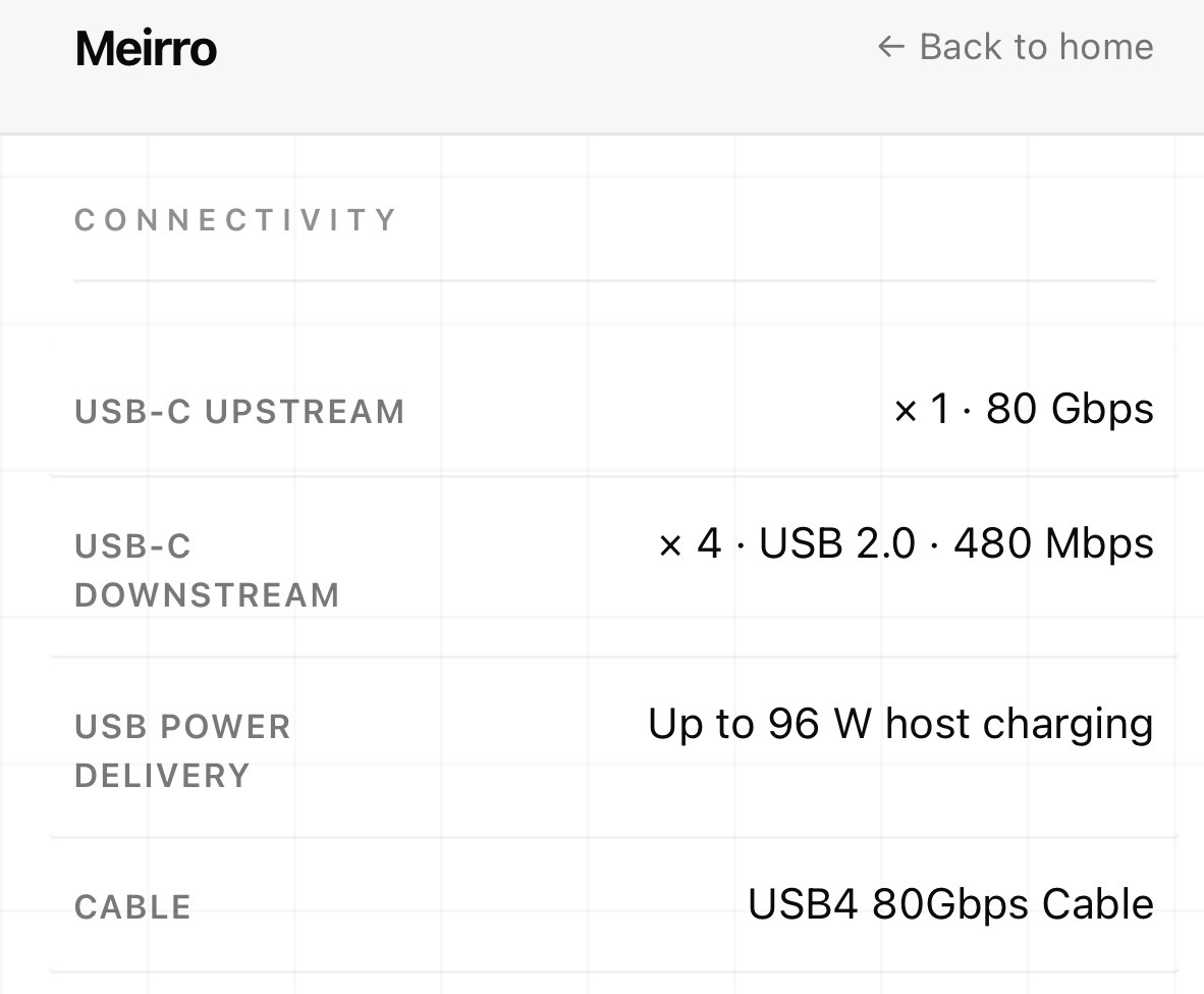

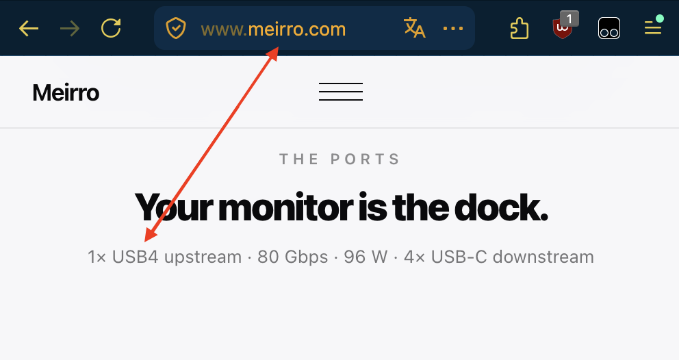

I hate their marketing BS. DP Alt mode (even UHBR20) doesn’t equal USB4. Period. This monitor doesn’t support USB4. It supports DP Alt mode plus USB 2. That’s it.
There is some misunderstanding here. Check out Meirro official site, no claim/marketing on upstream port being USB4. In connectivity: there is USB-C UPSTREAM × 1 · 80 Gbps and Up to 96 W host charging.
There is clearly some gap in understandings here and Meirro could have done a better job explaining, but there is no misleading marketing here. There is some compression, yes, so the full term should be "USB-C — DisplayPort Alt Mode, 80 Gbps, 96W PD, compatible with Thunderbolt 3/4/5 and USB4 hosts".
More importantly, in this case, with downstream ports being USB 2.0 and no daisy chain support, having USB4/TB4/5 adds only artificial complexity and is practically irrelevant.

I think explaining it is a USB4 Version 2 input port with support for DisplayPort over USB-C and UHBR20 (80 Gb/s) has been simplified to just “USB4” and “80 Gbps” …
You are right. Good catch. This should be fixed.
To be fair, as @Renfy said, the specs (attached) don't say that. I gather my understanding of what "USB4" means is flawed, and claiming that is like claiming Thunderbolt support. I would expect Meirro to fix this promptly, since it's a simple matter of changing "USB4" to "USB-C" in the "Ports" feature description.
As I noted, this whole discussion is reminiscent of our old discussion of the G32P and confusion with regard to its "Thunderbolt 4/5" claims. Meirro deserve credit for listening and *not* simply repeating those claims.
yeah, I hope they remove all the remaining mentions of USB4 from the website. Otherwise, it would look like the port description was intentionally written in such an ambiguous way. People who aren't very tech-savvy might think this monitor has USB4 functionality.
