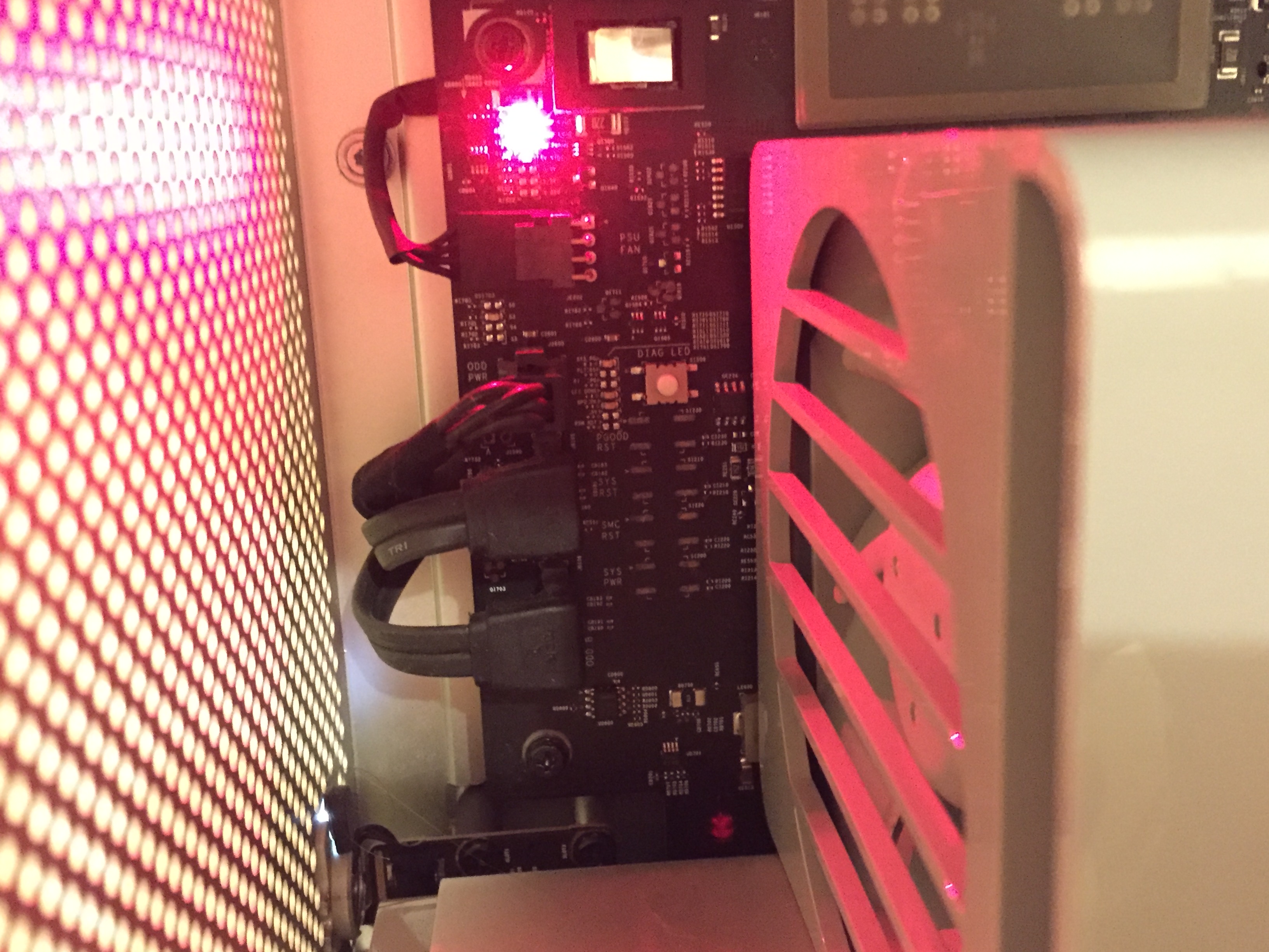

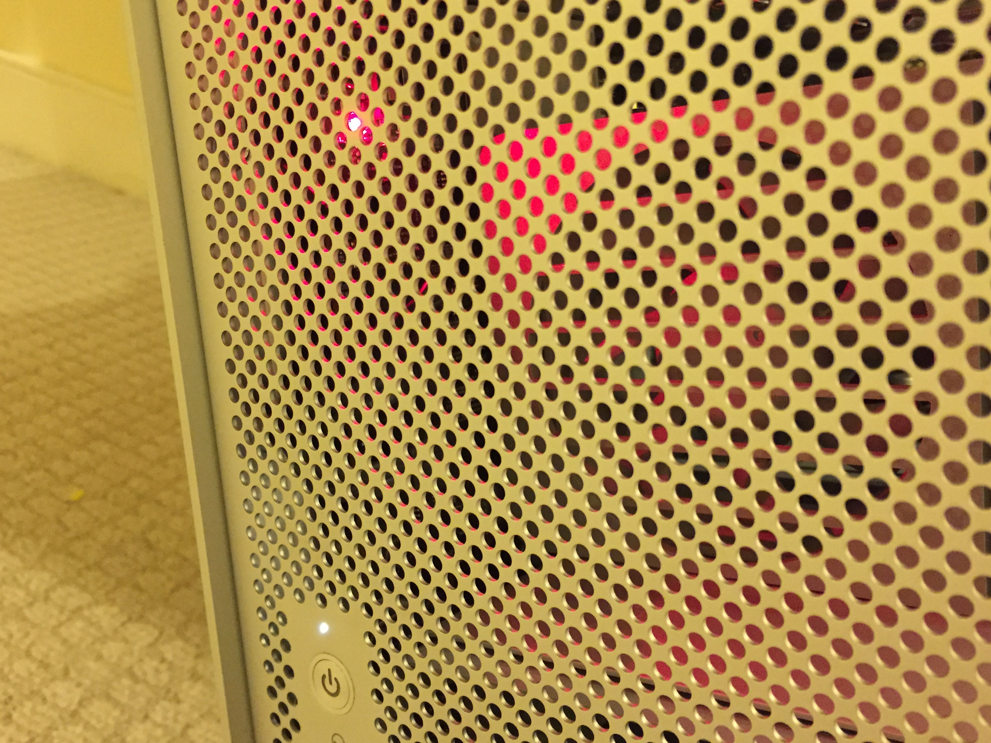

I have Mac pro mid 2010, 5,1 quad code model. It was working fine since 2010. few days back there was red light near CPU heatsink, but it disappeared when cleaned all dust and it start working again. Next morning when I switched on again, it's dead, no light, no sound, no fan movement, nothing is happening.

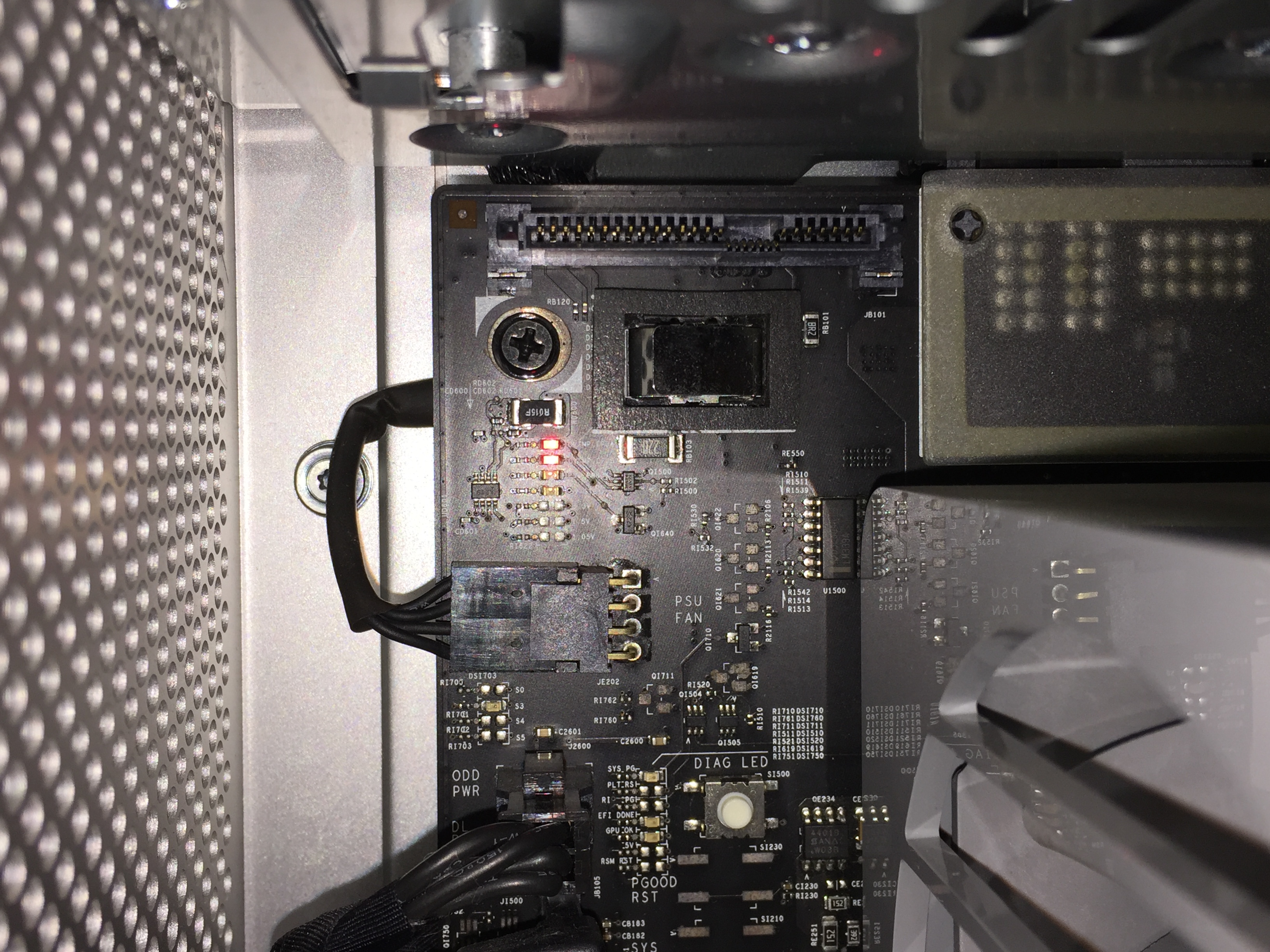

  • When connecting the Mac Pro to AC power, the LEDs for OVTMP CPUA and OVTMP CPUB briefly flashes red and also momentarily flash red immediately after the Mac Pro is disconnected from AC power ( note 1 & note 2, page no. 34 )
  • after pressing DIAG LED button on board, the 5V STBY LED illuminates
This indicates the Power supply and Logic board is fine. The power button was giving problem from last 1-2 months, I need to press sometime 2-3 time to start the system.

I have tried to jump the SYS PWR pads to start the mac pro as (shown in the video, possibly on correct power-on pads), but no result. Can someone please suggest what is the best solution or what might be the main cause?

I am having the same issue. I get two red lights and the 5v light. So this really indicates it is not the logic board? My Mac Pro 5,1 was working just fine and all of sudden it shut off.

I’ve acquired a Mac Pro 5,1 2010 and after a day it failed in a similar way. Bring it home, removed video card and cpu tray and blowed dust of whole machine. Put it all together, new ram (spare 4xGB from old server, same speed) an powered on.
Started full fans and thought of ram issue and unplugged power. Reseat old ram and never again power up.
Diag button shows 5v standby, removed rtc battery (exactly 3v), power pads on board do nothing, smc reset put cpu red lights on and off when released.
Tried removing board and cleaned connectors with isopropyl alcohol, same on processor board. Shorted Pwr_on pins on power supply outside and it started ok.
I was thinking on smc issue, found microcontroller datashet but no boardview or schematic, and don’t know startup procedure of smc in order to test it.
On the board measured low ohm resistors near power supply connectors (usually used as fuses) and all where ok.
Anyone could give me a hint?

EFI done led is lit when you press the DIAG button (start with page 33 of the Technician Guide, you can get it here #19)?
Maybe you just have a bricked backplane…
