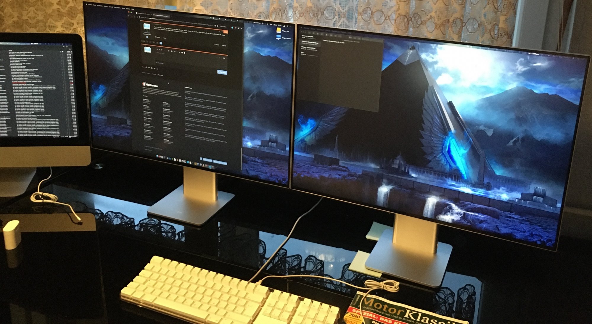

Here's my take on the "two MateViews are better than one" theme. Excuse the less than ideal lighting. To the left is a 2015 iMac 4K which “runs” these and acts as a third display.
Edit/Update: I'll be returning the second MateView and asking for a replacement because it's visibly “crooked” to the left: height from desk to screen is about 5mm/0.2” lower on the left corner than on the right.

Could you put the info about resolution and Dock/cable/adapters that you are using?
Because I have the same iMac and I`m looking for info to configure mine.
Thx.
You need an eGPU (hooked up via Thunderbolt 2) to run the MateView. The 2015 iMac’s built-in Intel Iris Pro 6200 GPU can't run it at full resolution. I’m using an AMD Radeon RX 460 (a Fujitsu OEM version with three DisplayPorts — most 460s only have one) in an Akitio Thunder2 enclosure. And the purge-wrangler patch to enable eGPUs on pre-Thunderbolt 3 Macs. This patch has since been superseded by Kryptonite though.

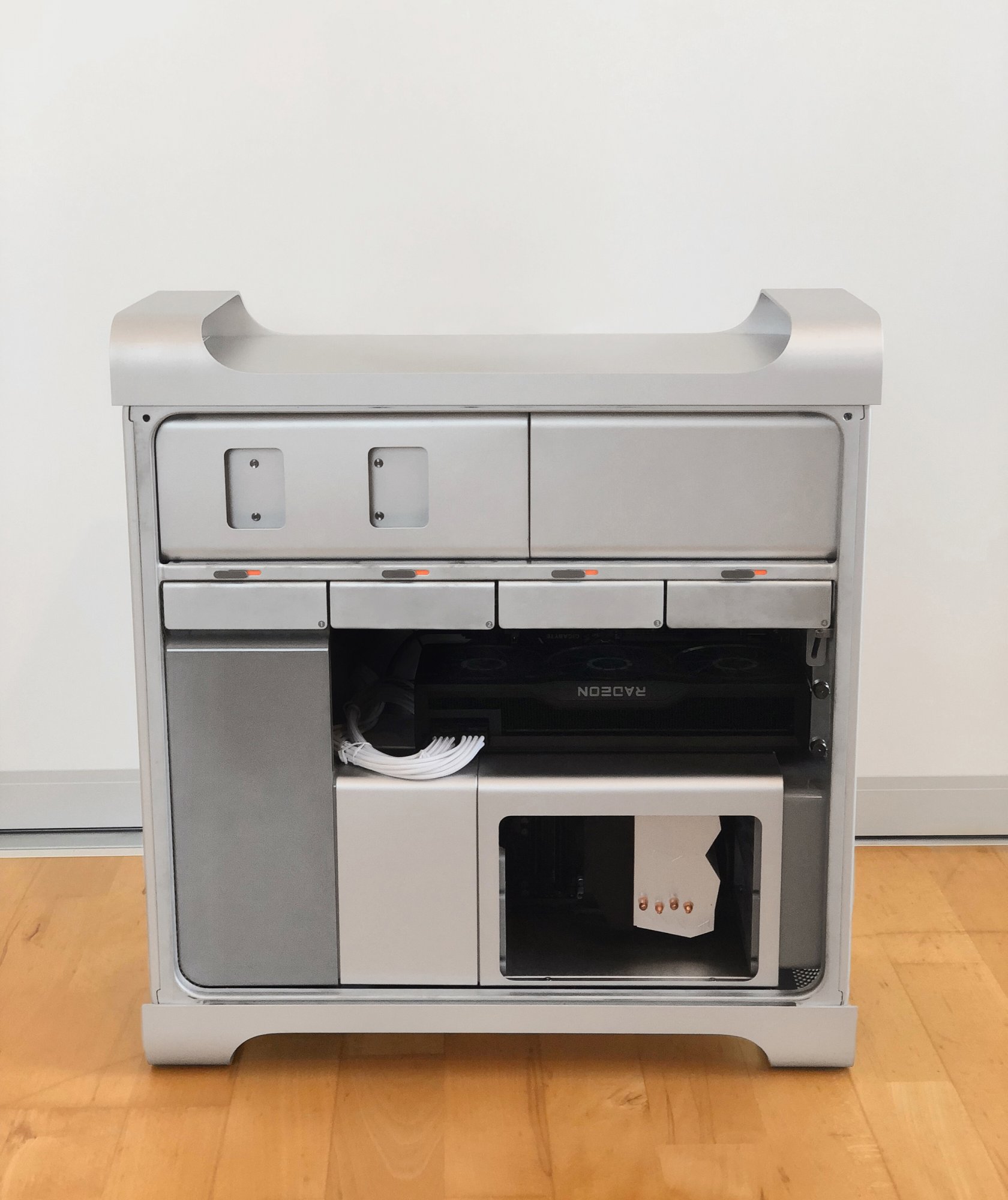

Hello everyone,
i have this Monitor since august and i really love it. The aspect ratio ist perfekt for me and my work.
I want to have a good looking hardware, that's why i´m using a Hackintosh in a Mac Pro 1,1 case and the MateView ist the prefect combination for it.
Unfortunately there is no HDR Option
I hope that the next monitor from HUAWEI will have a higher resolution and 120hz.
Hello everyone,
View attachment 1942824 View attachment 1942825

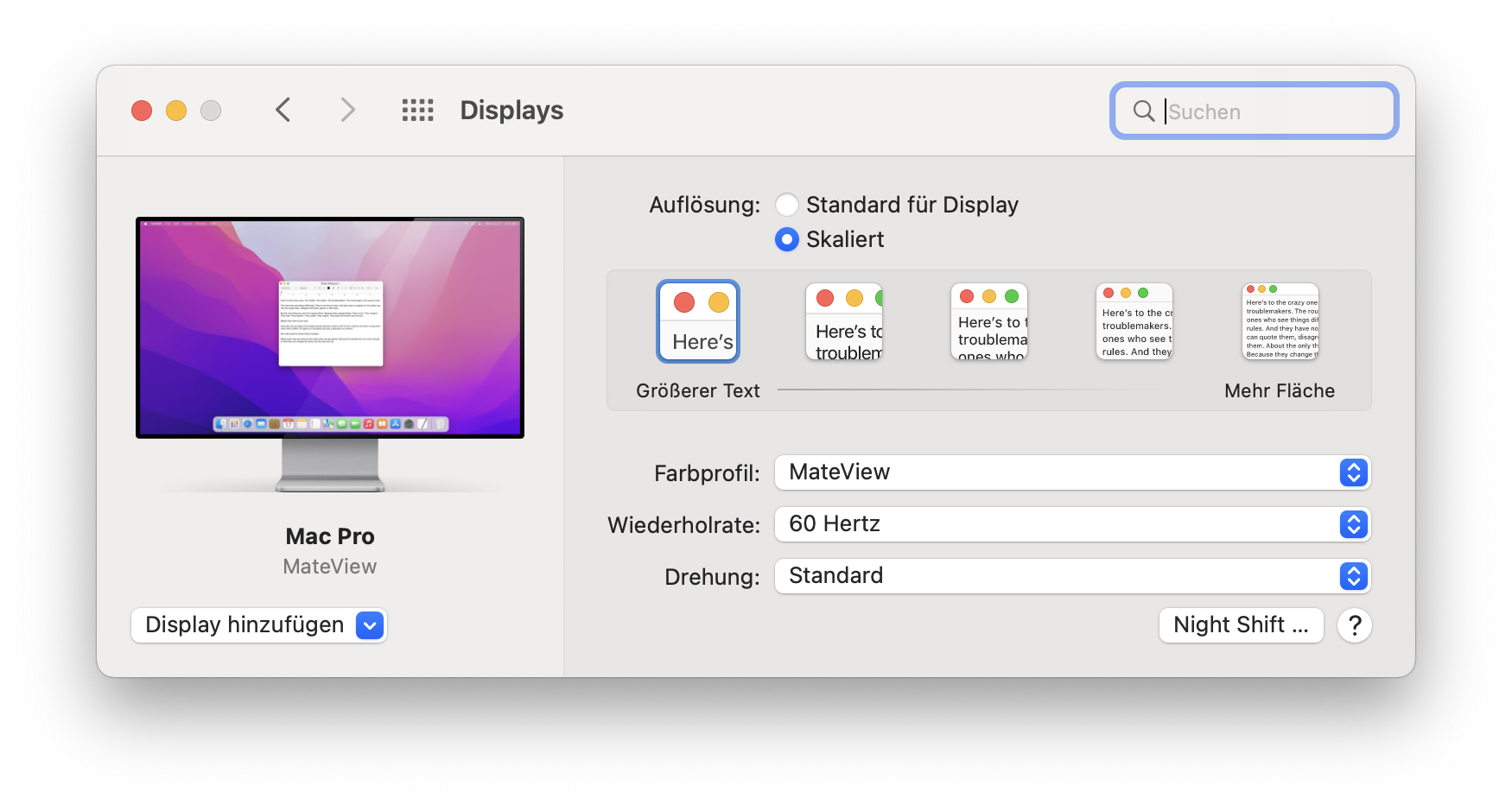

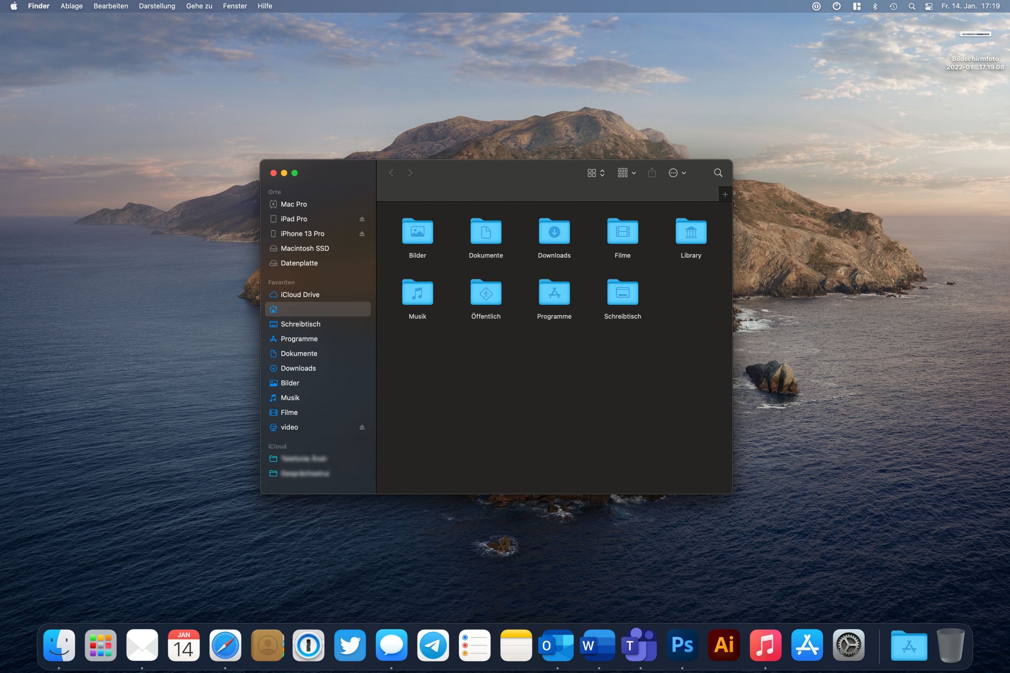

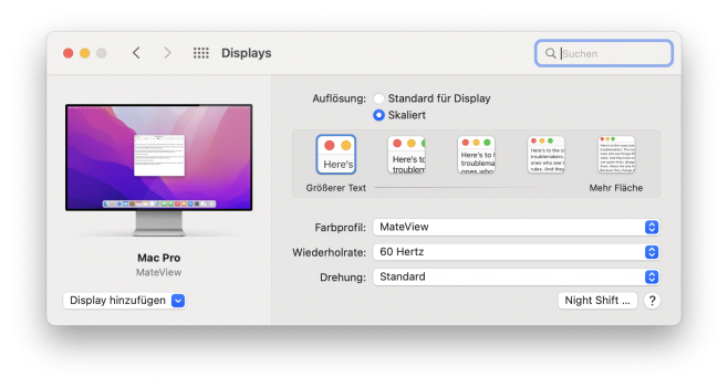

May I ask why you are using scaled resolution versus the monitors native resulotion?
I have no idea what that means.. you mean that you are running the monitor at 1280p?
Yes and no 😄
The rendered resolution is 3840x2560 but the ui will look like 1920x1280.
Apple is using that on all Macs. The iMacs resolution for example is 5120x2880 and is displayed at 2560x1440.
Using the option ”standard for this display“ is using the exakt same settings as I do.
Nativ res without HiDPI is way too small for the UI
With HiDPI everything looks sharper and bigger
Yes and no 😄

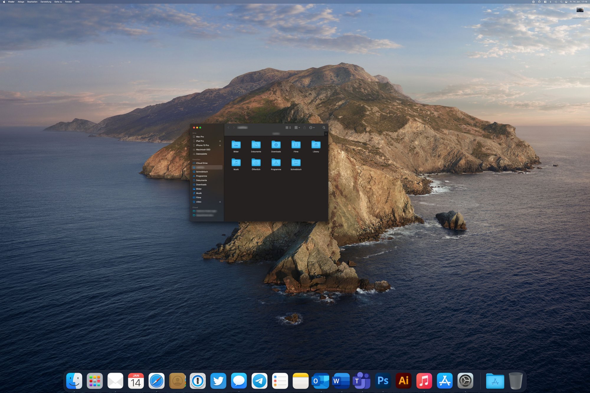

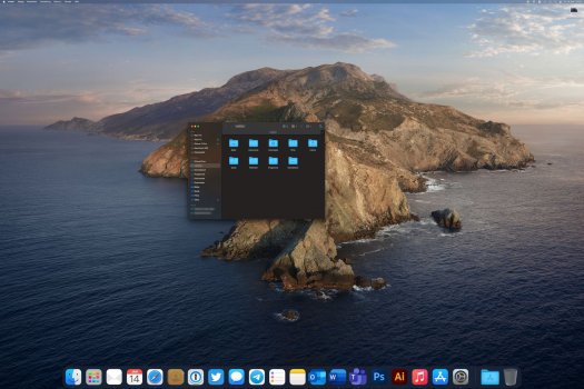

Aha. Thank you for taking the time to explain. Personally I would opt for the Native res without HiDPI (the first pic) though. More space to work with. More tracks that I can see at once in Logic Pro for example. But I realize this is a matter of personal preference.
Because macOS is not resolution (ppi) independent and the native resolution (pixels) of this display does not match one of the only two resolutions (ppi) that macOS supports well, normal aka @1x, and retina aka @2x. It's a real shame, this is such a nice display, but the ppi is exactly where it shouldn't be for macOS. 50ppi more, or less, than its 163ppi and it would be perfect.

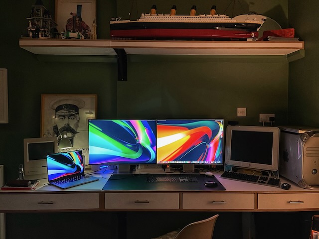

I recently got two of these monitors to pair with my 14" MBP M1 Pro. As a size comparison, that's a Macintosh Classic, and a 17" Apple Studio Display either side.
They are aesthetically very beautiful displays, and HDR is very impressive on them. With HDR turned off they have a peak brightness of 500 nits, so they really do pop!

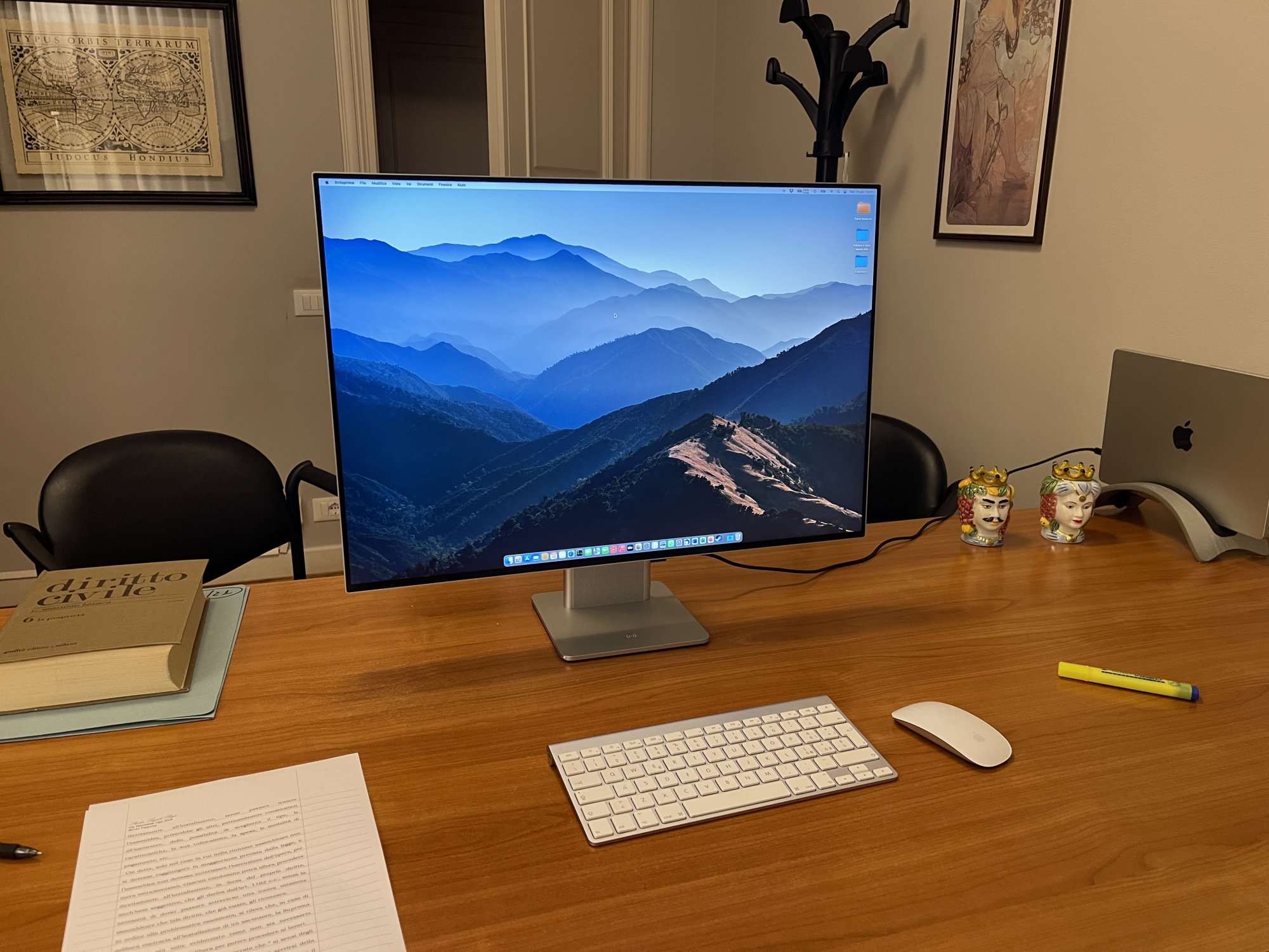

arrived today. that is to say, it seems to have been designed exactly as I always wanted it. I am a lawyer and I senor hated 9/16 for working. This monitor is just perfect for my needs! I have read the whole discussion and, thanks to your advice, I have set 2304 × 1536 the resolution that is ideal for me. Question: I set the "native" color profile as a cone and I calibrated it using the Apple utility by setting the white point to about 55 (higher it seemed tending to blue): what color profile did you choose?

Received the replacement — and it’s also crooked to the left by about 2mm.
Did the screens look the same out of the box? I had to calibrate my 2nd one as it was too yellow.
