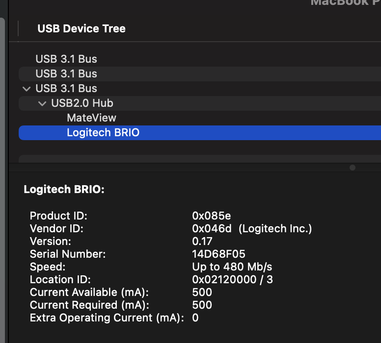

Have just bought Mateview for my 16" M1 MBP, since I got a bit disappointed by the ASD (high price for "just" an IPS panel). I tried Blackmagic disk speed test with USB-C SSD (with adaptor) and it is only ~37 MB/s with the Huawei's USB port (vs. 400 MB/s when plugged into Macbook directly), so pretty miserable :) but it will be okay for a webcam...
I have MBP attached via USB-C cable to the monitor.
Edit: I just saw that System Information shows this as USB2.0 only anyway :)
I also have the OWC TB4 hub I used with my old LG 4k monitor (which did not have any USB-C) laying here disconnected... So I will have to see whether I can live without additional USB3.X ports or the hub will get into action again :) (but I love the minimalistic setup with Mateview and MBP only)
Thank you for testing. So it is as I expected, it is only USB 2 speed if the video data goes through USB-C.
Could you please do the same test and connect the monitor to HDMI or Display Port? Then just connect the USB-C from the monitor to the laptop only for data transmission, with no Video data. I am curious if it will report as USB 3 and the speed will be better.
Does not work, Macbook sees Mateview as two displays, one over HDMI and one over USB-C, I haven't found a simple way how to turn the USB-C one off :) So it is still USB2.0

As far as I know, when a USB-C port is used for sending video to a monitor via Display Port Alt Mode, then the USB data speed over that cable can't be faster than USB 2.0 since the majority of the bandwidth is taken by the video data.
That depends on whether the monitor and the system it's connected to support DisplayPort 1.4.
If they do, only two high-speed lanes are required for DisplayPort's HBR2 link rate and thus "4K" resolution at 60 Hz. The two remaining high-speed lanes remain available for USB 3.x speeds.
If they don't, i.e. you're limited to DisplayPort 1.2, all four high-speed lanes are required for DisplayPort's HBR2 link rate and thus "4K" resolution at 60 Hz. No high-speed lanes remain for USB 3.x speeds, limiting you to USB 2.0 speeds.
The MateView doesn't support DisplayPort 1.4, so when using USB-C DisplayPort Alternate Mode, USB 2.0 is as good as it gets.
