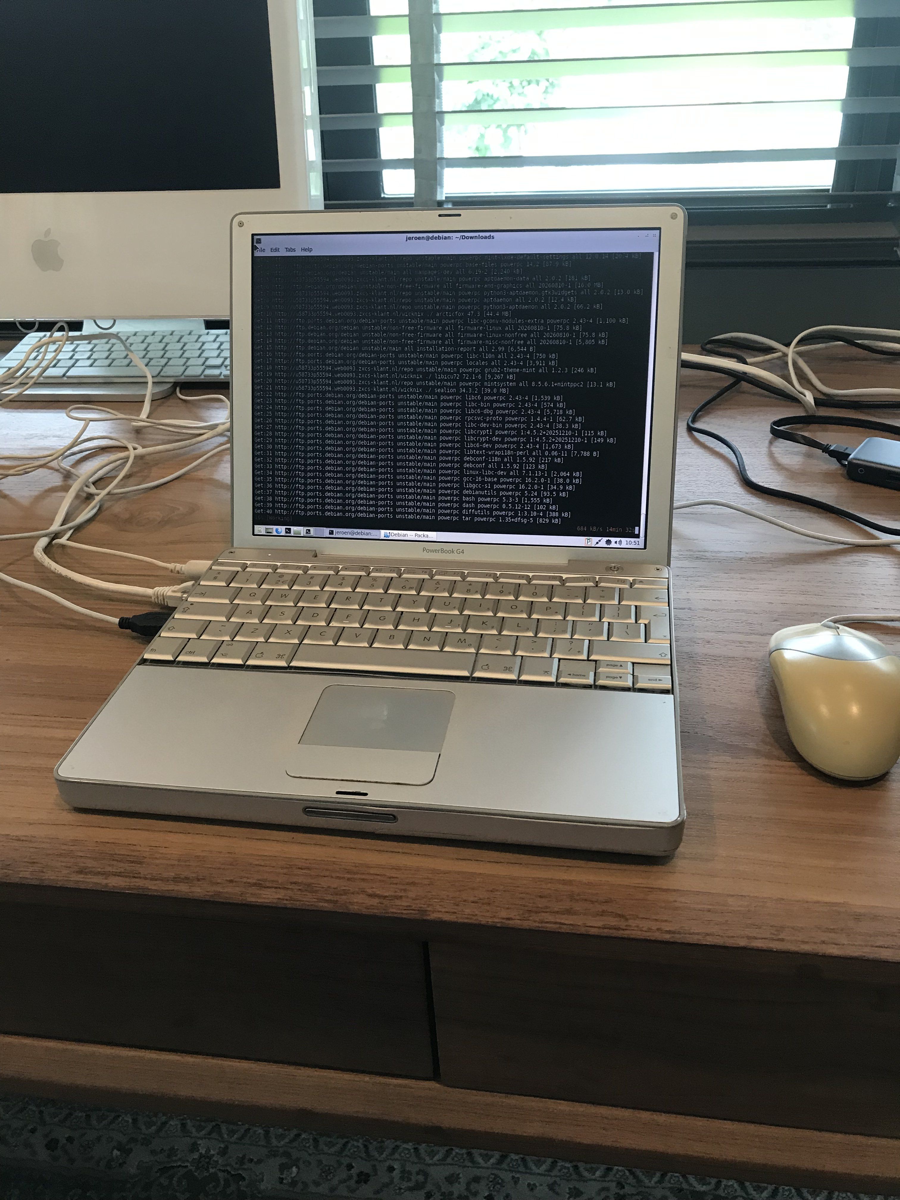

The computer I developed MintPPC on is still working!
The computer I developed MintPPC on is still working!View attachment 2658442

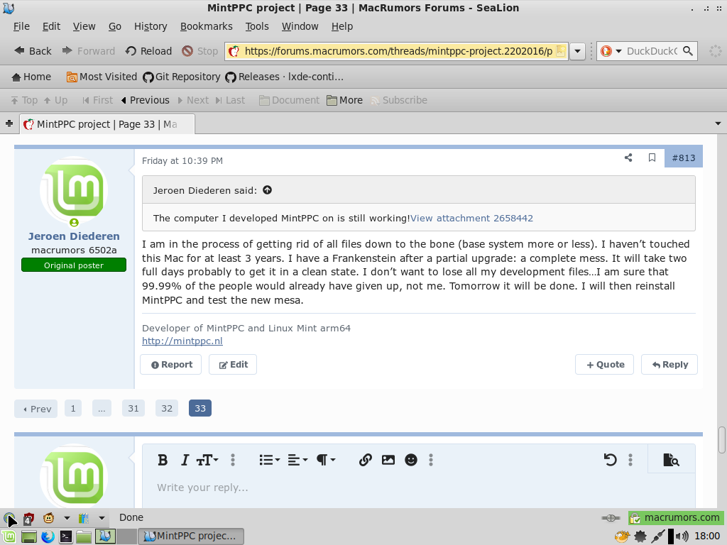

I am in the process of getting rid of all files down to the bone (base system more or less). I haven’t touched this Mac for at least 3 years. I have a Frankenstein after a partial upgrade: a complete mess. It will take two full days probably to get it in a clean state. I don’t want to lose all my development files…I am sure that 99.99% of the people would already have given up, not me. Tomorrow it will be done. I will then reinstall MintPPC and test the new mesa.
Edit 6.9.2026: the system is clean after 3 days ...
