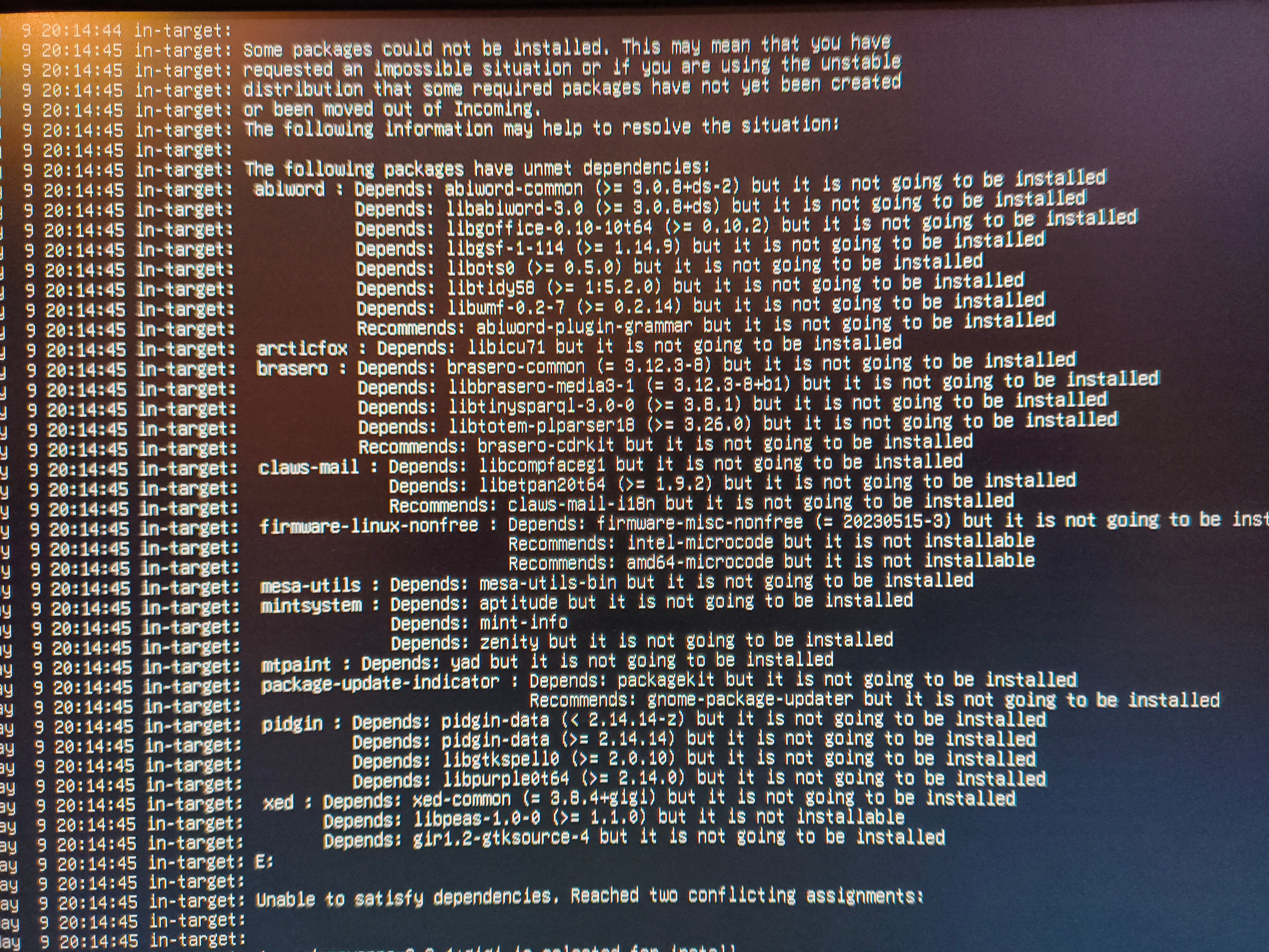

I performed my routine monthly verification install, this time with MintPPC32. There's a problem with some dependencies, as shown in the picture. The installation can be continued, and after completion, the system works. I tested it on a MDD dual, 2GB, a Radeon 9100 128MB, and a SIIG SC-SA4M12.
Thanks, I will look into it myself and fix it hopefully.
I see the problem already: libpeas1.0-0 is no longer available in sid. I will add it to the repo. This also applies to MintPPC64.
A better solution, which I will try first, is to rebuild xed against the newer libpeas1.0-1.
Xed is selected for install as it is Linux Mint’s lightweight text editor. I like this program very much.
