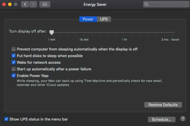

According to (the LCD of) my UPS (#20), my MM2018 (i5/8/256) still draws about 10W when asleep, whereas my monitor hardly anything when asleep. With these settings:
What have others 'measured' ?
Or does can you only really put the MM itself asleep with 'apple symbol' (where did that go in Mojave?) > Sleep ?
On my older MMs the above screen would allow you to set the timer for Computer to as well (it had two sliders).

The settings that you posted are going to make your Mac go to sleep after 1 minute (I learned that just now, I really didn't know where the sleep schedule/timer went and I just tested it to answer you). If you want it not to sleep when the display goes to sleep, just select the first checkbox that says "Prevent computer from sleeping automatically when the display is off".

I had to disable Power Nap at my Mac Mini.
With Power Nap it did not really sleep, still consumed almost 20 Watts constantly (together with several external devices, 3 screens etc.) and heated up to more than 46°C - because the fan did not run.
I have made tons of measurements and documentation about my tests and the result was: I had to turn off Power Nap AND change from a USB-C Hub to USB 3.1 Hub (both have made probs with sleep).
