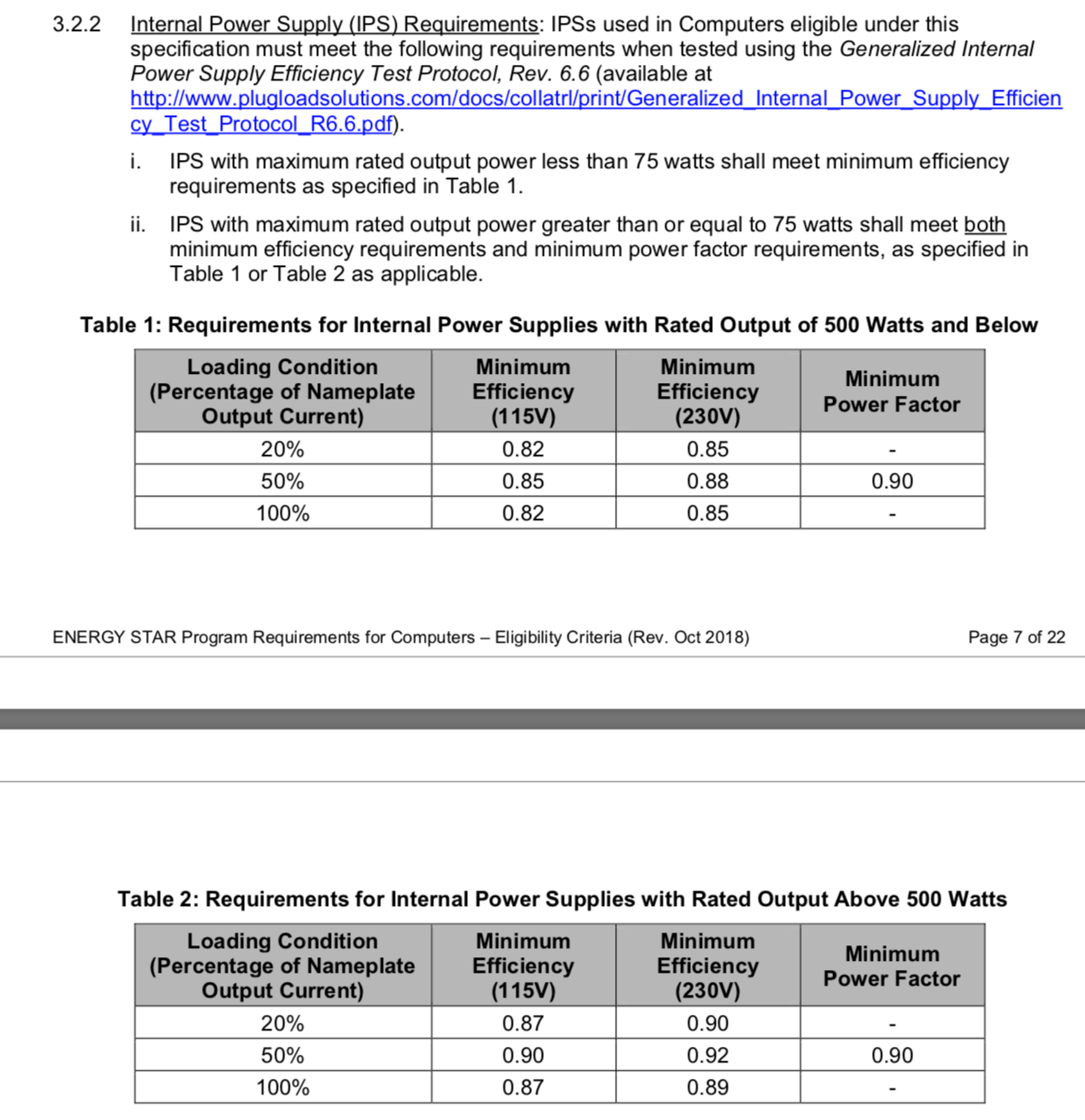

MM2018 has Energy Star 7: https://ww2.epeat.net/criteriadisplay.aspx?productid=17493&epeatcountryid=1&category=5
So for the 150W PSU of the Mac mini we can assume efficiency as well as Power Factor of 90+ %

I have to assume the MM2018 has an Active PFC PSU.

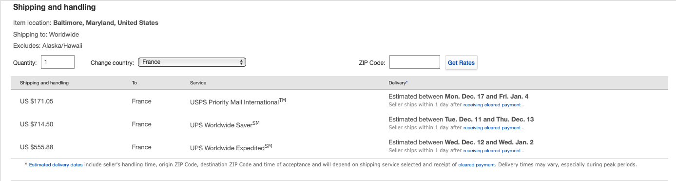

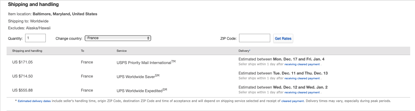

The ebay seller's shipping rates to France are shown in the photo below.
Merde 🙂
Reactions: strawbale
Merde 🙂
