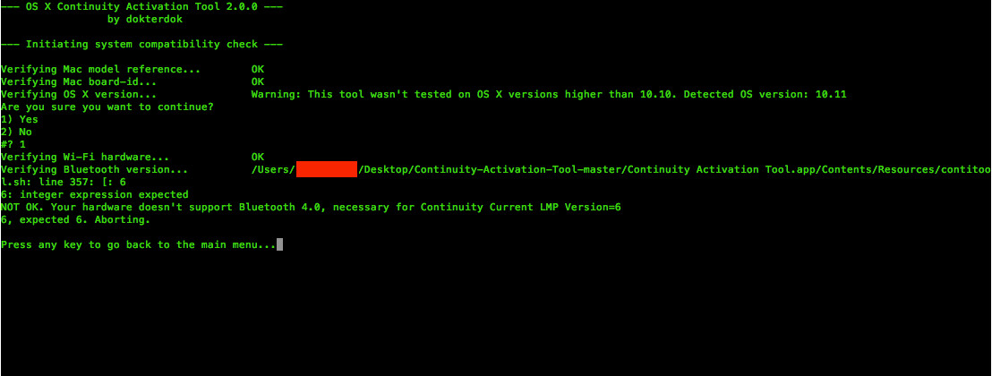

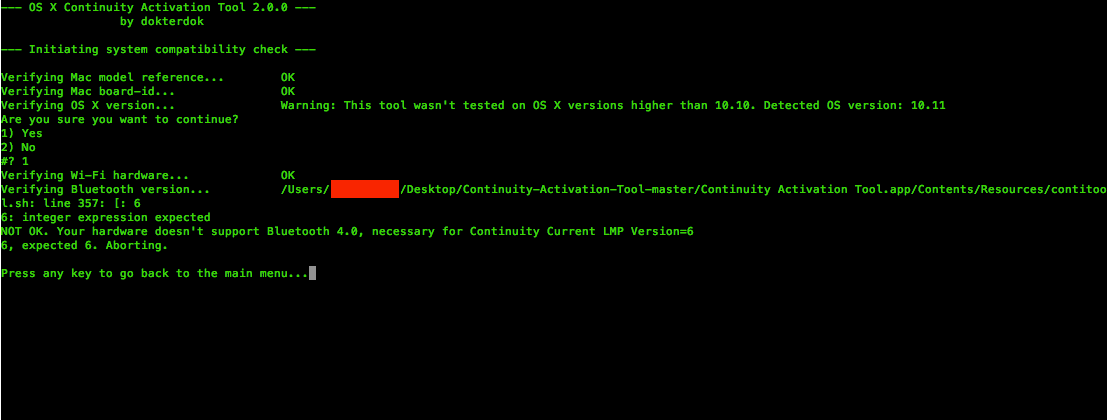

i did as u suggested i ran the command sudo nvram boot-args="rootless=0" in terminal then deleted IO80211Family.kext and IOBluetoothFamily.kext from System/Library/Extensions and ran the tool still got the error
running this tool on early 2011 MBP with the hardware upgrade which is still working on Yosemite partition

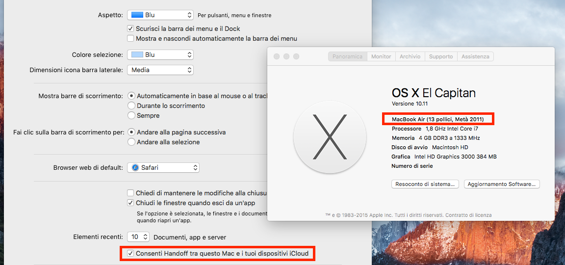

yeah! it works on MBA mid 2011
