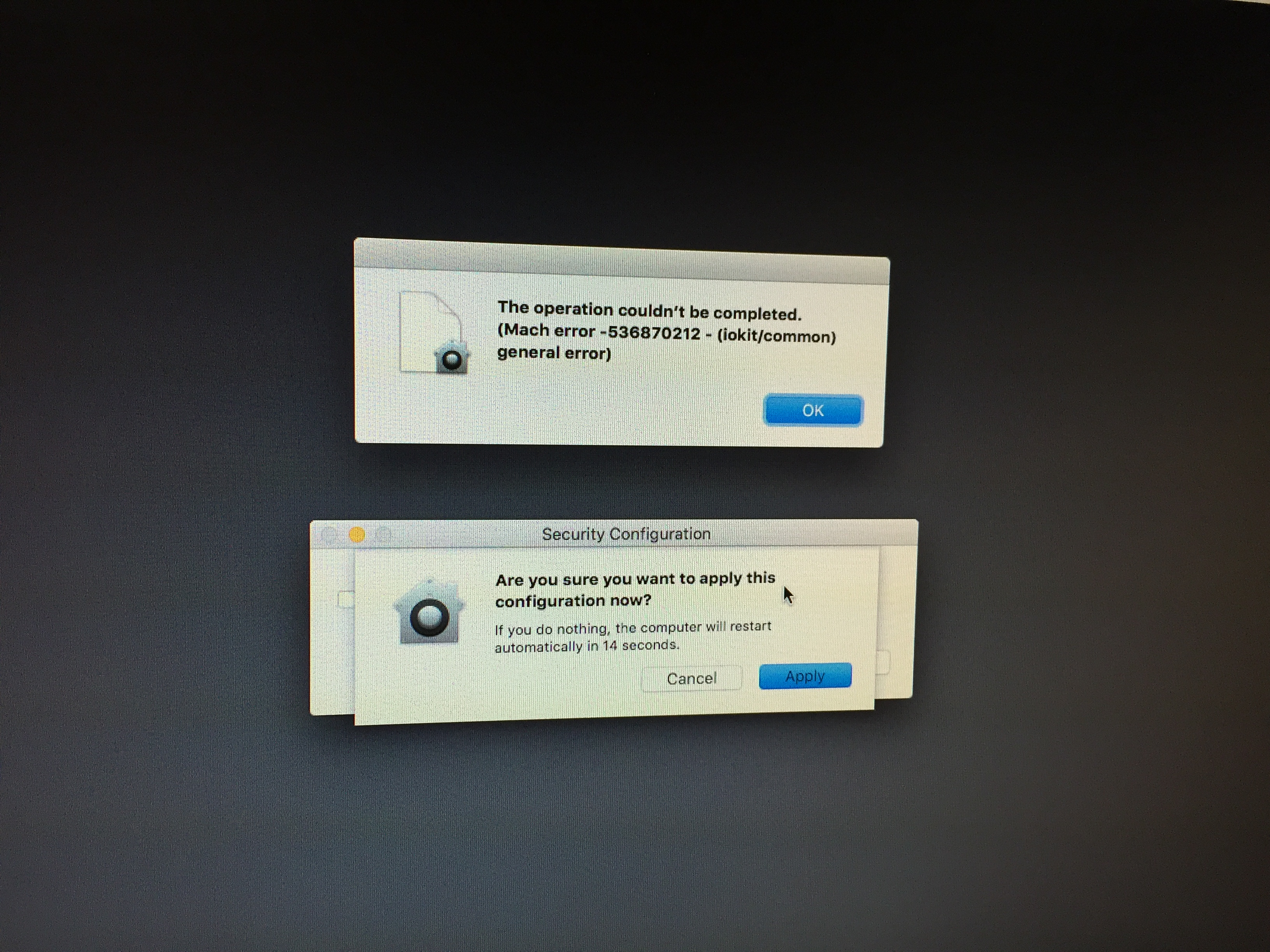

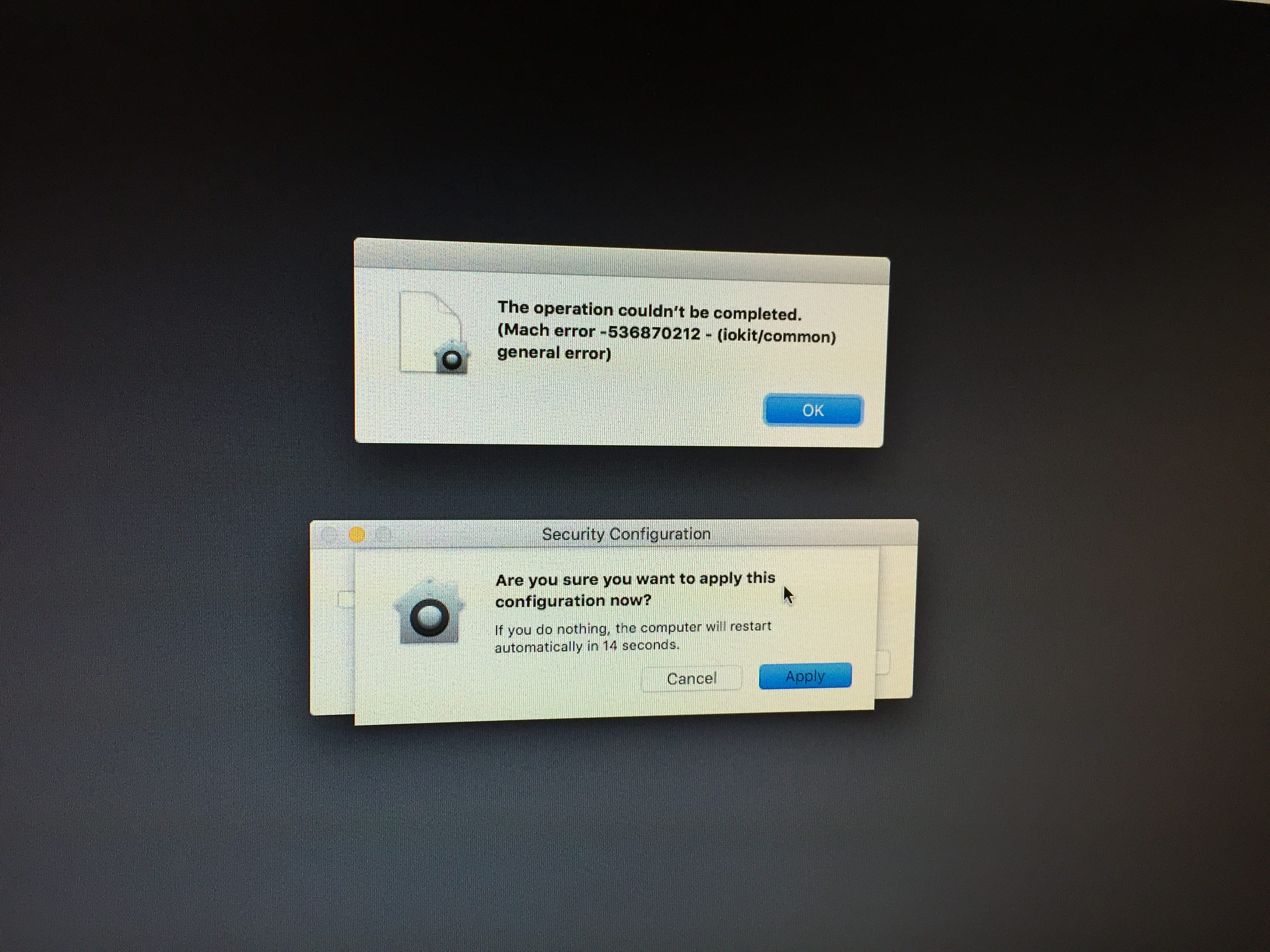

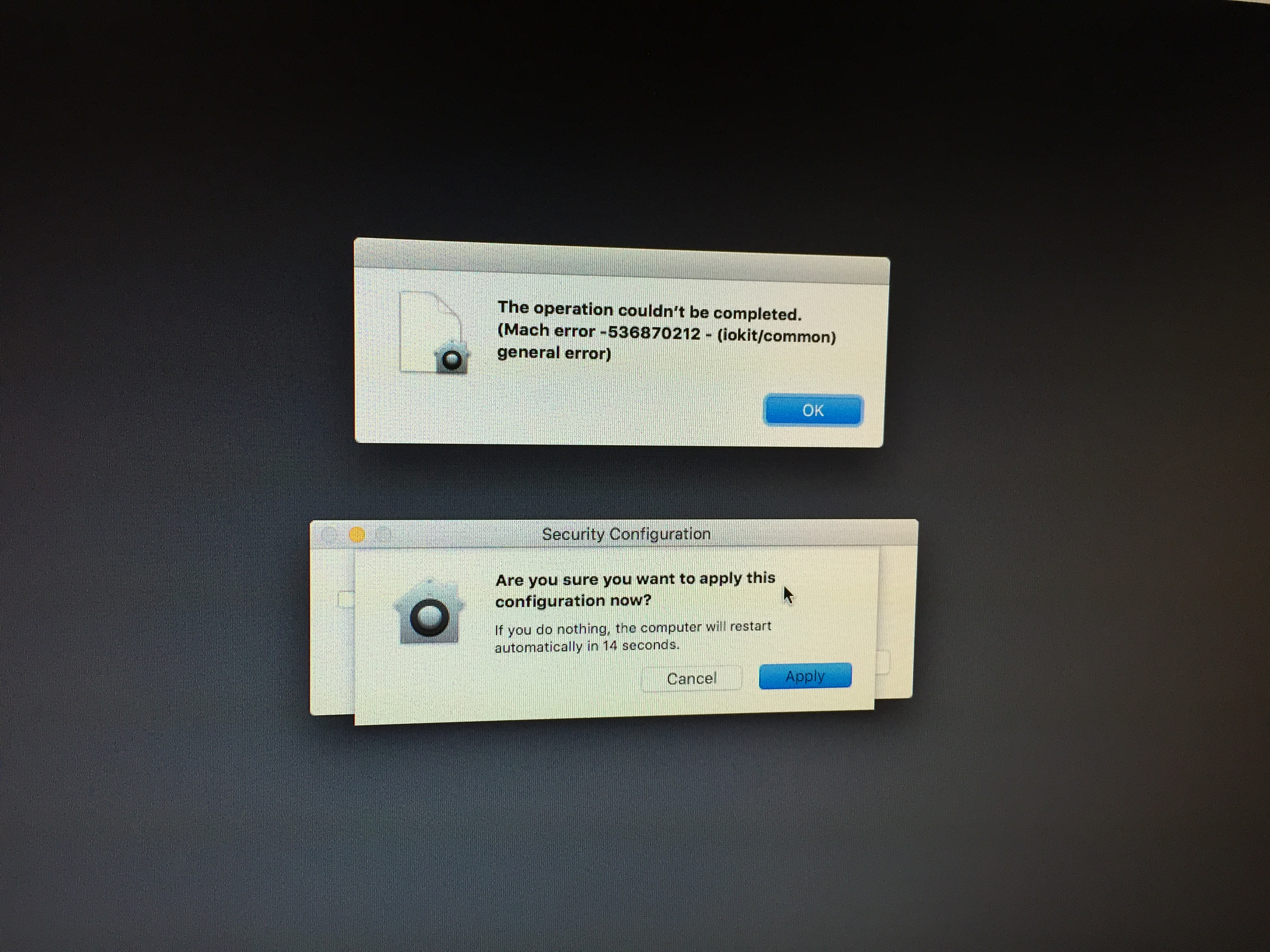

Getting this when I try to turn off SIP in recovery, has anyone seen this and know how to get around it? Thanks!
Me too on 13" mid 2011 MacBook Air
That's the same computer as mine and the one giving me this problem.
Did you disable SIP in recovery or just use the tool straight ahead? In case you did the recovery thing, did you see this problem?
