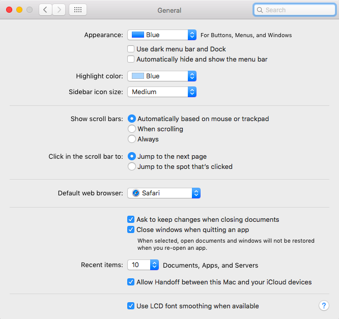

Im using a mid 2011 macbook air and i got the check box to show up under system prefs>general but its still not working.
Did you log out of iCloud on your Mac, reboot, and then log back in? Sometimes, it takes logging out of Mac and iPhone and back in, for it to start working. I had to do that twice before Airdrop showed and then Handoff. Some people running the El Capitan DP 1 have reported that they couldn't get handoff to work. Whether they had upgraded cards or stock machines, I don't recall.
