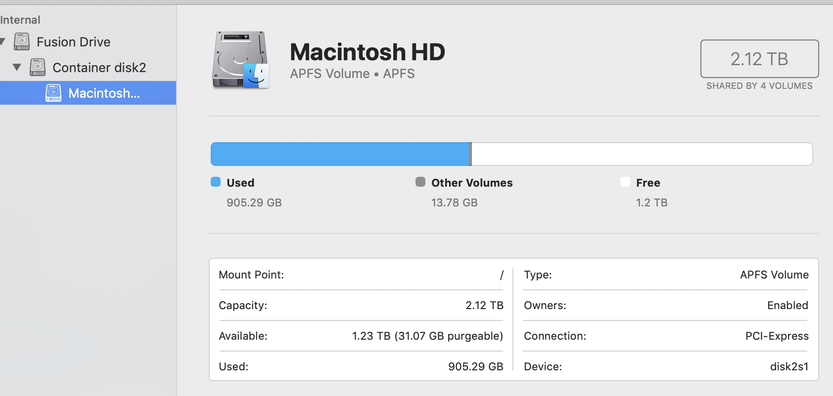

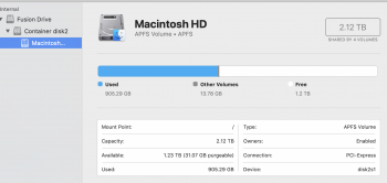

Works fine for me, 2017 iMac 2TB Fusion. Startups are quick as is launching apps. No problems. Using about half of the capacity. Running Mojave 10.14 beta (18A365a)

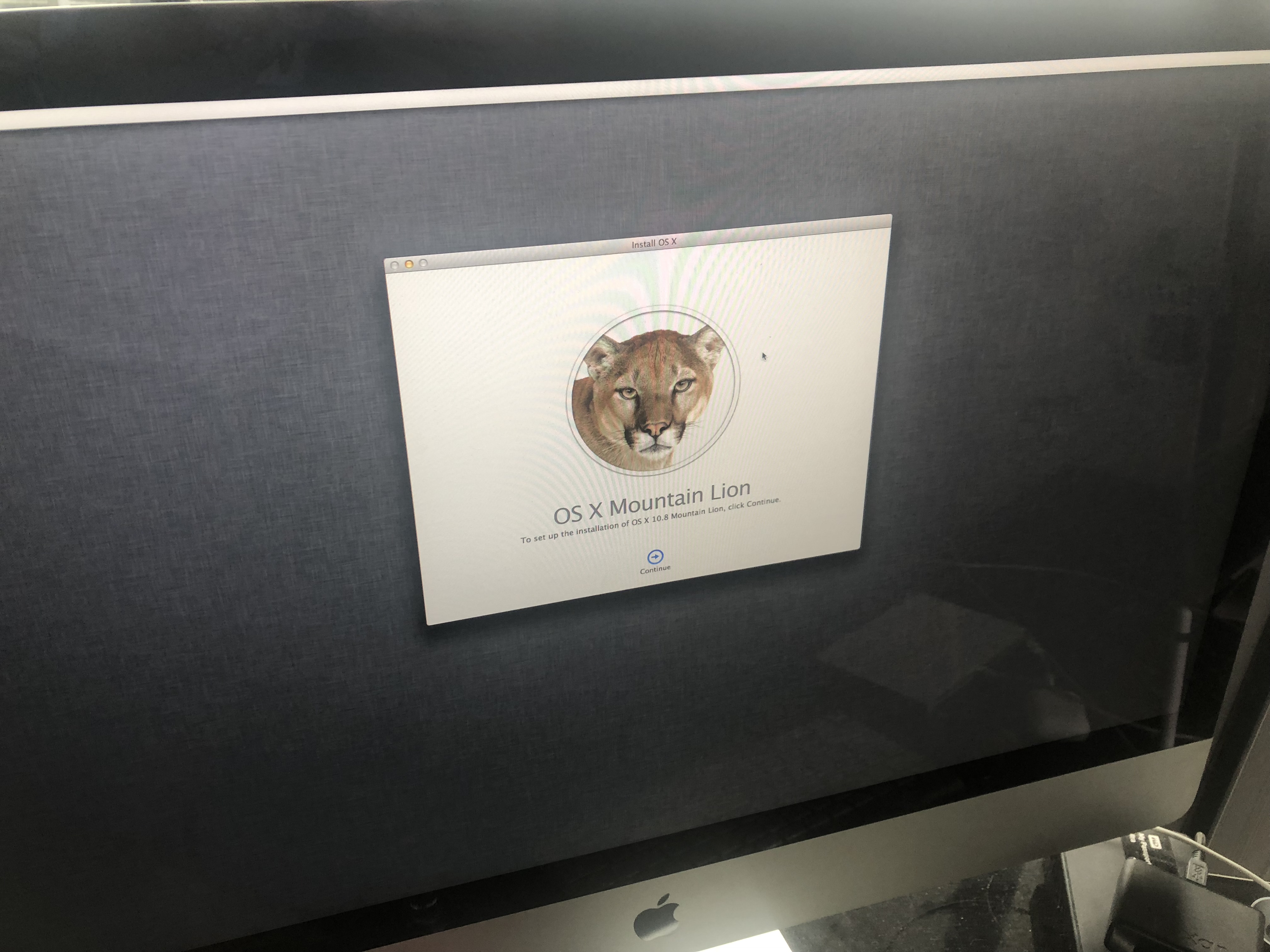

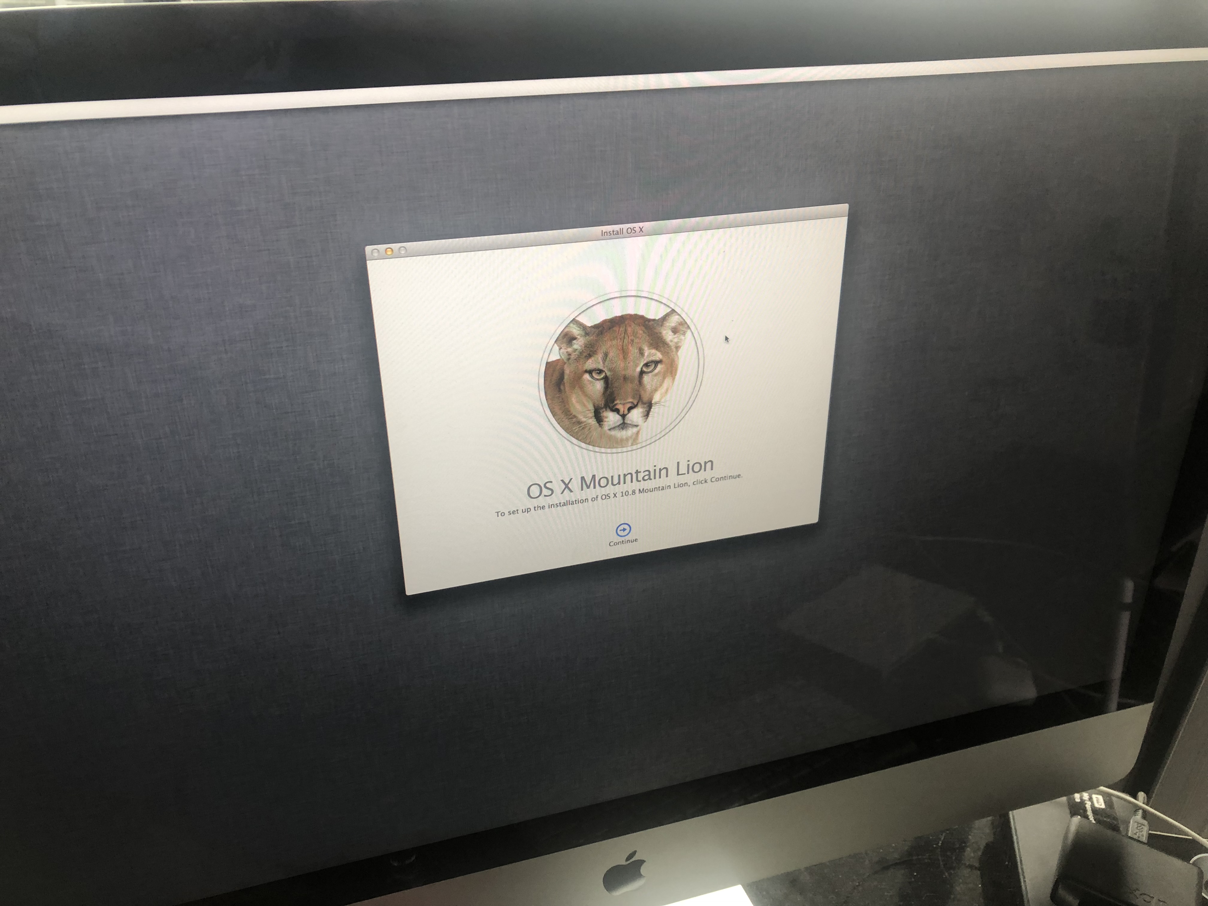

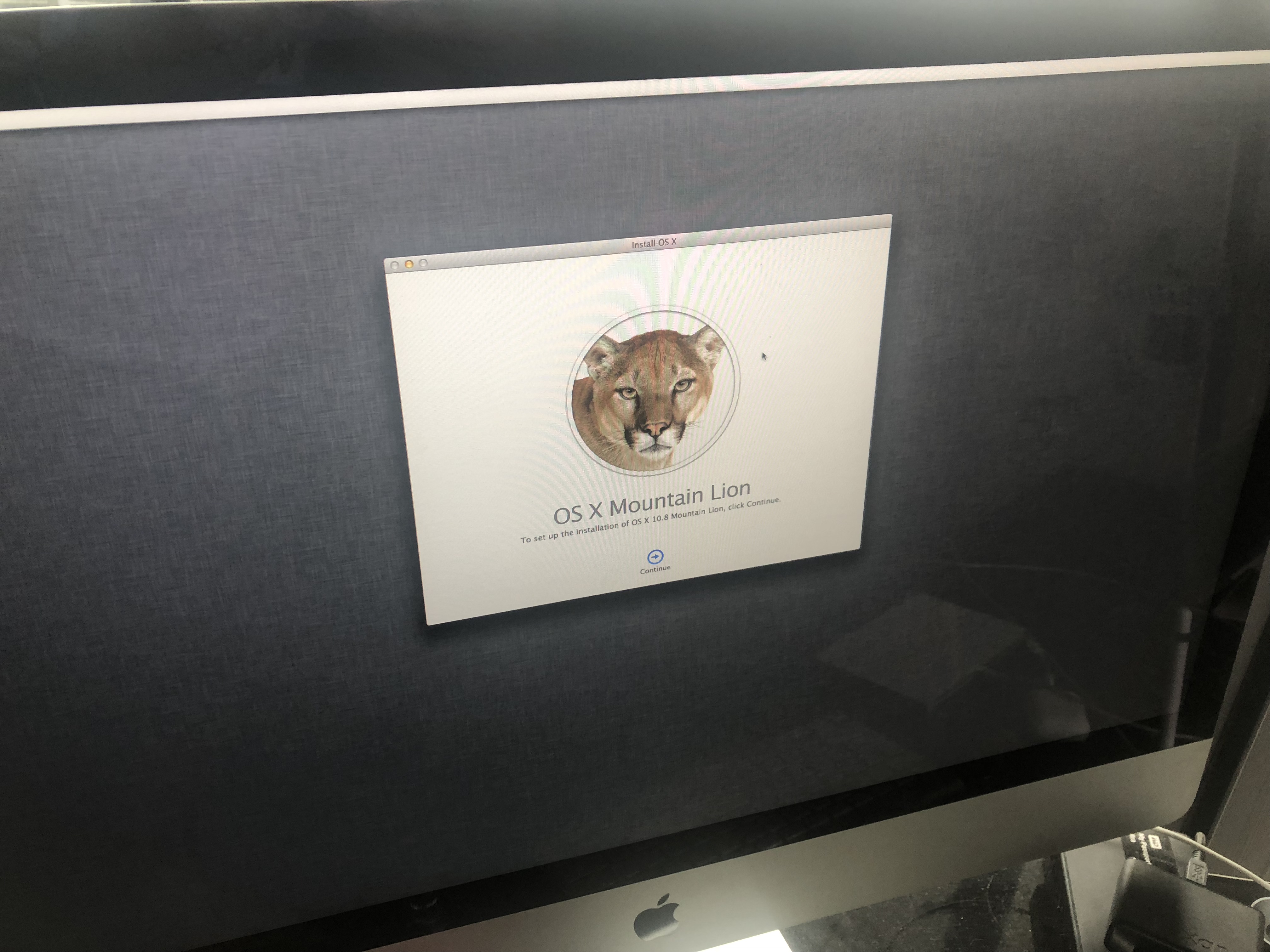

[doublepost=1534613455][/doublepost]... further adventures:
This came up...
Haha. Wow. Lion. I hadn’t seen that fabric background in a while (what’s up Forstall!). Eventually, I got it to boot up into my Mojave USB installer.
But it turns out High Sierra did quite the number to my Fusion Drive. Mojave insists that the drive has S.M.A.R.T. Errors and refuses to install on that drive. I know the drive is fine because Lion seemed to have no problem going ahead with the installation.
High Sierra messed up the tables and other sub structure on the drive.
Ultimately, I was able to fix the situation by converting to HFS and back to APFS which would rewrite all the tables. Mojave’s Disk Utility seems to have cleanly formatted a Fusion Drive into APFS and fixed the drive’s structure.
Mojave is installing (finally).
