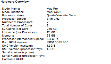

[doublepost=1522424403][/doublepost]
Installed the firmware, I’ll boot with other disk to check the version.

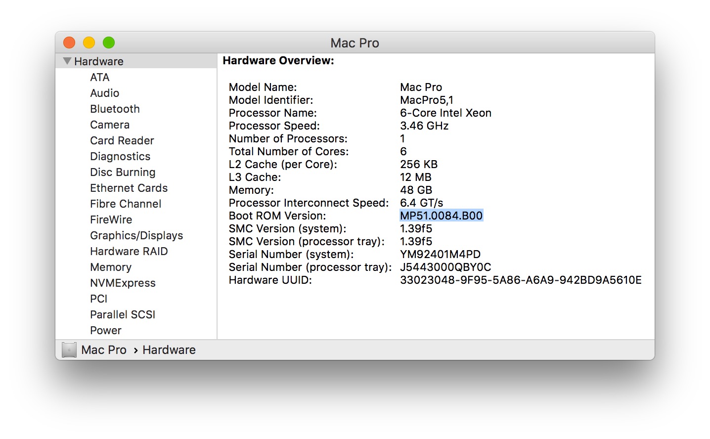

Confirmed there is a firmware update. My current firmware is MP51.0084.B00.
May be this is the reason why my appstore update failed. (I am now running with a non-flashed 1080Ti.
Reactions: m4v3r1ck

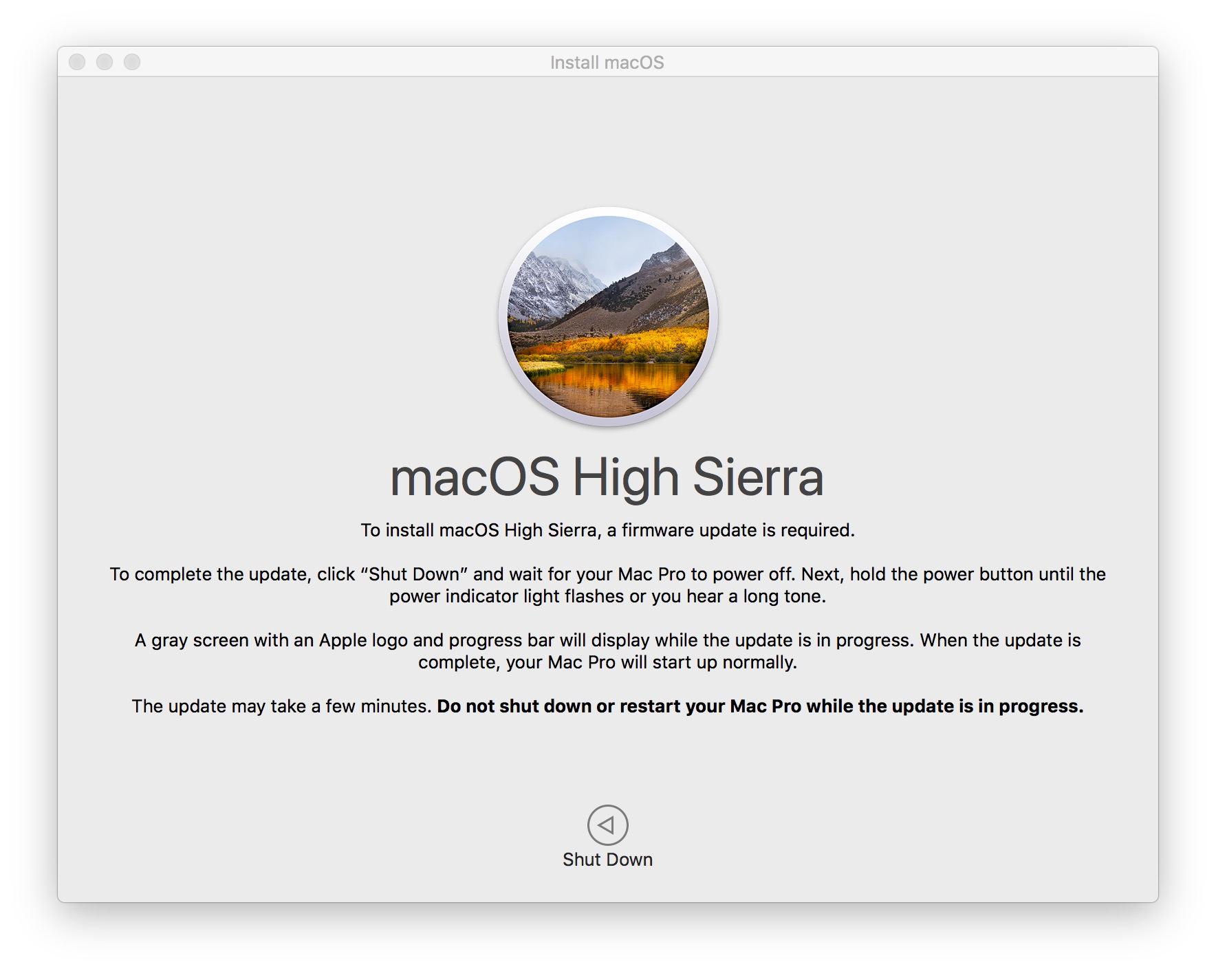

indeed theres a new Firmware update with 10.13.4 I wonder what it brings? im going to boot into windows in a Bit and check if they updated the Microcode to patch spectre/meltdown
interestingly I did the 10.13.4 update via the MAS and it did not prompt me to update the BootROM at any point, but downloading a full 10.13.4 installer and opening it, prompted me to update my BootROM before allowing me to continue.
Reactions: GuiPol

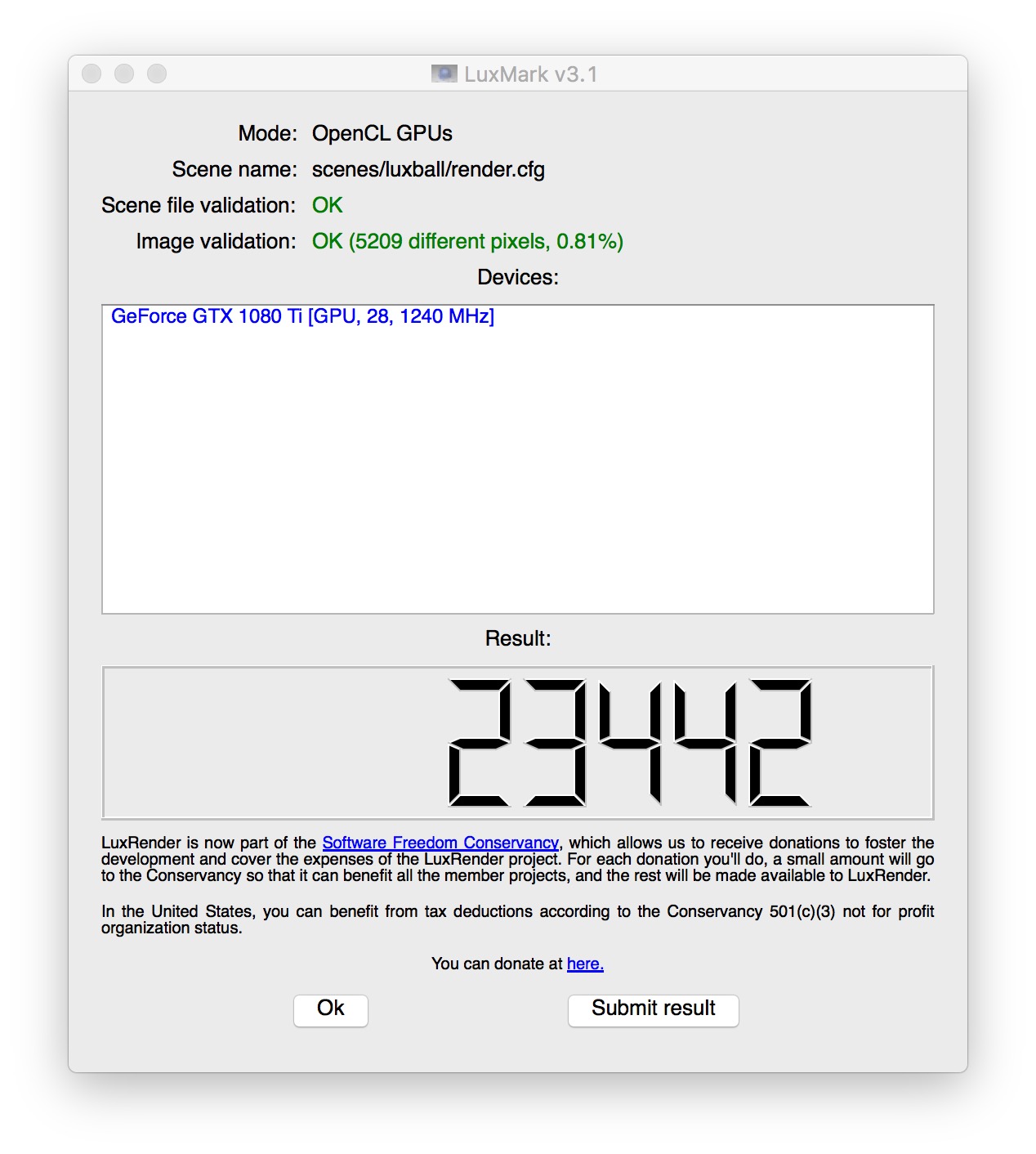

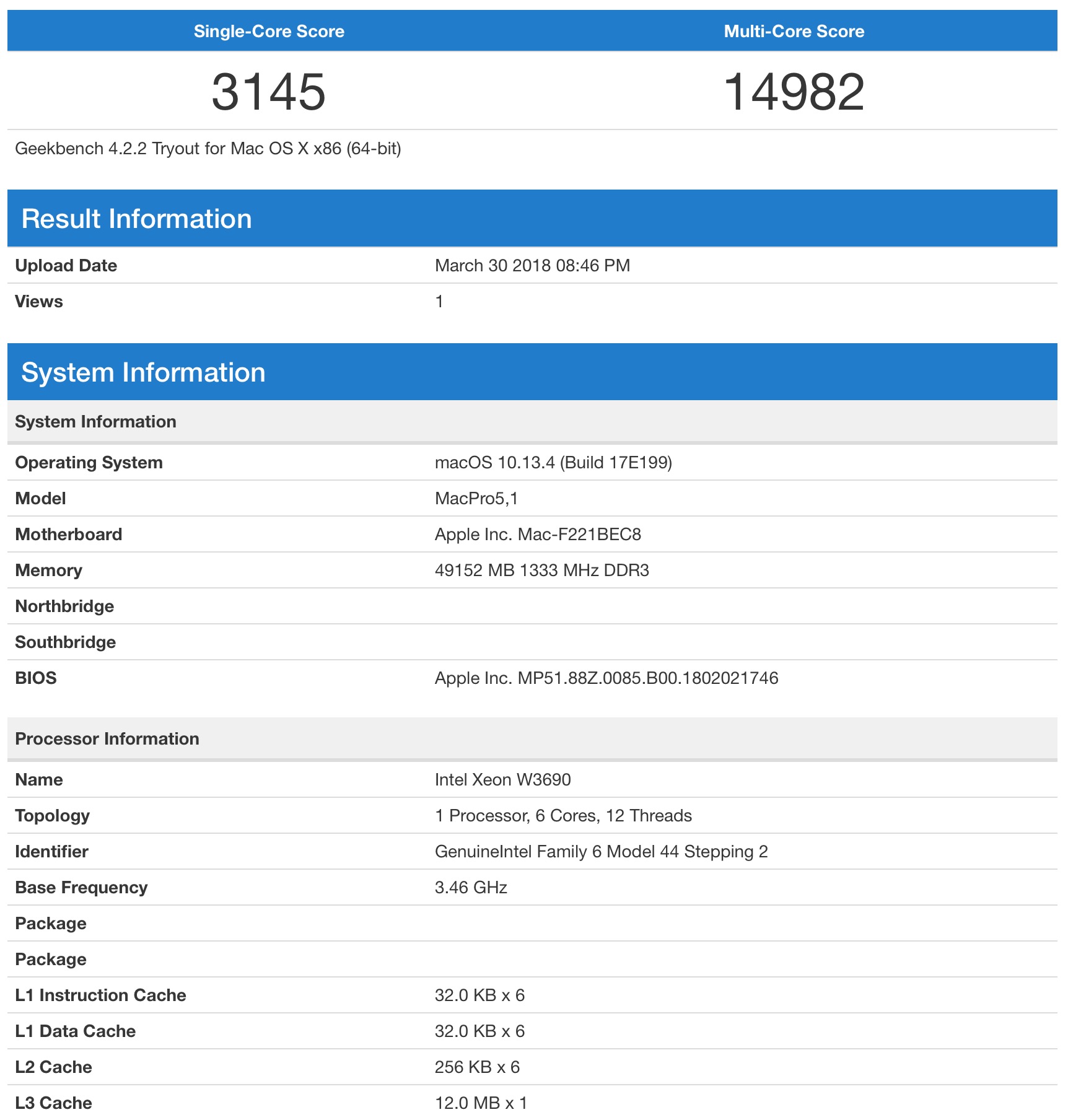

Any benchmark differences with new FW?
...Geekbench CPU scores before and after?
h9826790
macrumors P6
Apr 3, 2014
16,650
8,574
Hong Kong
I will say no performance hit. My computer was not 100% idle when running this GB4, I can clearly see the time machine backup in progress. So, the multi cores performance may be tiny bit lower than the max we can see. But this tiny difference should be well within normal error zone. So, my personal conclusion is no performance hit for both CPU and GPU.
