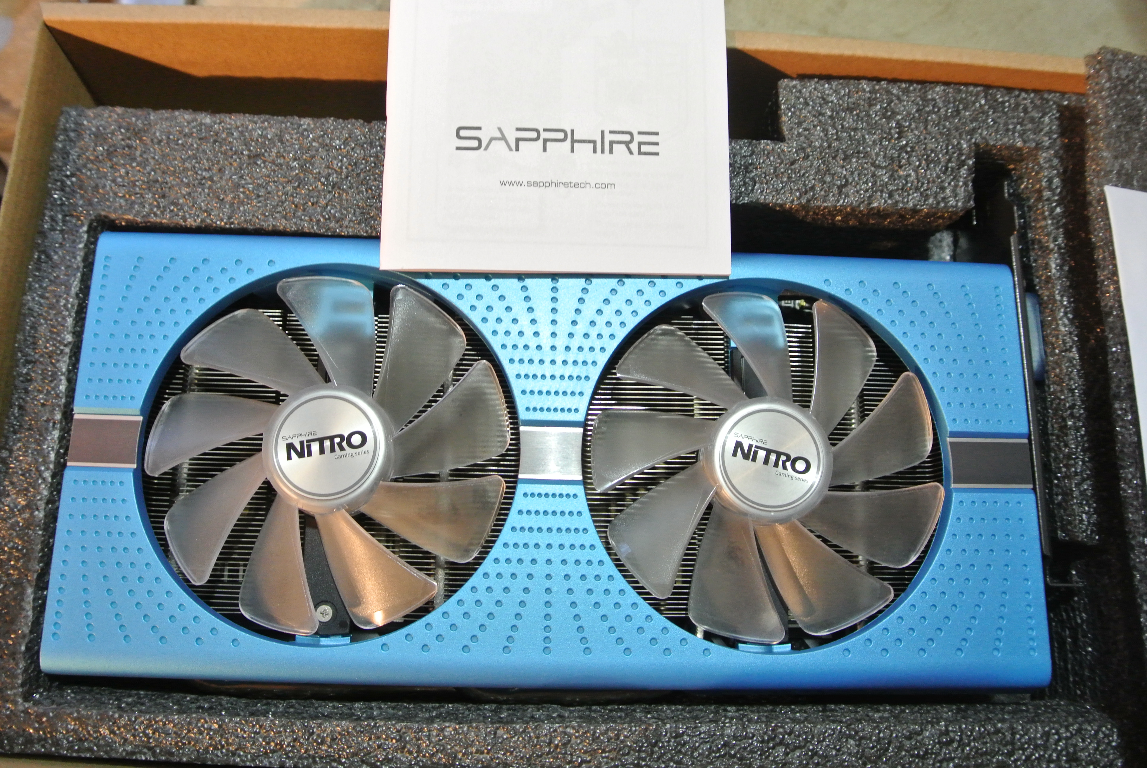

I have a MacPro5,1 with an "official" white Sapphire 7950 Mac Edition installed. I'm 99% sure (without opening the case to confirm) that the jumper is set for Mac mode. Will I be able to install 10.13.4 without having to swap the original card back in? Seems like it but then I read stuff like pinchu71's upstream post and I wonder ...
That's the card I originally wanted bc I like the look of it. I wound up with this one instead, and still waiting for the dual mini 6 pin to 8 pin adapter connector wire to come from ebay.

I just did same upgrade to OS X 13.6 and held the Power button. That was only a few hours ago, so I can't help you with any history of problems yet. (hopefully NEVER LOL). I have the Optane 900P SSD , on a PCIe, and trying to get it running. That's why I am here now. I just upgraded my CPU today too. I went with the X5690 3.46Mhz. That is on my other 5,1 2010 Mac Pro which will also be getting the rx580 Radeon Sapphire graphics card (pictured) when the dual power jumper wire arrives from ebay next week. Then I will be upgrading to OS X Mojave. I read recently that the Sapphire cards give a much better video experience, so I am excited to get it installed ASAP! BTW, I am typing this on a 2012 iMac 27". I get my info/instructions on the iMac and do the upgrades tinkering on the Mac Pro. How do you like the 7950 so far?
Everything seems to be ok but, when I shut down last night I noticed a few pixels on the screen acting a bit strange. I run some Benchmarks to make sure everything was going well. My plan is to install the Rx580 Pulse on the machine. Already got it but I need to get an adapter for the Display Port since the Rx580 doesn't needs a HDMI or DVI.
