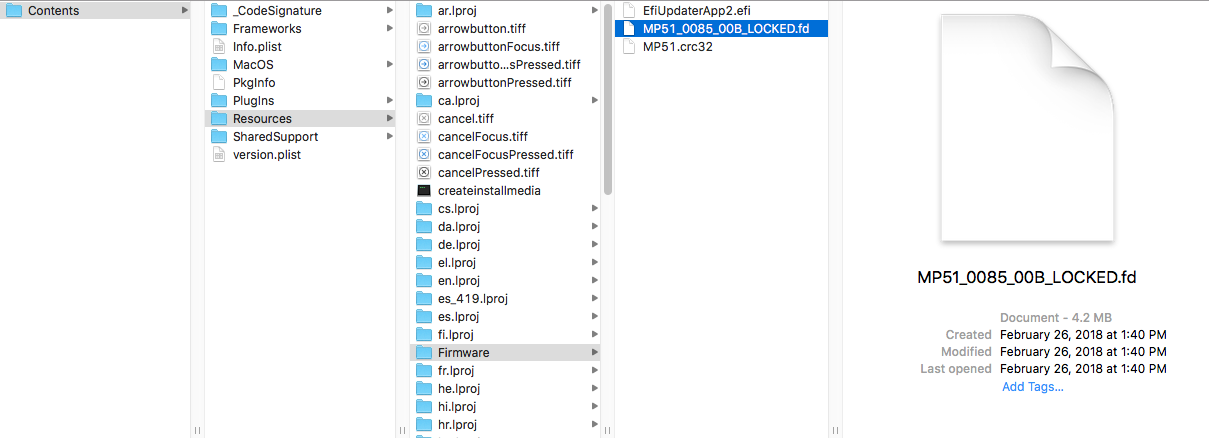

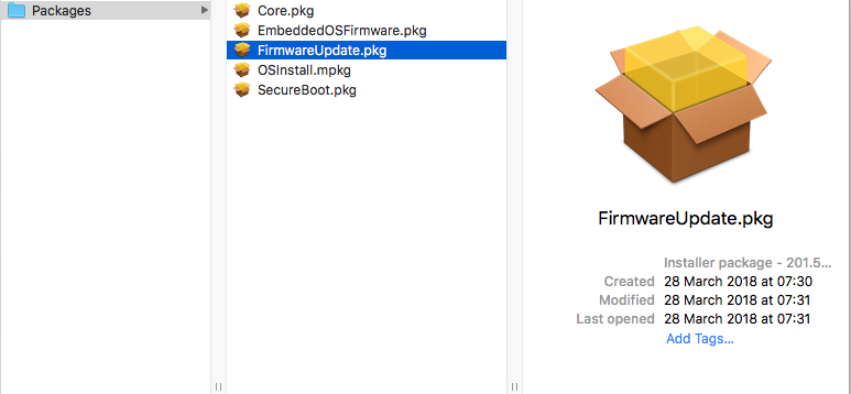

Is there a way to extract the firmware update from the installation package ? To avoid loading the whole thing just for updating the firmware ?
Wrong folder. Drill down into Shared Support and mount InstallESD>PackagesThis is probably what you'd be looking for:
Contents > Resources > Firmware > MP51_0085_00B_LOCKED.fd
I'm not aware of any GUI that can directly load this. Would recommend most people just use the Apple installer with an EFI card.
