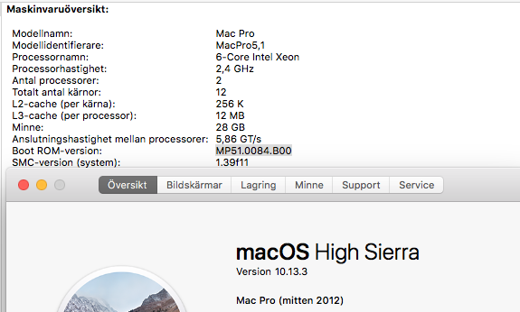

Can just confirm that I have HS 10.13.3 and the Firmware MP51.0084.B00. And have so for a while. So I have not updated my OS.
/Per

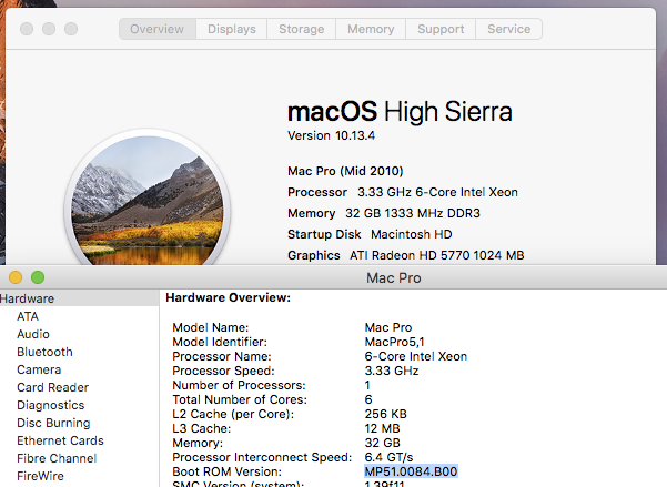

Should means virtually nothing. You should still able to run the 10.13.4 full installer to get the firmware update.
Decided to go for it. IDK, if, it's just me, but, I always get nervous when doing FW/BIOS updates. LOL!
But, everything seems fine. RX 460 still works and sleep still works. Phew!
So, what did it do? Someone mentioned microcode... how do you check the microcode anyway?
