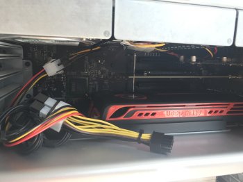

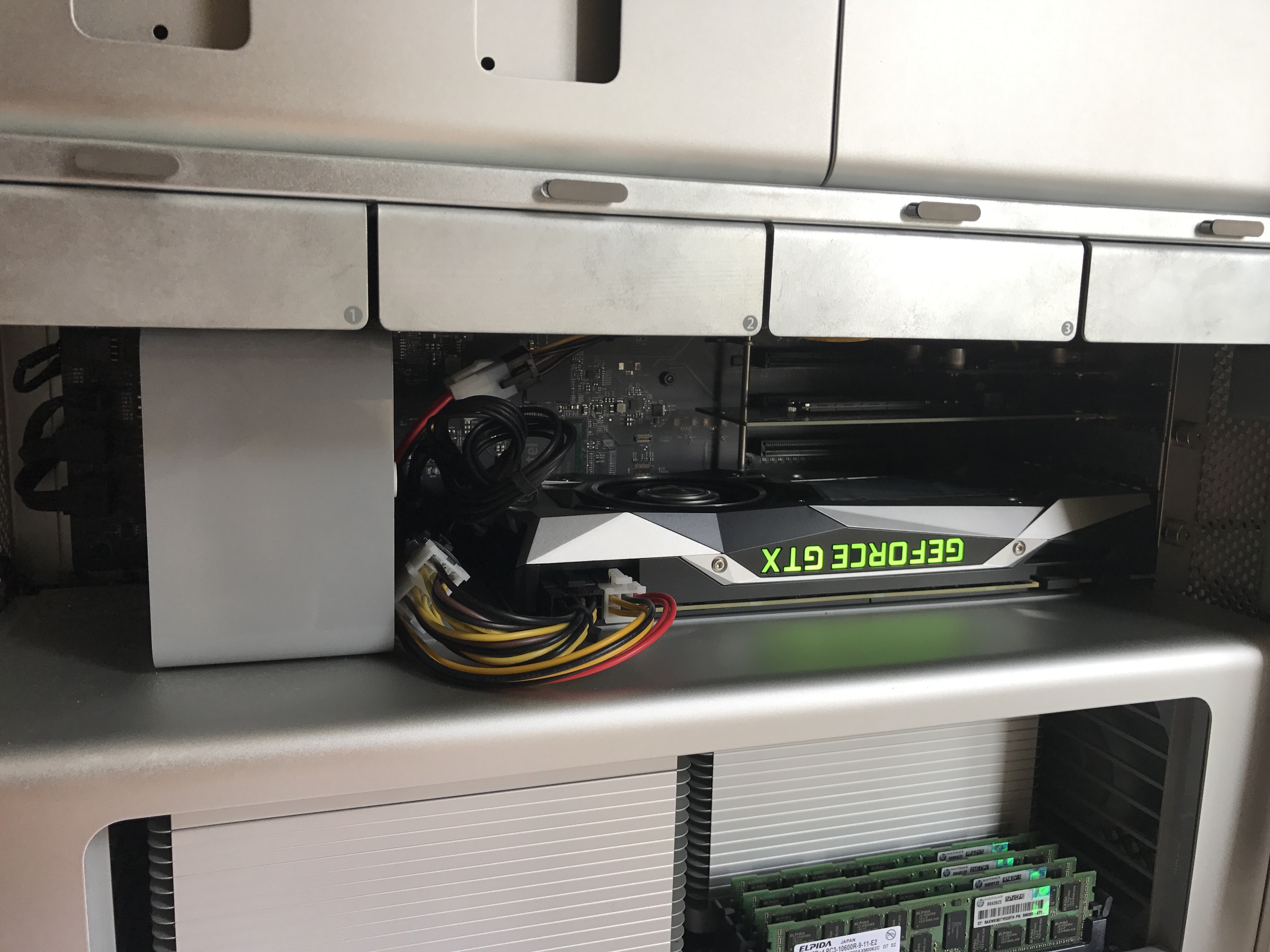

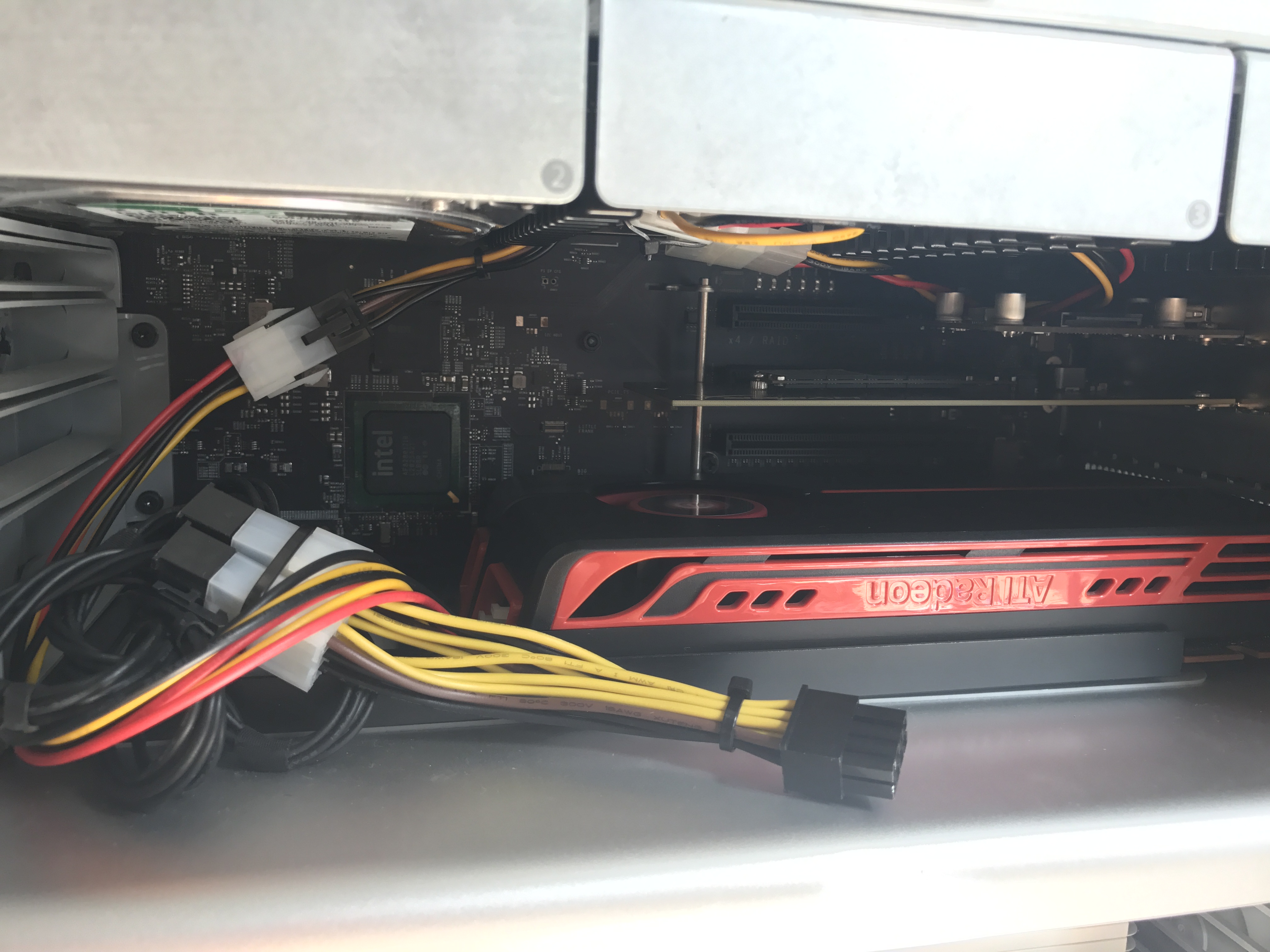

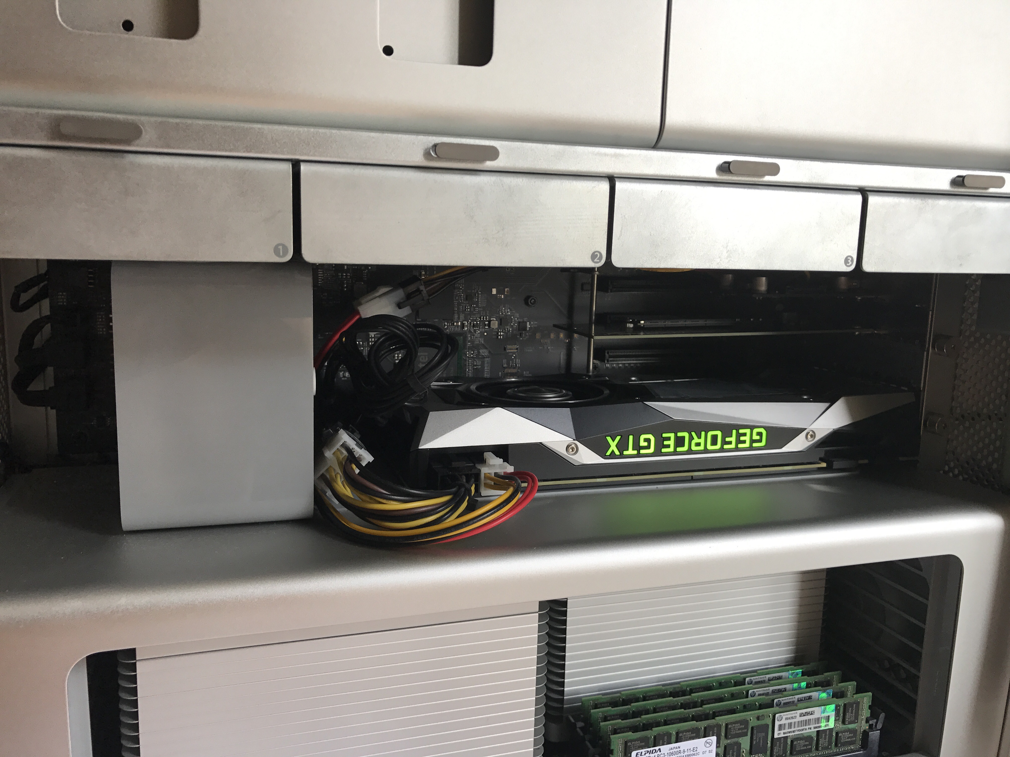

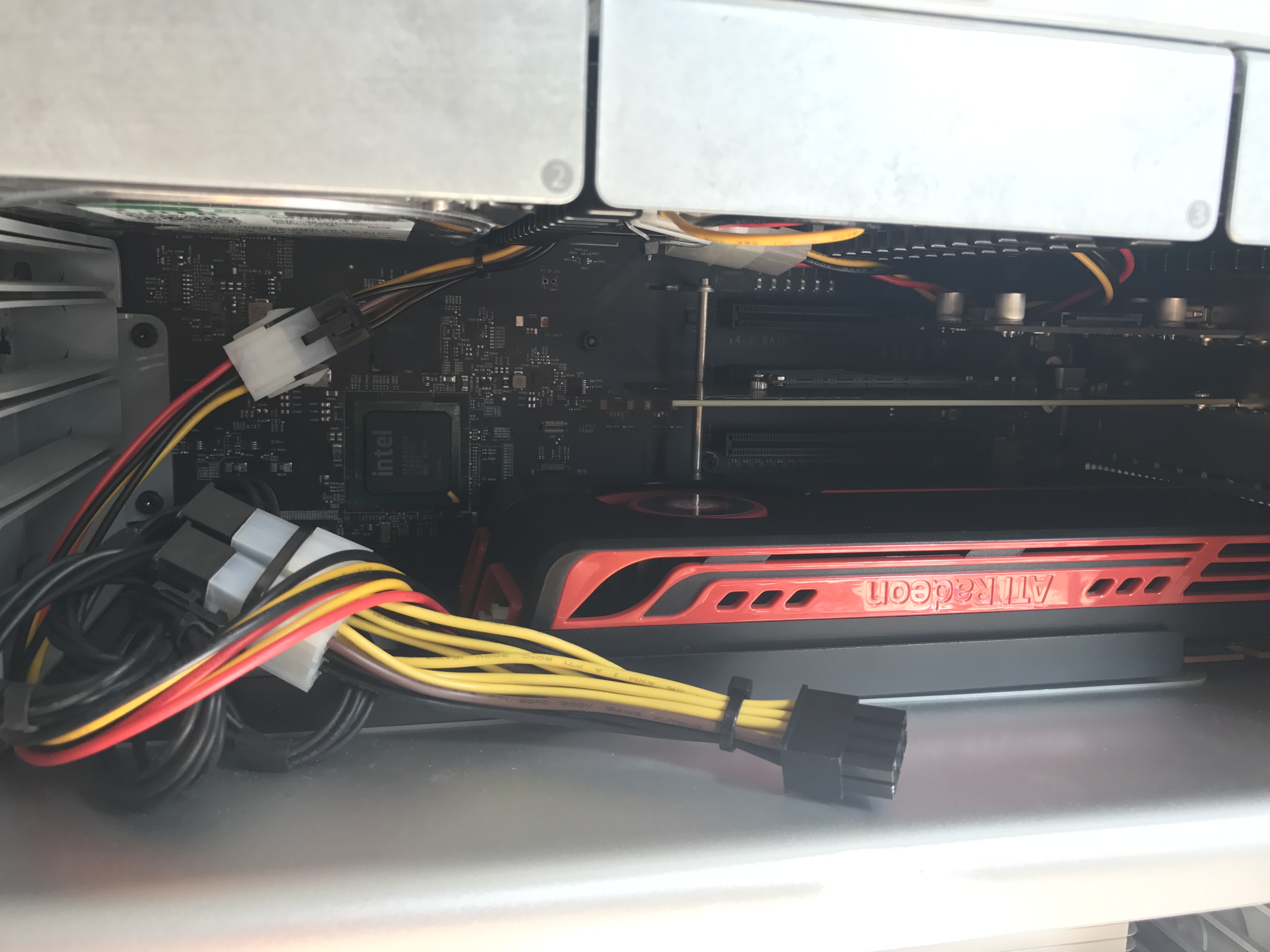

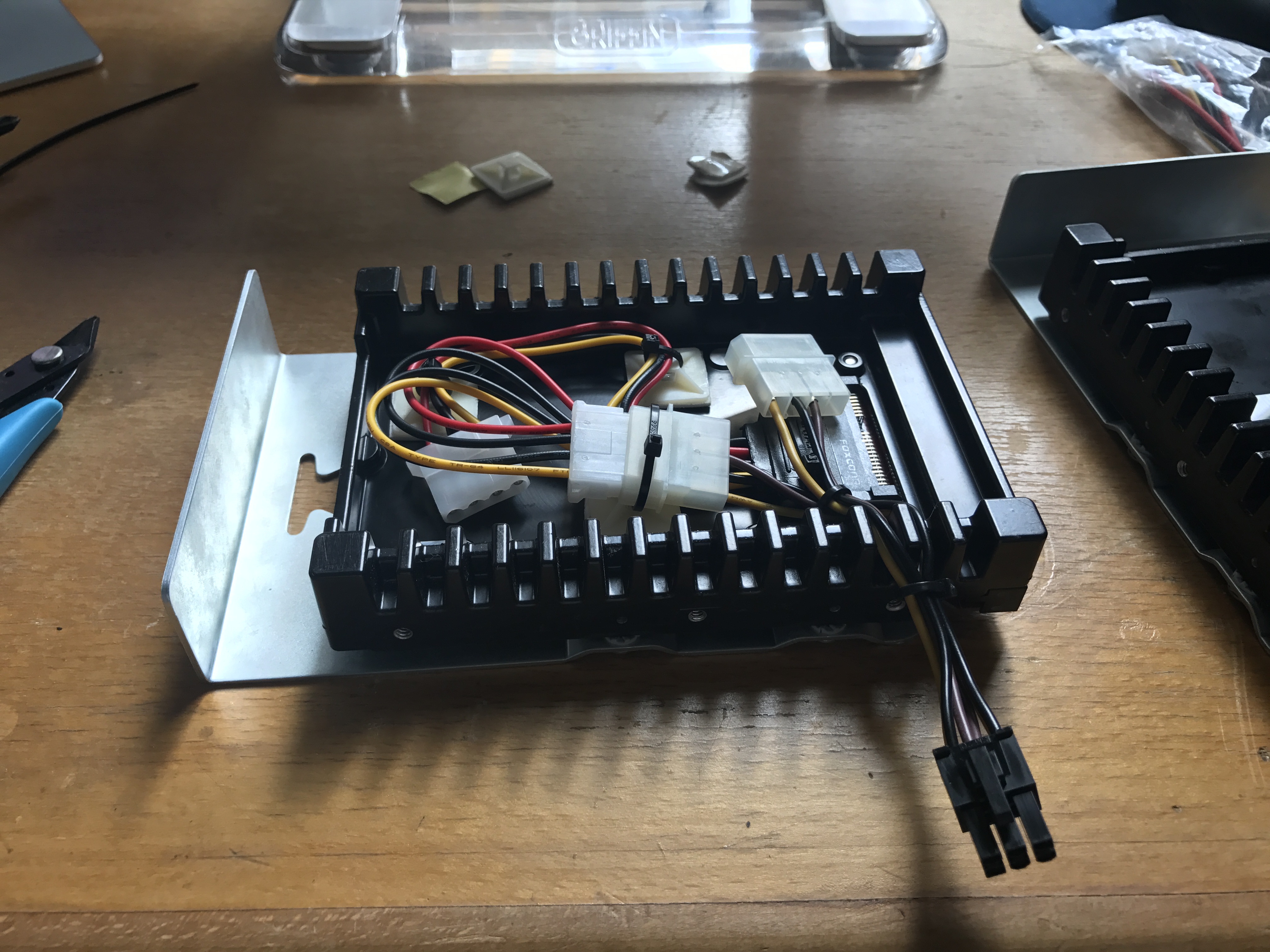

I want to try 2 sata to 6pin and original dual 6 pin to 8pin to drive my new comming 1080Ti... It is PC asus FE edition as I want to work with a 120GT in slot 2 for boot screen.

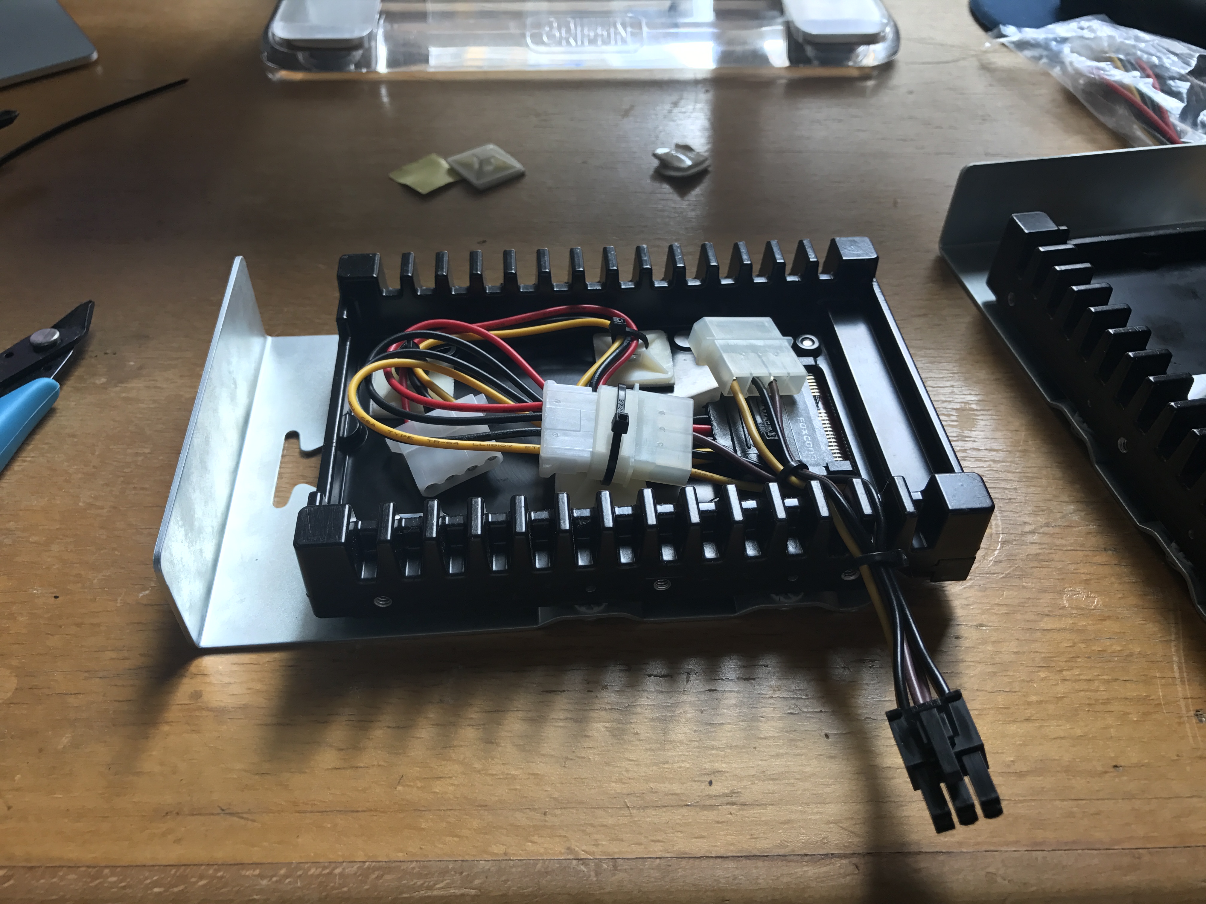

To do this project, i found if i can use a 2.5" hdd to 3.5" hdd mount to connect the SATA cable. It more firm as i just plug in mac pro stock sata power head beside, I also can do cable management inside.
Finally, fixed all stuff and plug the SATA to 6pin in my 5770 and tested half day.

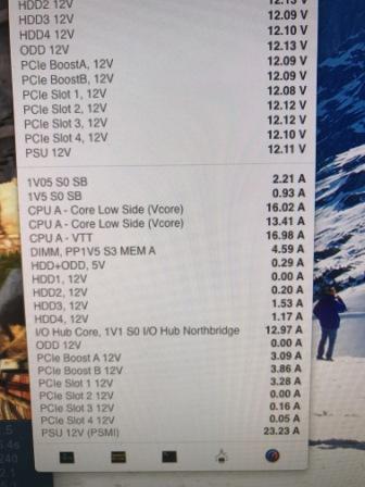

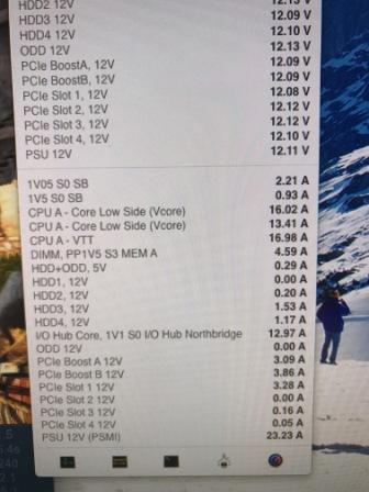

I have tried run some heavy test that i only see the current in HDD bay 3 is 1.45A and bay4 below 1A or 1.2xA. I believe may be 5770 is not serious then 5870 or comming 1080Ti. I will do more test tomorrow when I received the card Tomorrow. one thing is important ... less cable show out is a must!

As I have read all you guy share info and macvidcards, I believe the 8 pin will draw high current than mini 6pin can provide. The most safe method that I use 2x SATA power to drive a 6pin and group the mini 6pins to a 8pin. I started to build the config as above. The HDD mount I bought is WD as I think the electronics part will be more reliable. The SATA connectors are Foxcon! In HK, there is very hard to find and also a good quality cable.
as suggested:
6pin -> 2x SATA (should be 110W limit, but never seen on any official Apple document)
8pin -> 2x mini 6pin (official 150W limit, real world 240W absolute max, operational at 220W max)
PCIe slot (75W).
1080Ti is 250W (21A) max (PCIE 75W (6.25A) + 6->8Pin 150W (12.5A) is already 225W and I think 2x SATA (if safe we get 80% of it max) is 80W 6A enough to handle it~
Only one thing is unknow that how the 6pin share current from 2 SATA port.
I have tested yesterday, she always draw 1.2xA from HDD Bay3 and most the time 0.5xA to 1.2A from Bay 4 when i Connect to 5770 and full load it.
If it is work and stable, I will buy the mini 6pin to 8 pin cable from here to make the cabling easier:
https://www.moddiy.com/products/App...tandard-PCI%2dE-8%2dPin-Video-Card-Cable.html
For dual SATA to 6pin I will search a good quality one, if there is any suggestion, please let me know~

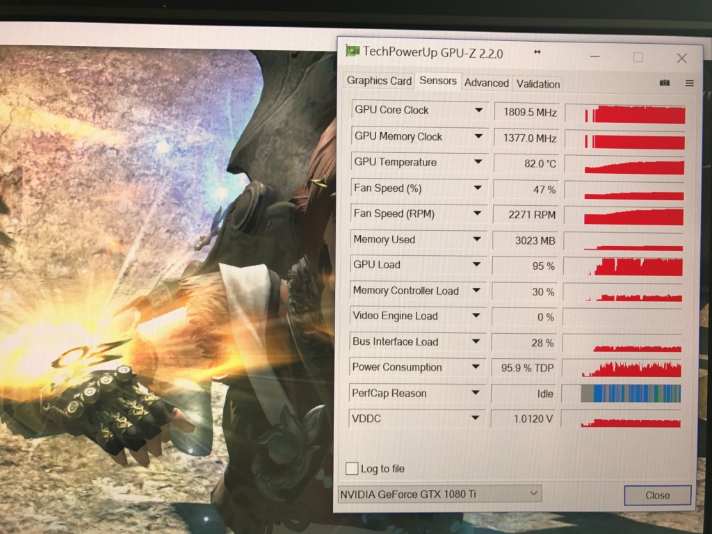

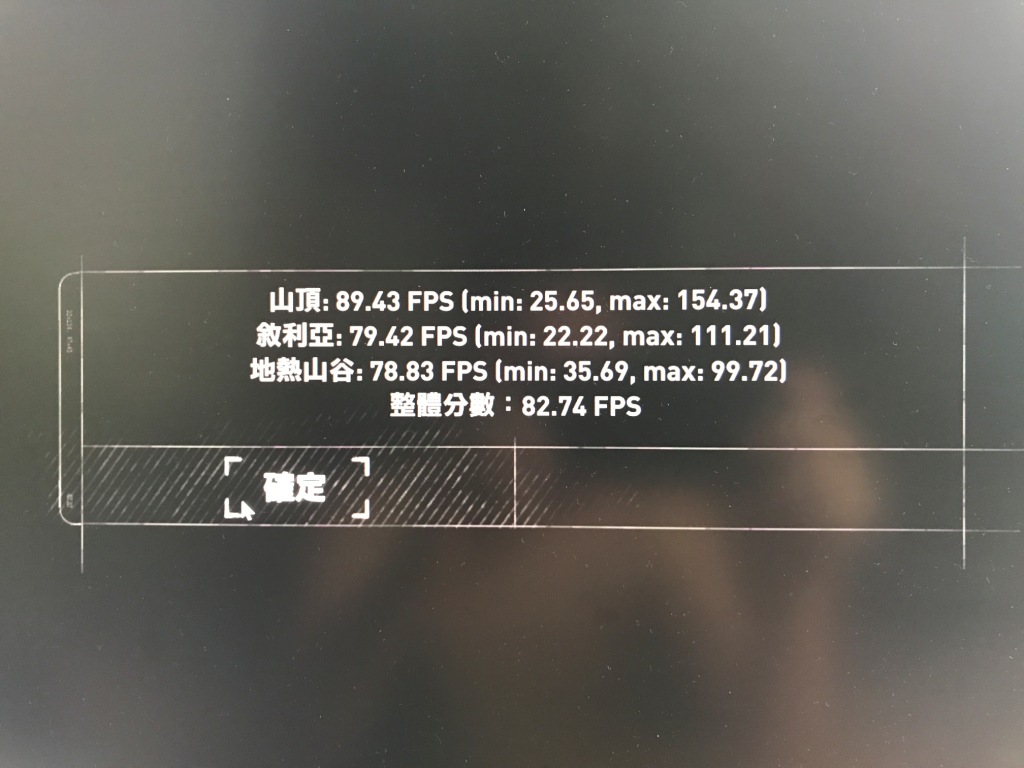

Actually, it is some different as my old 1080. of course 1080Ti is 30%+ performance than 1080. My main concern is the power setup enough?

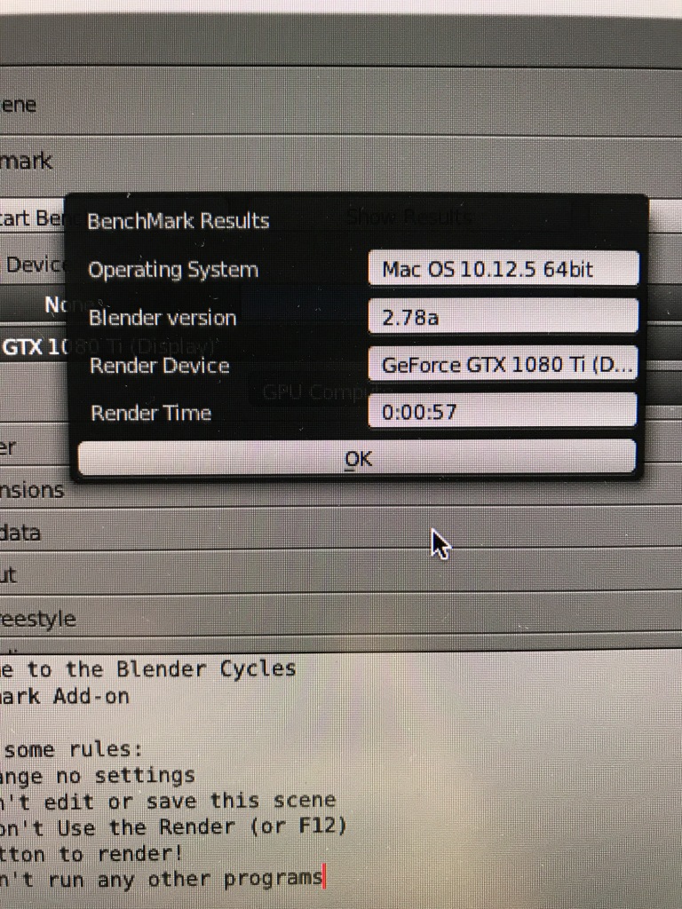

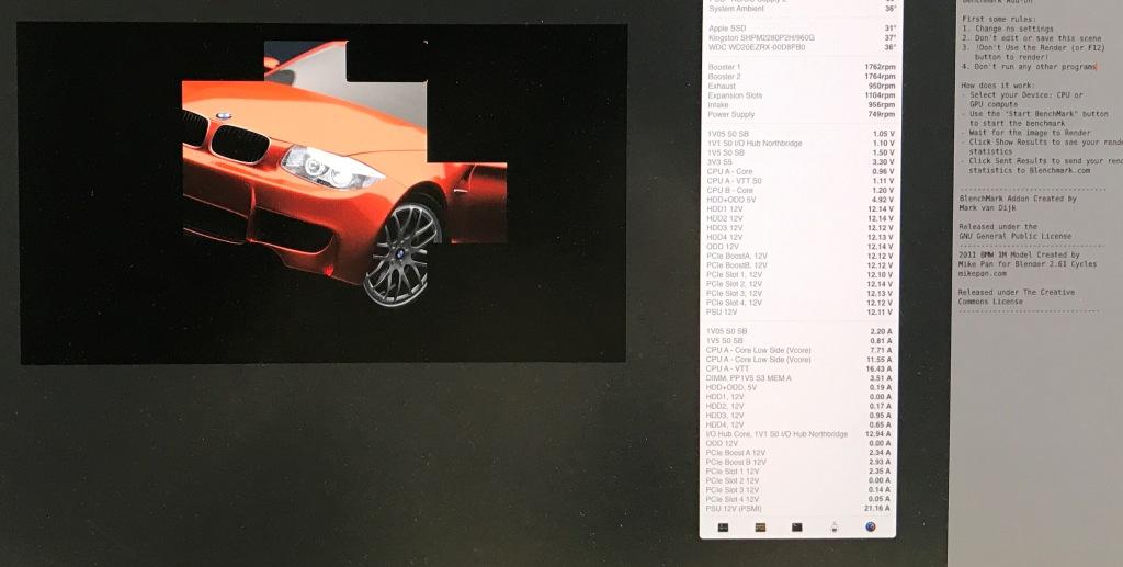

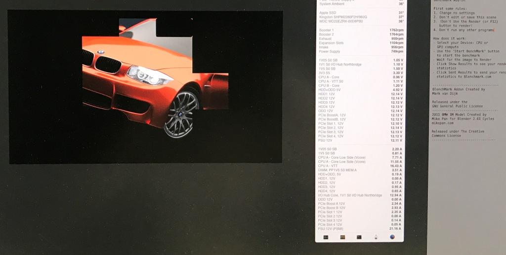

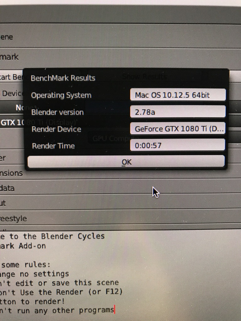

I tried Bender benchmark and it is crazy fast in CUDA part... and the current 6pin is mainly from bay 3but bay 4 also share. It normally below 2A but i have seen it will jump to 2.2A each for a very short time. For 6pin to 8pin side, it is mainly on PCIE power Booster B size is keeping in 3.xA.

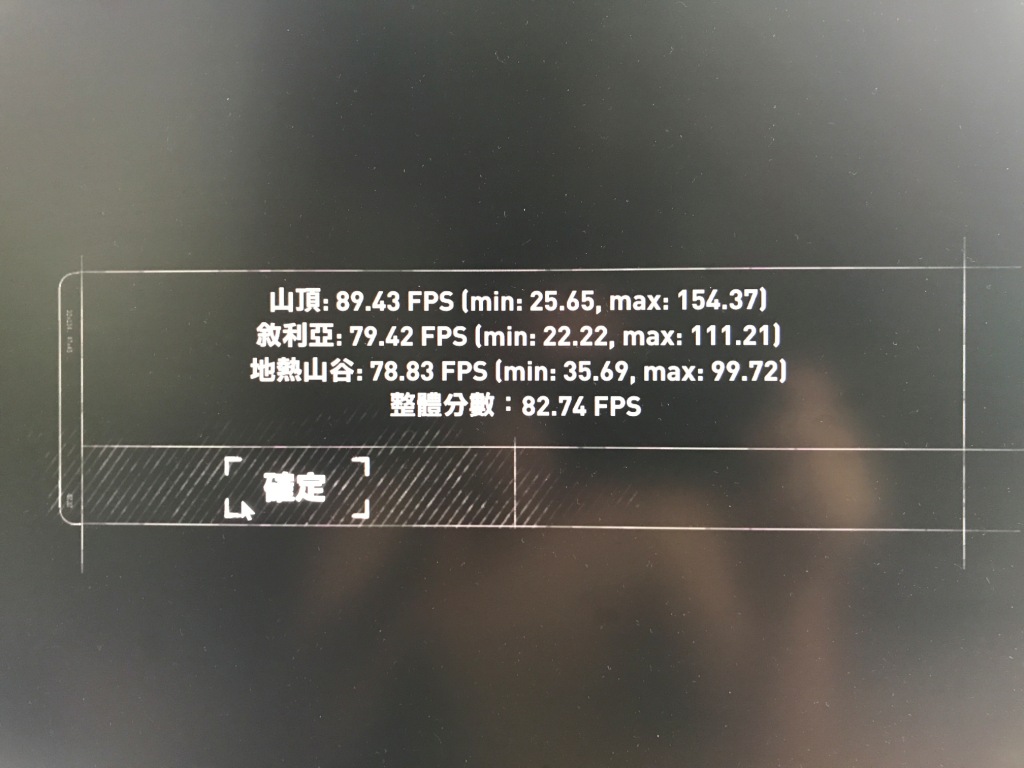

I also long running Unigine Heaven to see the current change. Unigine Heaven given a great pressure to 1080Ti and all PCIE and 8pin (2x6pin) keep 3.8A, all SATA is over 2A but it is very stable. I run the test and leave for hours, it is still stable, all cable and connect is normal.
I believe it is good if you connect the 2 SATA to prevent power drank issue of 1080 Ti. Tonight I also will get the EVGA power link to addin.
