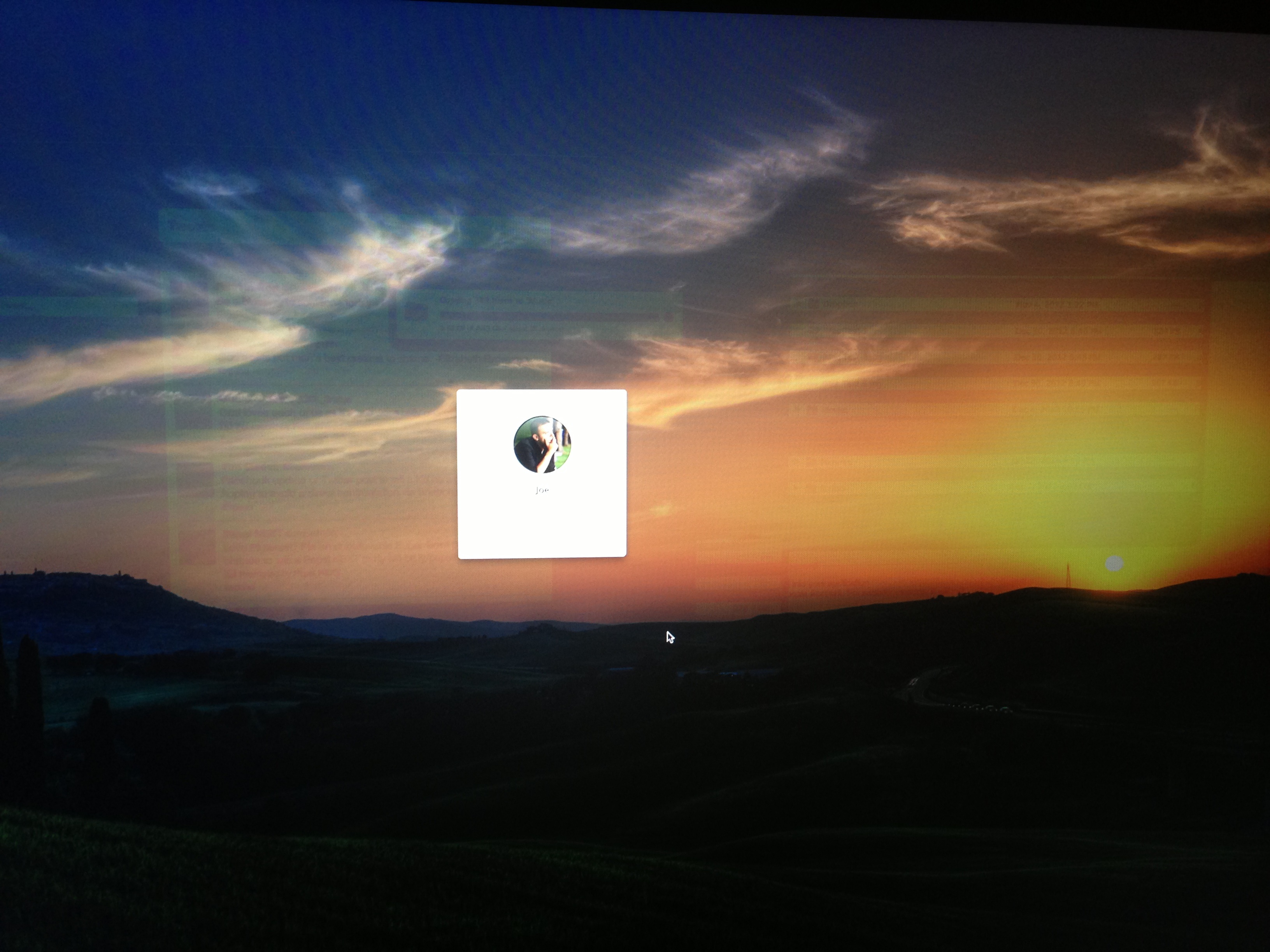

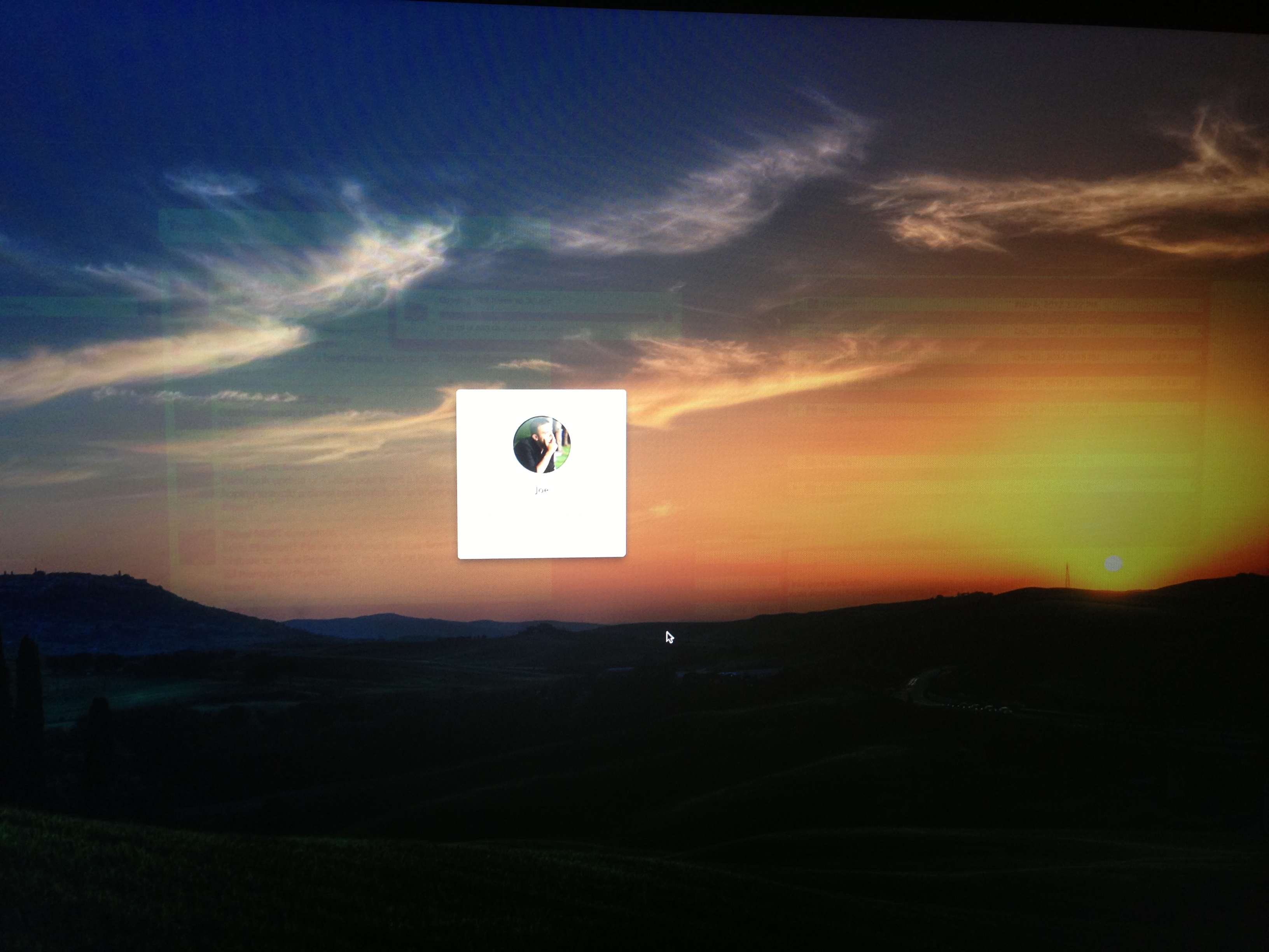

I've been posting in the thread about replacement iMacs but thought I'd chime in on here because my last 2 replacements have been plagued with image retention issues.
I thought my most recent unit was good because soon after taking it out of the box I ran an IR test and didn't not notice any issues. However. after a few hours of light usage I had left a few windows open for about 10-15 minutes while I transferred over some data from my old MBP and I noticed this tons of IR. My 2nd unit had IR (and a ticking\popping sound that seemed to be affected a change in screen brightness) but this seems worse.
Do people actually have good screens that don't have IR, yellowness or uneven lighting? After 3 units I'm starting to give up hope... 🙁
Would also really like to know this- have there been any tried and tested success stories? Presumably they cant all be this bad because surely this thread would be going crazy?
Yes. Mine has no retention. Or if it does, I can't see it.
My 2008 iMac had retention along with it's replacement screen (replaced days before applecare expired!!!). But the retention didn't start until about 1 and a half years into its life. It started after they replaced the internal power unit of the machine. It was the same as some of the examples on this thread. It's unacceptable really and you should send them back until a decent unit comes along. But this isn't a new issue and only on the 2012. this happens with every new Imac from what I've seen on these forums.
