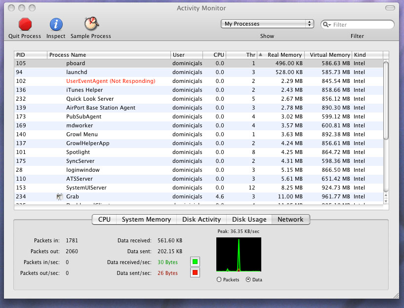

Ive attached a picture of something that looks strange too.
Im at a loss here. I came from a terrible PC and I really hope I havent hit bad luck again. I spent way to much on this machine because its supposed to be my savior....but now its crashing as bad as my PC...is not worse 🙁
