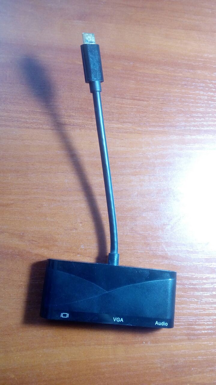

Now is 2018, and i have same issue, opened just browser and skype, version 10.13.6 (17G65), MacBook Pro 15" Space Gray (MLH32) 2016, connected via HDMI
temperature 55-65
