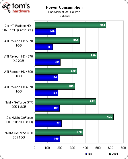

http://www.tomshardware.com/reviews/radeon-hd-5870,2422-20.html
http://www.tomshardware.com/reviews/geforce-gtx-670-review,3200-14.html

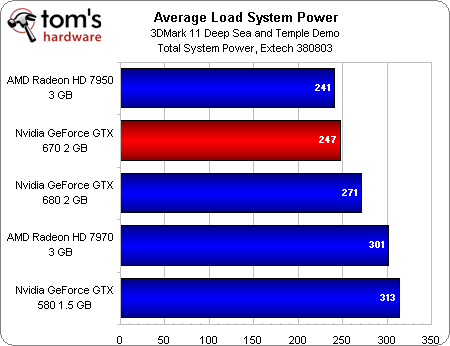

The only real question pertinent to this thread is: Does the GTX 670 draw too much power for the two on-board plugs to handle. Being as how it draws less power than even the Radeon 5870, and there are several GTX 670's with two 6-pin plugs, I'm not seeing it. [Edit: As someone else points out later in this thread, the reason this card has the extra 8 pin is so users can manually overclock it past the already-overclocked factory specs.]
I don't doubt many cards are capable of overloading the 6 pin plugs, I don't see how this can be one of them if it's drawing substantially less power than previous cards that have not. [edit: The 8 pin plug on this card is really only needed for manual overclocking.]
Electricity is not magic, more is more, less is less! Just because it's got a different plug doesn't mean adapting it is going to cause problems.

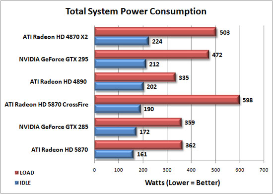

Edit3: I've looked at 4 different reviews, none of them say anything to suggest the GTX 670 uses more power than the Radeon 5870.
Edit: looking at the 580--the one you're pointing out issues with--it looks like the power draw is substantially more than the GTX670. The 5870, which functions presumably fine with two 6 pin plugs, draws more than the 670, but less than the 580
http://www.legitreviews.com/article/1925/13/
For comparison:
http://www.legitreviews.com/article/1080/13/

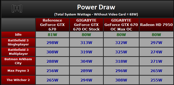

Edit2: it occurs to me that this particular card automatically over-clocks so it may be different from other 670's. As you can see from this review, it is still less than the 5870 (and less than the EVGA for that matter)
http://www.hardocp.com/article/2012/07/25/gigabyte_geforce_gtx_670_oc_video_card_review/10
