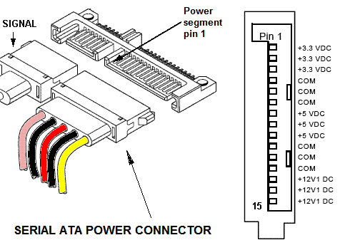

Get a SATA to molex connector. I'm powering one of my cards from my drive bay using a SATA to molex cord.
Be careful about this, as far as I know the SATA power cable does not provide the full 75W that the card expects. I'll see if I can dig up the actual numbers.

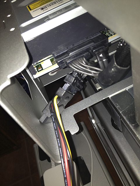

What we are going to do is taking power from the DVD-ROM unit. It will not affect the performance of it, and the card will have enough power

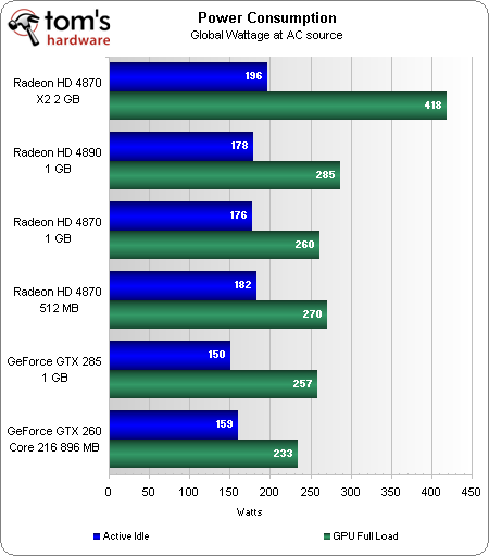

The GTX 670 -- at least gigabytes -- can consume 325 watts. The 5870 consumes even more than that (as I note earlier in this thread.
The 4870/4890... well take a look:
As you can see, they consume a lot less. So yes, these new cards (GTX 670 + 5870) consume significantly more power than the 4870/4890 that you have had "no problems with". I would highly recommend re-examining your setup if you do indeed run either one of these cards off a single 12V lead coming from the drive bay.

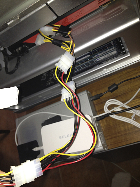

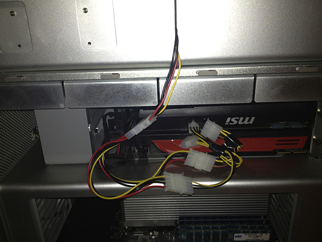

Thank you for the information. I'll take some pictures in a few minutes to show you what cords/wires I am using exactly.
I apologize if I seemed rude before; I'm not electrically inclined in the slightest, and I was only following steps that worked before.
Here's the cords I am using:
Yep, that's pretty much how I assumed you had it setup. At least it looks like you're using a reference card GTX670 (lower power than the others). The greatest resistance is going to be right on your SATA connector.
Those three tiny 12 volt squares of metal have to handle up to 12 amps in your setup. They are rated for 1.5 amps each according to this--totalling 4.5 amps. That's only 54 watts, when it should be 150 watts
Again, it probably wont break any of the expensive components (like the motherboard or PSU... provided Apple isn't using single rail...). However, potentially you could have some issues with damage to the wires, lower framerates, and software instability.
If it works for everything you're using it for and you're okay with the risk, I guess there's no reason to change anything. Just don't play Battlefield 3 on max or that little connector is going to be very upset with you :)

Dude, you are asking for a world full of hurt with that mess of adapters.
Every adapter you add is adding to the resistance, if you insist on powering things this way, solder the wires yourself and cut 15 inches of thin cheap steel wire out of there.
Here is something to think abbout, I just pulled a DVR-105 from my Mac Pro. It claims to draw a max of .6A at 12V. So the DVD drive draws 7.2 Watts. So two if them draw 15 Watts. I doubt Apple planed on drives drawing more than 10 Watts. And you are drawing 150 Watts through the same power system. Really think about that.

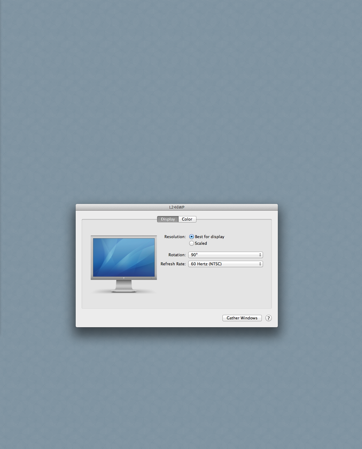

I installed a MSI 680 however my second LG screen (use HDMI to DIV cable) no longer working! I have screen but it does not display the correct resolution.
Any ideas?
