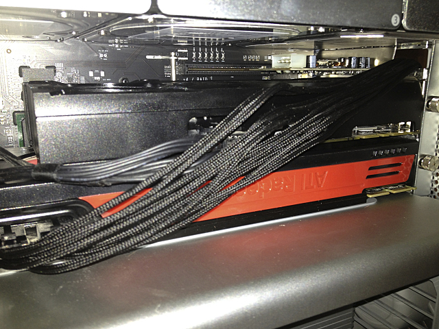

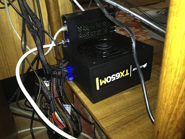

OKAY!! I went today and bought a Corsair Professional Series HX650 Modular Power Supply. I also bought two 18" 6-pin extender cables.
I used the paper clip method you suggested on the green and black wires to jump start the PSU. I also wrapped the paper clip in electrical tape just to be on the safe side.

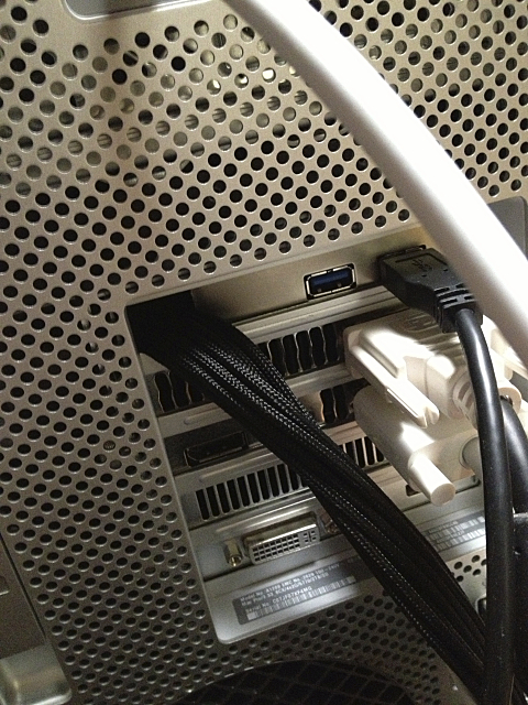

The hardest part was routing the 6-pin cabins from the PSU back into the case. I have two double wide video cards in there as well as a LaCie PCIe USB 3 card, so it looked like doing the routing from the back of the case was out of the question.
I thought about routing the cables through the empty optical drive bay space...but alas the cords, even with extensions, weren't nearly long enough. I also didn't want to create more resistance as MacVidCards warned about by adding further extensions.
I went back and pulled the PCIe USB 3 card out...took it to a vice and put the end of the metal bracket in between the clamps. I gently bent the metal bracket of the card back and forth until the metal snapped off. Then I had an inch of room for the 6-pin extensions to fit through even with the PCIe USB 3 card installed.
Now the whole computer is running beautifully. I should no longer have any worries about over-extending my computer's power limits!
