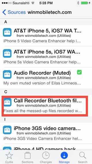

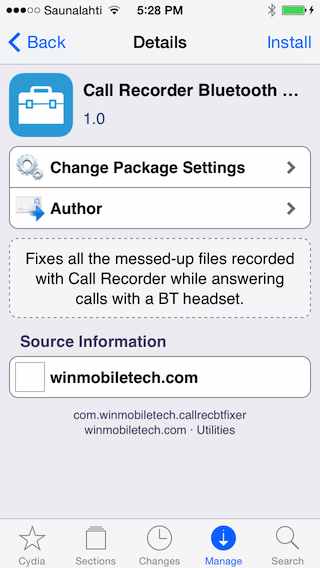

OK guys, here it is.
Source code: https://dl.dropboxusercontent.com/u/81986513/012014/05-recorderno44khz/Change44kHzCAFsTo8kHzOnes.zip
It can be directly compiled and deployed to an iPhone. As /var/mobile/Documents/AudioRecorder/ (the directory of the recorded files) is owned by mobile, you can directly change the files in the app even from an app deployed from Xcode. This also means no owner / permission changes need to be done anywhere in the file system - as opposed to, say, my full-sensor iPhone 5 / 5s video tweak overwriting a, by default, root-owned file.
If you can't deploy Xcode projects, DEB file: https://dl.dropboxusercontent.com/u...obiletech.callrecbtfixer_1.0_iphoneos-arm.deb
And, finally, I've also published it in my Cydia repo:
How does it work? (Programmers only!)
Given that CAF files produced by the app are very simple, instead of heavyweight, CPU-taxing full reencodes, I could just go the lightweight direct file patching method.
With the (buggy) 44.1 kHz files, at position $15, the three bytes contain "E5 88 80". These are to be changed to "BF 40 00" (8 kHz). This is very easy with the standard C file handler functions. (Note: I could have gone the Objective-C-based "let's read in the entire file to an NSData*, change it and write it back" way, but it would have required much more runtime memory, particularly with large files.)
With all these, my code is as follows (where "label" is an outlet to a label on the screen to show the user the number of CAF files / the nr. of changed ones):

Updated the OP to reflect the changes.
