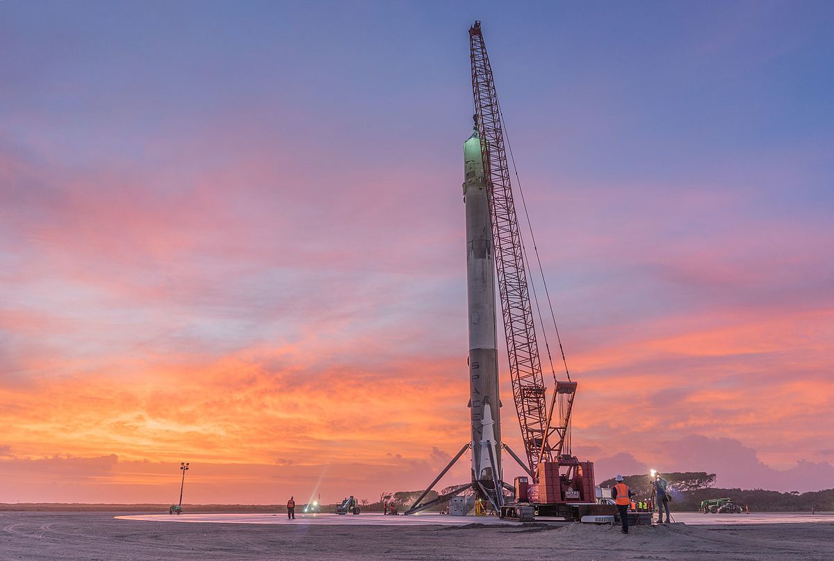

However, this idea that all SpaceX is doing is going up and down is either woefully devoid of context or just plain wrong. Making a reusable rocket system is not something that NASA has been doing EVER let alone for 50 or 60 years. We could get into other innovations, but to keep it simple, your statements either come from a lack of knowledge or an intentional downplaying.
I haven't said that going up and down is all they're doing. As I said, they're bringing optimization (as you point out), of which a reusable rocket system is part of it (however, you're nor entirely correct. The Shuttle's SRB's were reusable. Also, albeit not a rocket per se, the Shuttle and its engines were reusable). This doesn't change that for now their missions are relatively simple. They're doing lots of work around those missions because, as you rightfully point out, they are focusing a lot on the optimization of everything.
In terms of the "true problem" I guess that depends on perspective. If finances weren't a "true problem" we never would have stopped exploring space to the degree we did once we got to the moon. So SpaceX focusing on how to make money so they can continue to push forward with space development and exploration to me is one of the largest "true problems" that face humanity. Propulsion is mass in/out until someone has a major physics breakthrough, which no one is thinking is going to happen anytime soon (hundreds of years+). So that is not really a "problem" as much as a limitation. Engine design is not a problem, in fact SpaceX and most any other aerospace company has commented on that being the least difficult thing in the rocket designing process. ECS...sure but that only matters if we have the funding to even make that important and even then there is a lot that can be done with what we have before it becomes a limiting factor. Again, just my hobbyist opinion.
Well, no arguing from me about the finances, but I obviously meant technical issues. Propulsion is expensive and limiting, and ECS is very difficult due to its constraints.
SpaceX has the great advantage of being free from the governmental appropriation process, although they have a severe budget limitation compared to NASA.
USAF and NACA had been studying orbital reusable spaceplanes since 1958, e.g. Dyna-Soar, but the first reusable stages did not fly until the advent of the US Space Shuttle in 1981.
20th century[edit]​
McDonnell Douglas DC-X used vertical takeoff and vertical landing
Perhaps the first reusable launch vehicles were the ones conceptualized and studied by Wernher von Braun from 1948 until 1956. The Von Braun Ferry Rocket underwent two revisions: once in 1952 and again in 1956. They would have landed using parachutes.[13][14]
The General Dynamics Nexus was proposed in the 1960s as a fully reusable successor to the Saturn V rocket, having the capacity of transporting up to 450–910 t (990,000–2,000,000 lb) to orbit.[15][16] See also Sea Dragon, and Douglas SASSTO.
The BAC Mustard was studied starting in 1964. It would have comprised three identical spaceplanes strapped together and arranged in two stages. During ascent the two outer spaceplanes, which formed the first stage, would detach and glide back individually to earth. It was canceled after the last study of the design in 1967 due to a lack of funds for development.[17]
NASA started the Space Shuttle design process in 1968, with the vision of creating a fully reusable spaceplane using a crewed fly-back booster. This concept proved expensive and complex, therefore the design was scaled back to reusable solid rocket boosters and an expendable external tank.[18][19]The Shuttle was more expensive to operate over its 30-year lifetime than an expendable launch system would have been.[citation needed]
In 1986 President Ronald Reagan called for an air-breathing scramjet National Aerospace Plane (NASP)/X-30. The project failed due to technical issues and was canceled in 1993.[20]
In the late 1980s a fully reusable version of the Energia rocket, the Energia II, was proposed. Its boosters and core would have had the capability of landing separately on a runway.[21]
In the 1990s the McDonnell Douglas Delta Clipper VTOL SSTO proposal progressed to the testing phase. The DC-X prototype demonstrated rapid turnaround time and automatic computer control.
In mid-1990, British research evolved an earlier HOTOL design into the far more promising Skylon design, which remains in development.
The commercial ventures, Rocketplane Kistler and Rotary Rocket, attempted to build reusable privately developed rockets before going bankrupt.[citation needed]
NASA proposed reusable concepts to replace the Shuttle technology, to be demonstrated under the X-33 and X-34 programs, which were both cancelled in the early 2000s due to rising costs and technical issues.
