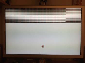

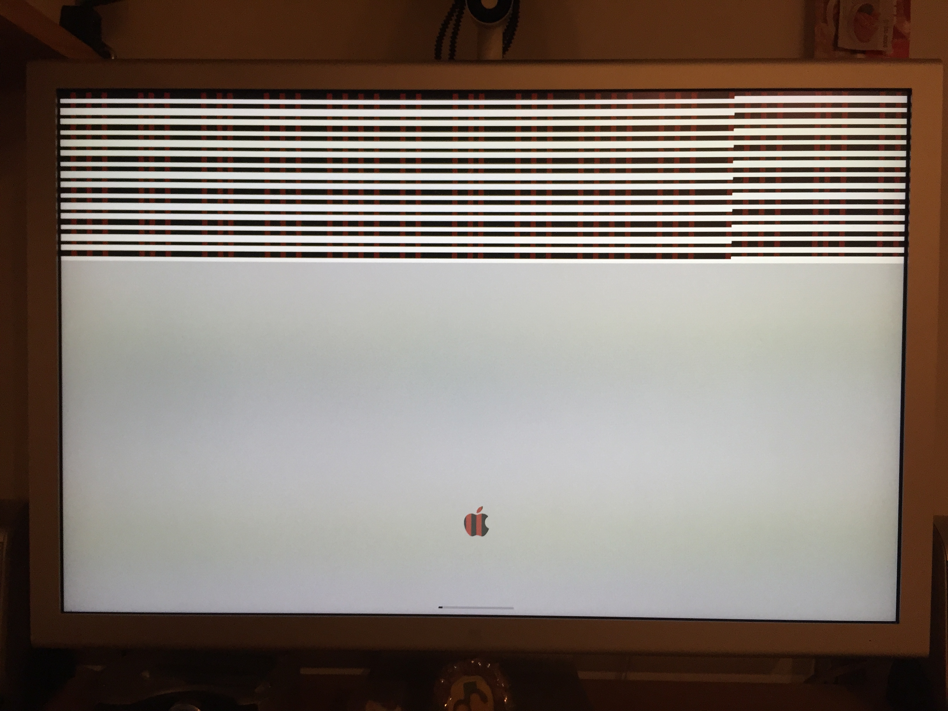

Follow is my spec
1: 8800GT (replaced at last year by second hand org. display)
2: OS in ssd
3: 4 x hd in slot 1-4
4: OS X 10.11 beta 4
Before that photo my Mac Pro work fine, suddenly the display is crack, so I'm try to reboot by power switch, after reboot that photo is here and the bar under the apple only can run 3/4 and it will auto reboot, so I'm try to reset pram but still in follow picture, after that I'm thought it should by the display card problem so I'm try to take display out but still in auto reboot, what can I do in next step?
Thanks

Have you tried booting from another OS X installation, from another HD?
Have also in mind that the 8800 is famous (or not) for its problems - failures...

Thank your reply first, I'm try to use my back up hdd to boot with OS X but still in same issue. One more thing I'm pay attached is the psu when start up the fan is in high speen after few seconds around 5-10 it slow down.
My hope is just the display card is down because it cost less.
