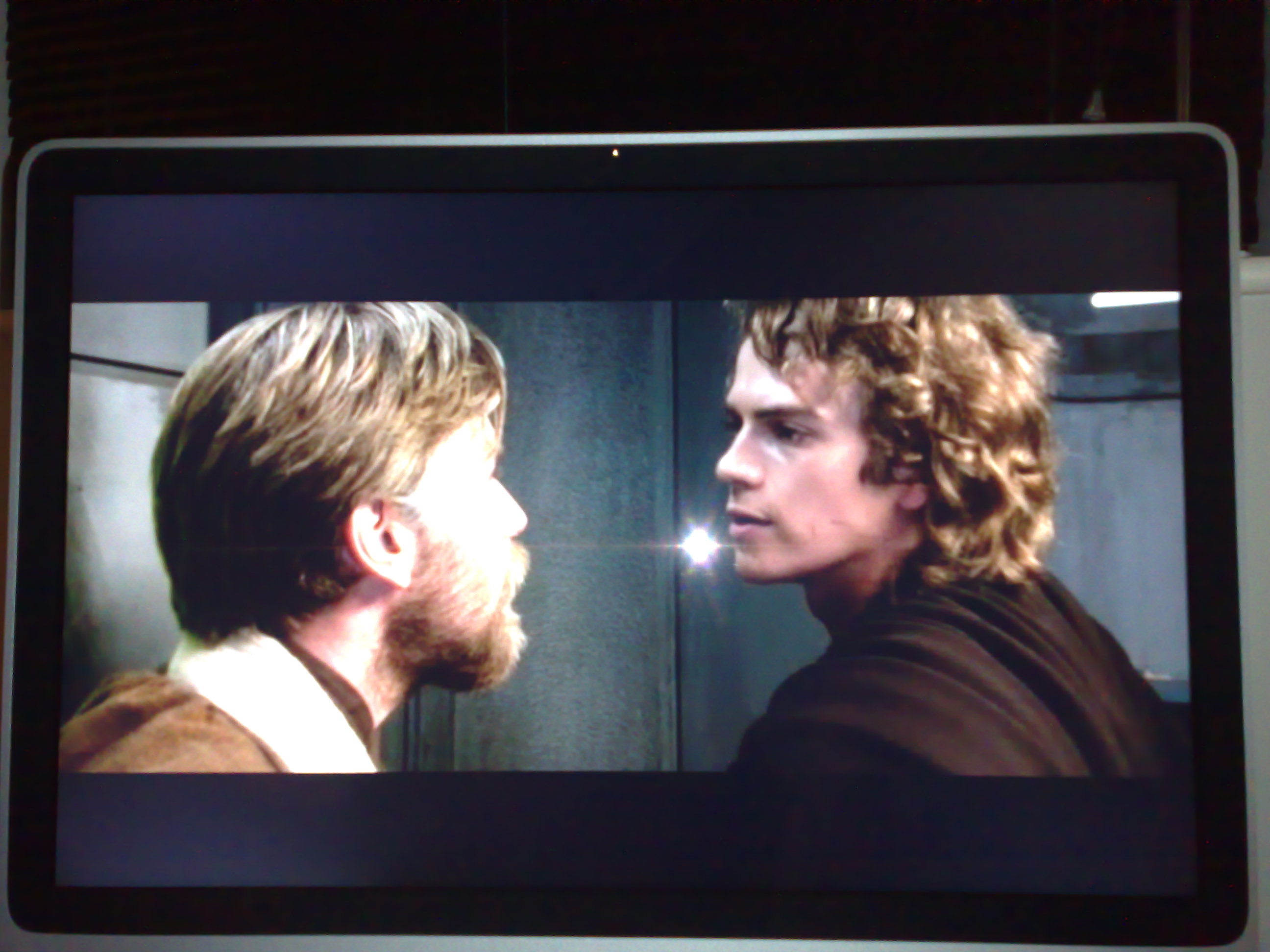

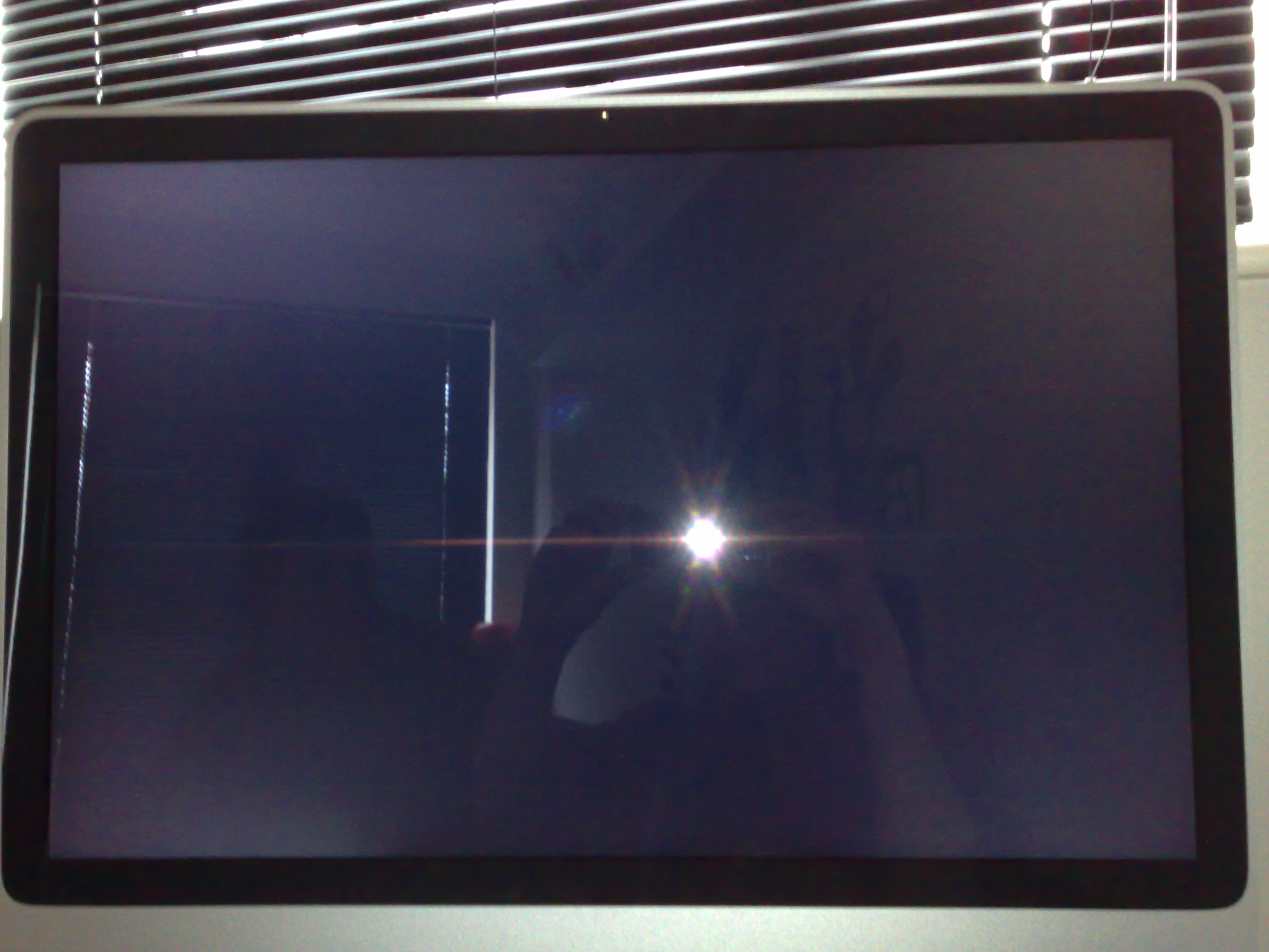

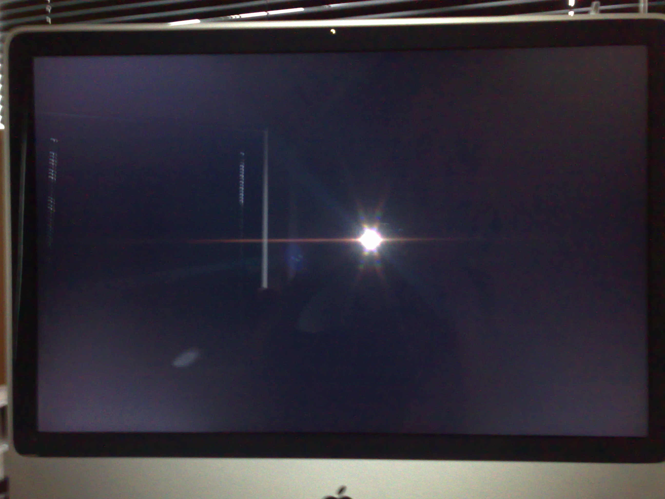

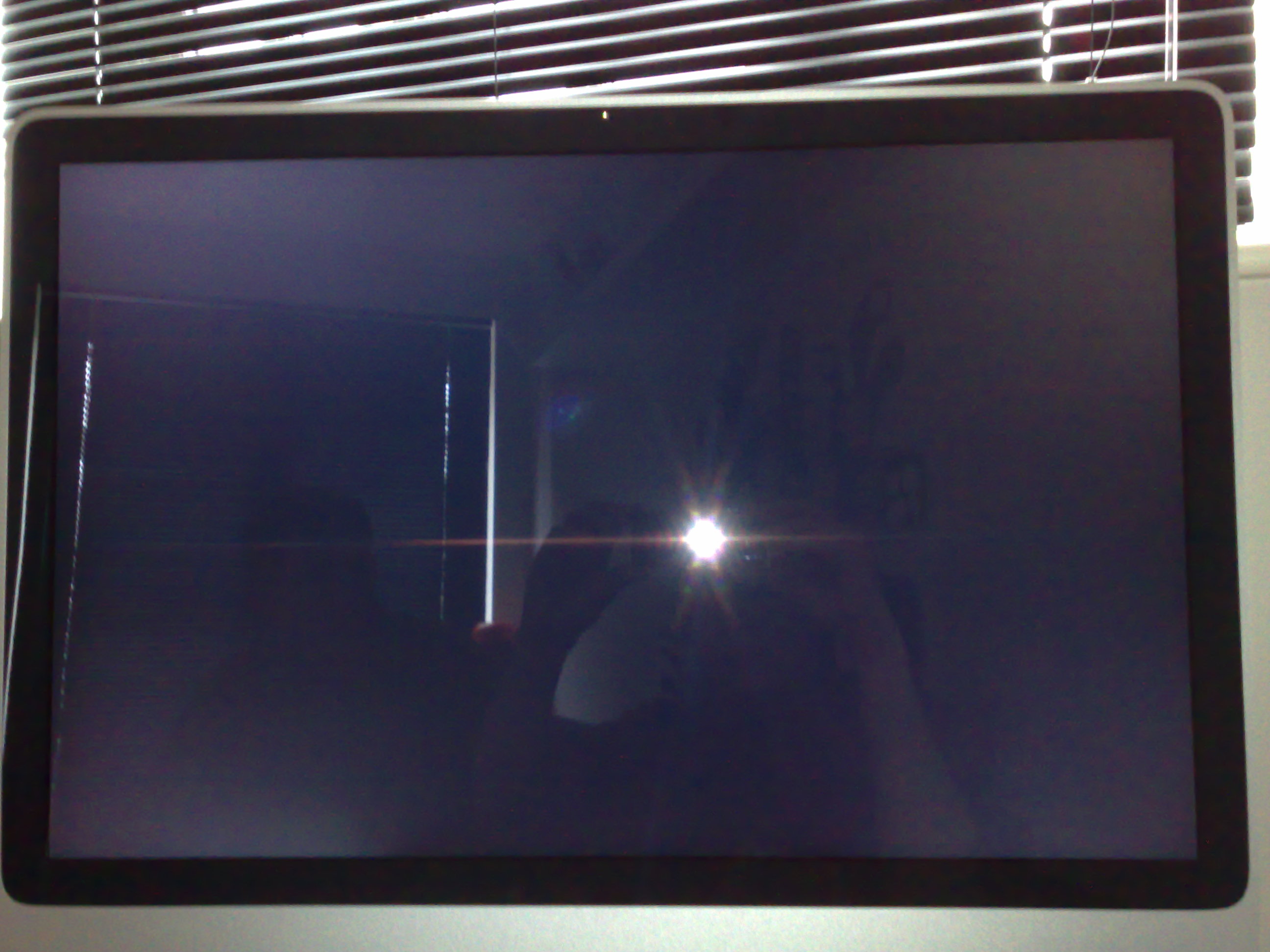

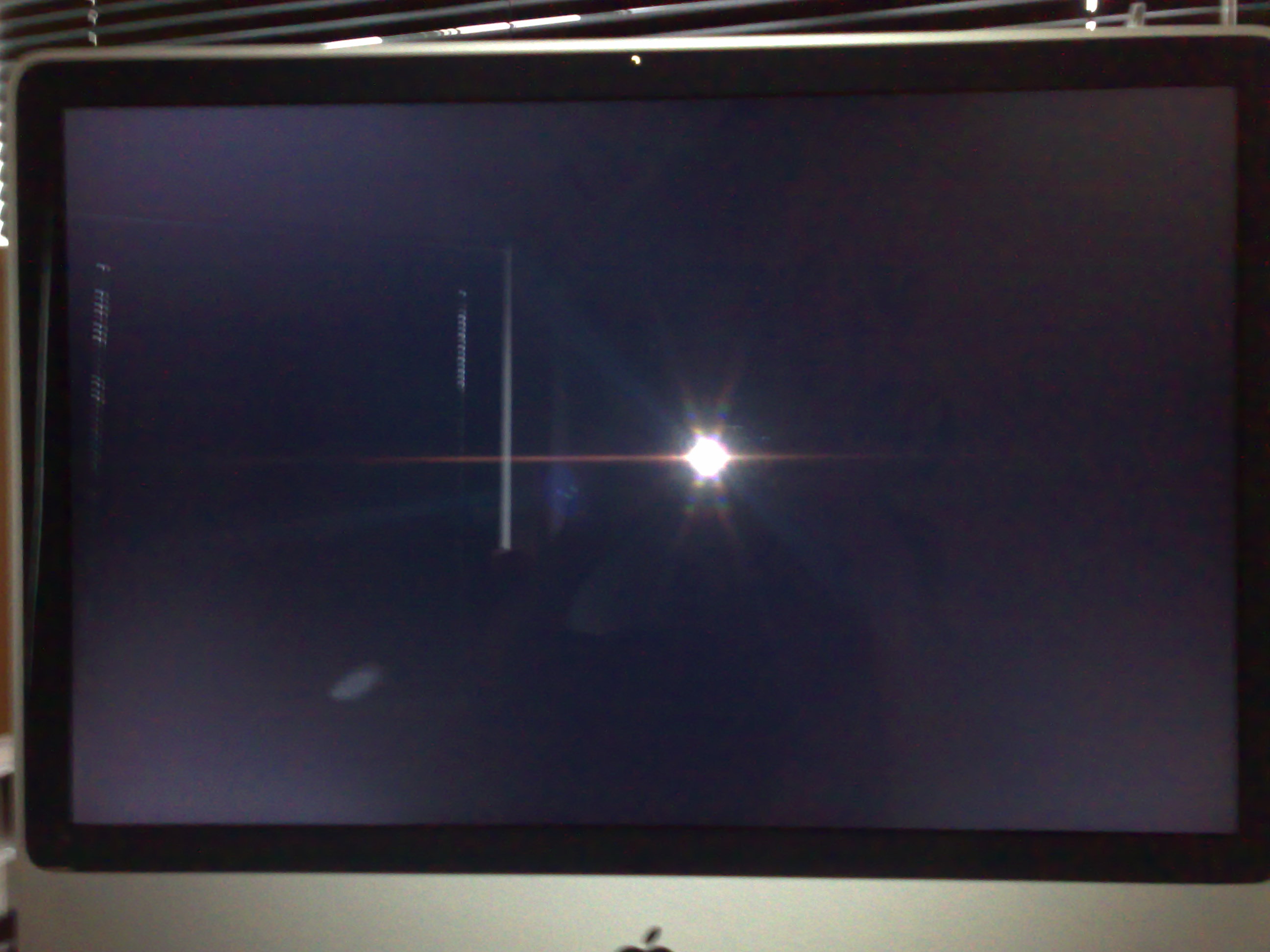

See below for some backlight pics......not pretty and representative of ALL the 15 units.
Do you feel this is acceptable? I have never seen such uneven backlighting on any LCD I personally have owned.

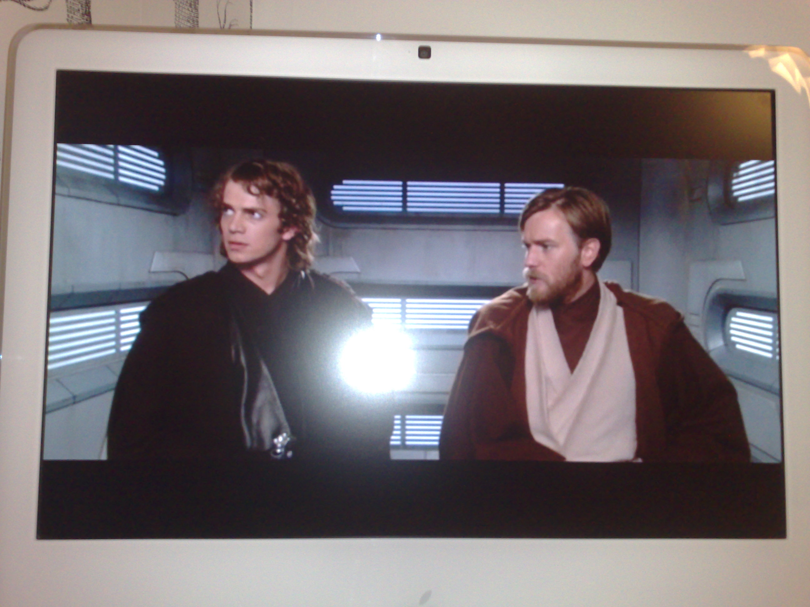

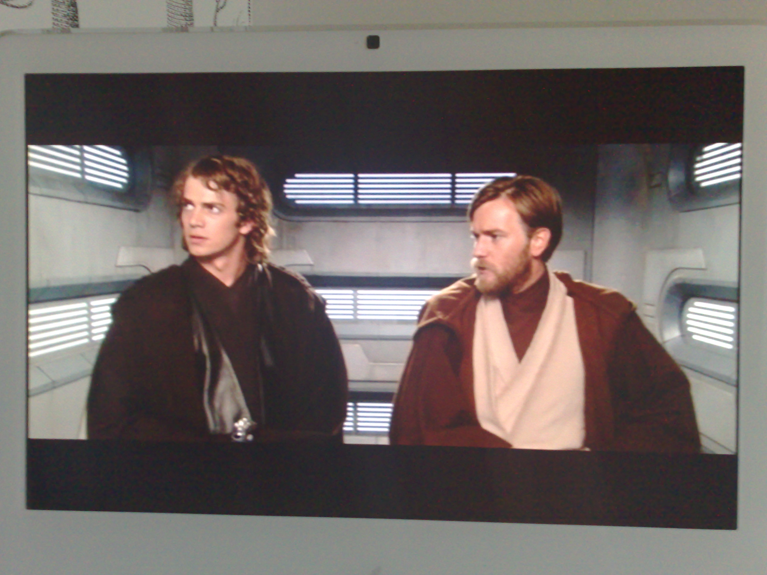

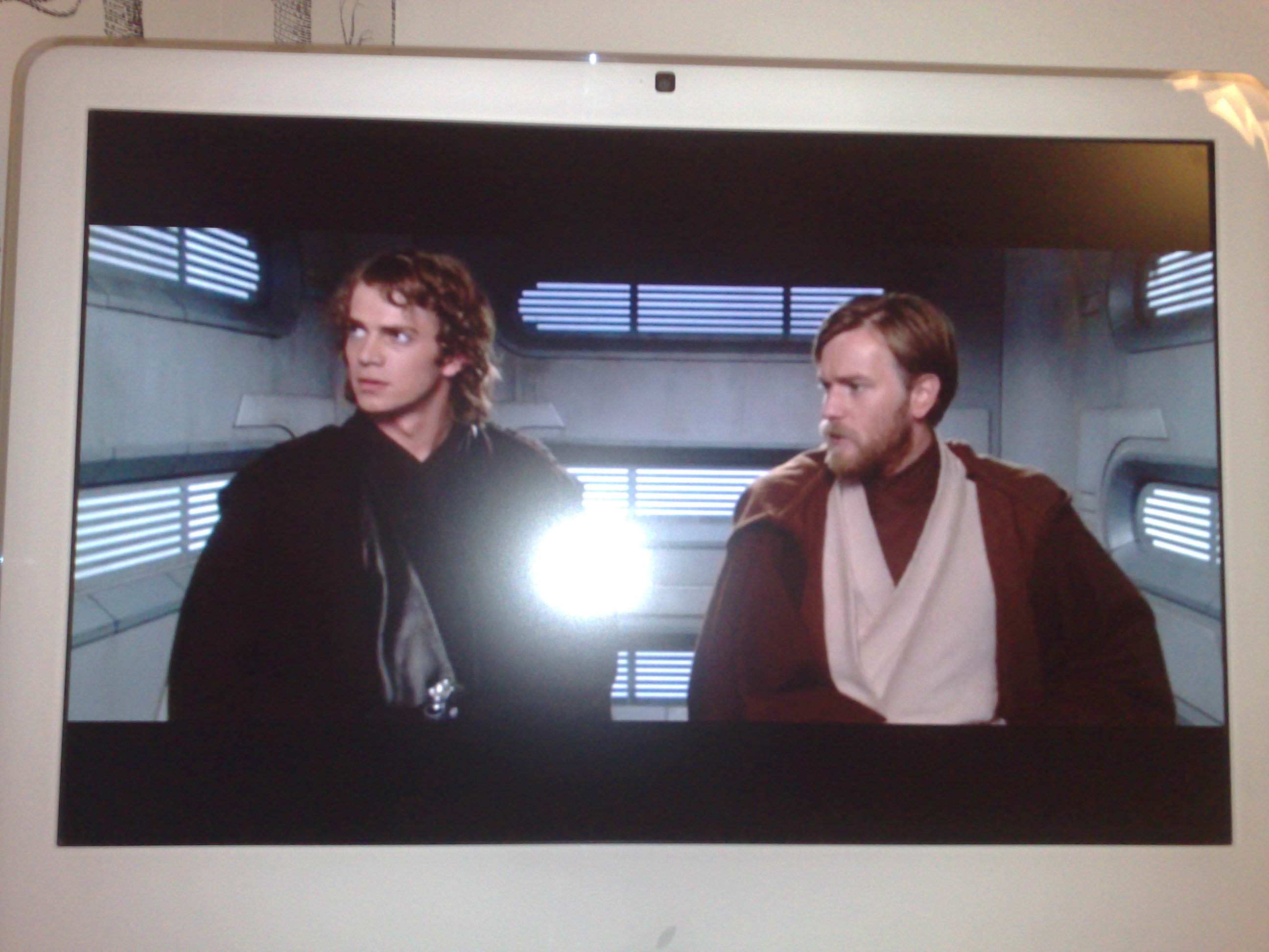

My 20" white imac.....look no bleed! The 24" imac should be an upgrade in screen quality on my old machine.....not a downgrade! Same film, same camera etc.

No, that is not acceptable. I too have some slight bleed on the bottom that I don't notice in daily use, and notice slightly when on an dark screen in a dark room. I wonder if you went through a bad batch or something. Certainly if it can be shown that every 24" they are currently shipping has this same issue, that is a problem.
It's weird that mine and others does not have this severe bleed issue, and you saw 15 in a row with it. I wonder if there is a bad batch out there? I suspect that a bad batch is also what caused the 250% brightness gradient (on a grey screen) when the Alum iMacs first came out - some were claiming to get 2-3 in a row and seeing 10 in the store with the issue, but many more were getting good ones. The only reasonable explanation I could think of is a bad batch.
BTW - Apple accepted returns on all the gradients last summer/fall when they were happening, and they eventually got it ironed out. I suspect the same will happen here, if this "bad batch" theory is true.

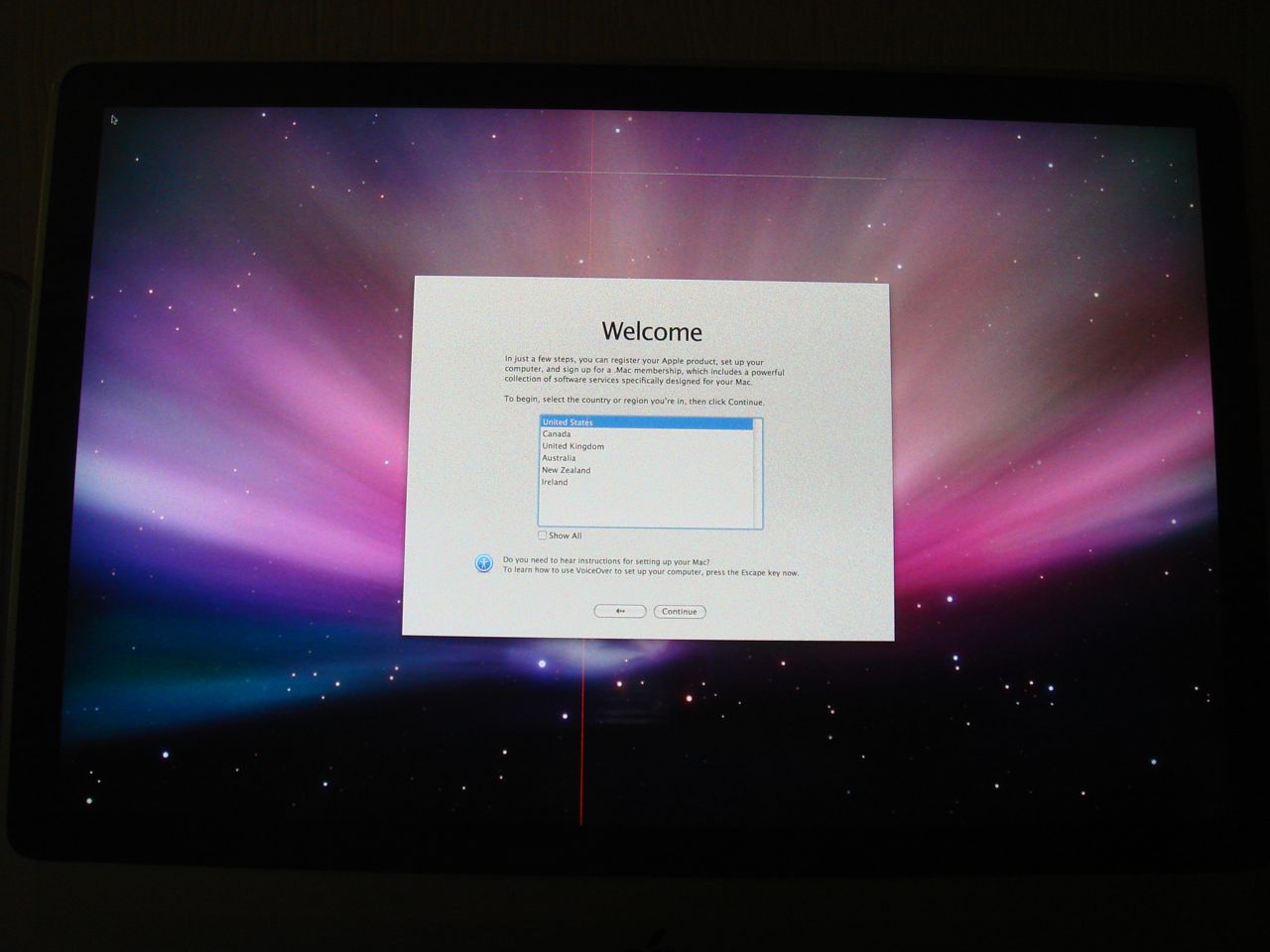

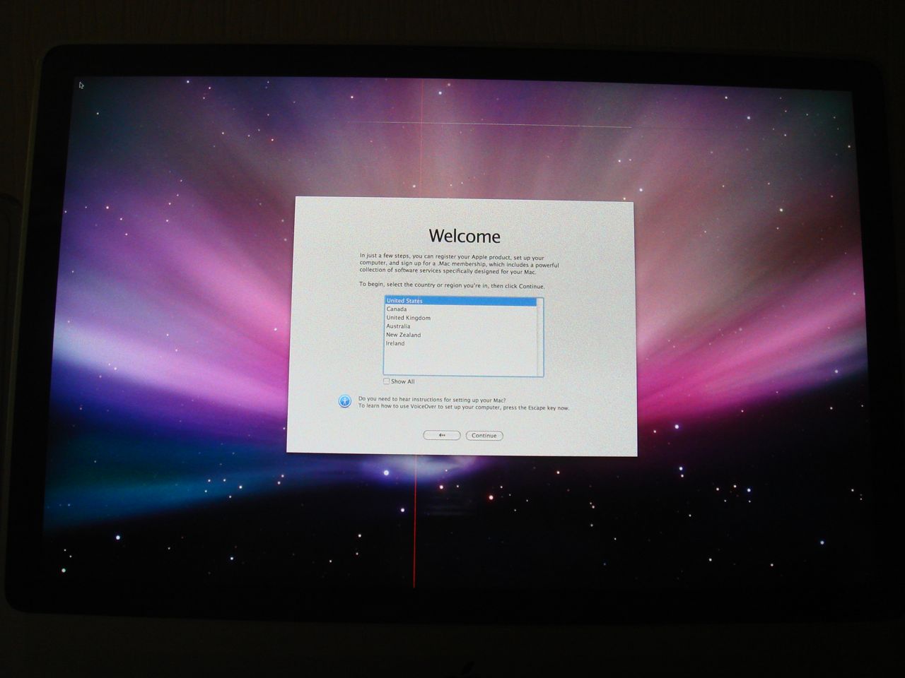

Like I said on the other post, my 24-inch iMac comes with a bad display. Red and white lines on it.
Who would use flash photography to take a head-on pic of a reflective glass screen, to illustrate a point about evenness of lighting?
Look at the lower one of the first set of three. The top left corner shows a hazy highlighted area you'd have us suppose was a light leak on the screen. Yet in the alternative shot directly above it in the same posting, that top left hazy area is in better focus, with a very well-defined horizontal edge that is most certainly the point at which your lighter colored ceiling meets the wall and is reflecting in the screen.
Then you posted an example of what you call a screen without a problem. Yet this particular photo shows a similar reflection to the others, this time in the upper right corner. The images are of no value whatsoever.
But again, not representative of all the new 24" screens. I have one in front of me right now and it looks nothing like yours. It looks excellent, with no observable highlights or dark areas or gradations. And none of the machines I've looked at in two of the three Apple stores in my area show any such problem when set to display flat colored backgrounds. That's at least 8 more machines.
Suggesting that all the new 24" screens are bad because the ones you've seen are faulty, is no more accurate than me pronouncing there are no faulty screens because all the ones I've seen are fine.
The same thing happened with a backlight uniformity issue last summer/fall. Many people got good ones, but there were similar reports of bad batches that filled out an Apple store with them. (that's what I thought Dantay was talking about when he said gradient, and I posted a picture of my grey screen iMac with no gradient - but I think he is talking about the backlight bleed). The bad batch theory is the only thing I can think of to explain what you are saying AND what he is saying. We can only hope that a few bad batches is the exception, and not the rule, or Apple may be in big trouble on this one. Time will tell.
This is exactly right. To show this properly, you need to:
1. Take the photo in a completely dark room
2. Do NOT use flash
3. Use a tripod to avoid the inevitable camera shake
4. Use the camera's lowest ISO setting to make sure that the colours aren't skewed (a digital SLR will be much better than a compact)
If the room isn't dark, you will get different brightness depending on the brightness of the walls/ceiling reflecting off the screen (which is also why flash shouldn't be used).

Yep. Also:
5. Back up 6-8 feet and use a moderate telephoto lens so that the display
nearly fills the frame. This eliminates pincushion, and minimizes artifacts
related to viewing angle.
6. Set the display brightness to minimum. The 24" iMac display gradients
are most pronounced at minimum brightness -- and minimum brightness
is still FAR TOO BRIGHT for proper color calibration. Industry standard
calibration calls for 120 cd/m^2, and even at minimum brightness, the
24" ALU iMacs are 50% to 75% brighter than that. [Yech!]
7. Shoot "Solid Gray Medium" and "Solid Aqua Blue" backgrounds, as well
as solid white. When in doubt, error on the side of underexposure.
... 8. If ya can't handle the truth, don't go lookin' for it,
LK

Two of the THREE Al 24" iMacs I returned looked very similar to Dantay's pictures with the black screen, totally unacceptable.
LOL Sir Cecil, it sounds like because Dantay took a picture using a flash under what you deem "not the right conditions" you deny he has a problem, when anybody with normal iSight can see from the picture that that screen looks crap for a top of the range and top dollar Apple product. Unless of course he has manipulated the photo, which I very much doubt.

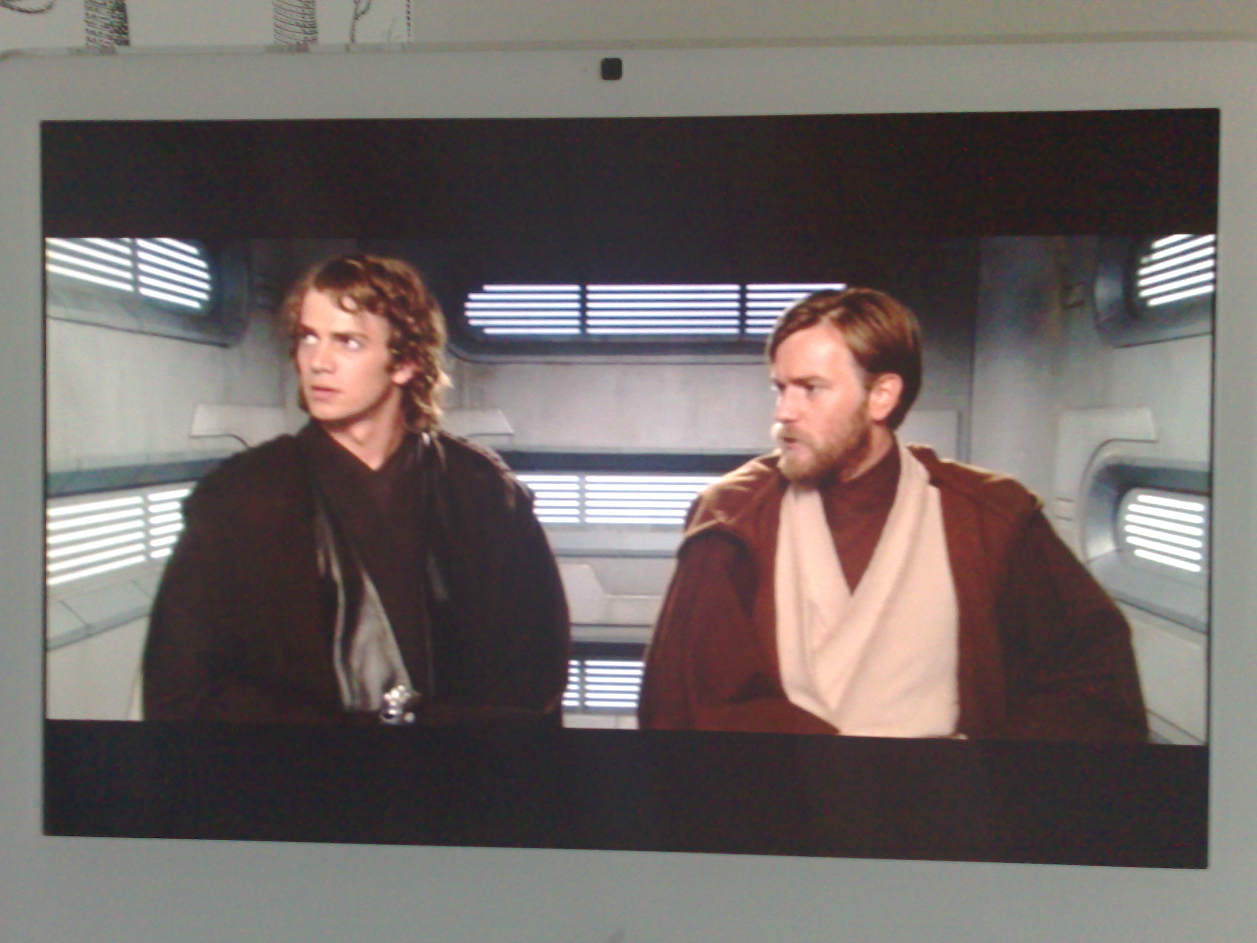

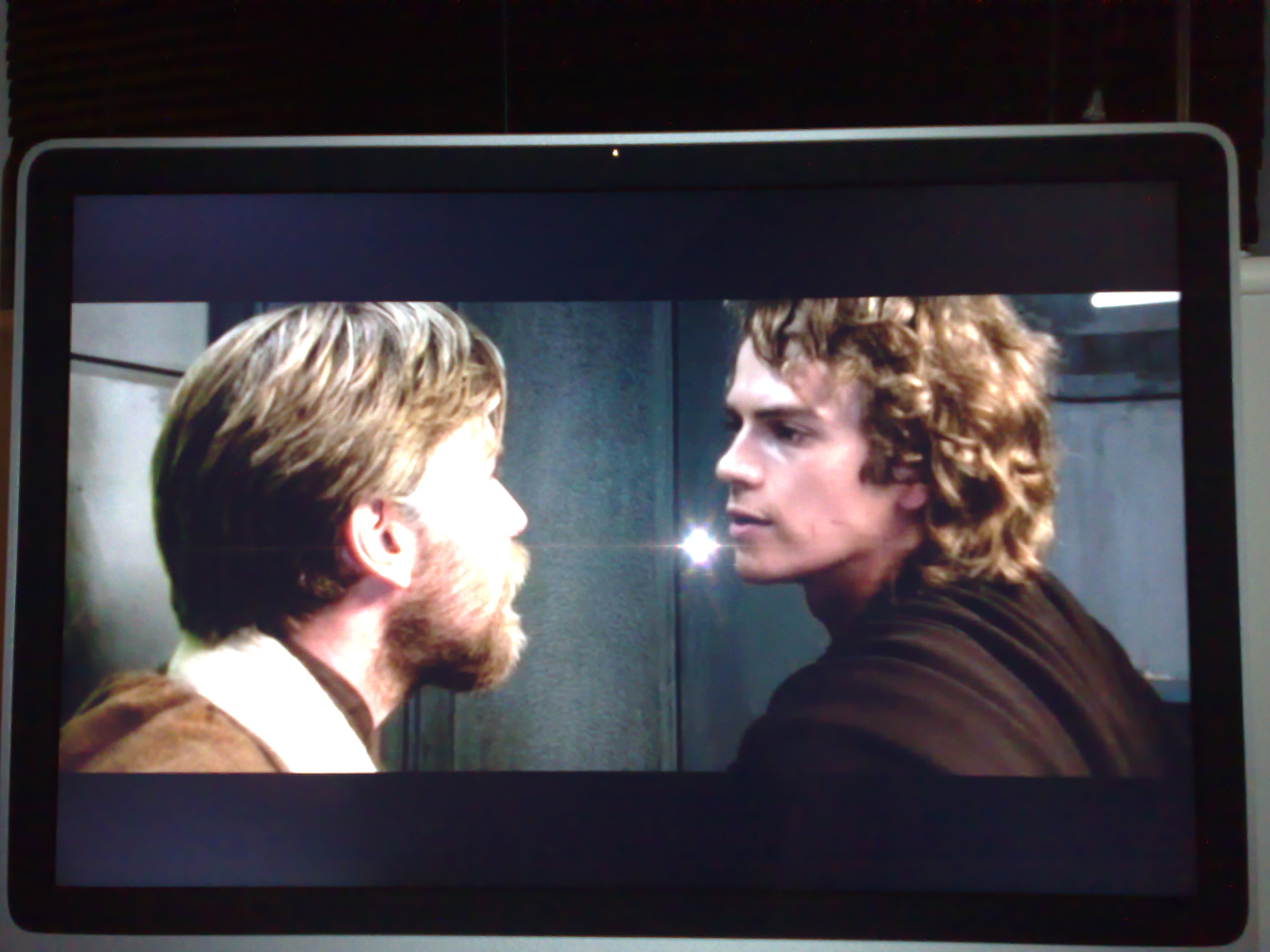

The camera flash makes no difference to what is seen.....the screen bleed is there exactly as shown. The week numbers are 5/9/11/14/16 and from 2 different plants so I dont think its a bad batch. This is a real problem that is instantly visible so Sir Cecil please do come on......if yo think a flash produced that effect you try and reproduce it. I am only here to highlight a problem on the macs I have seen and owning one of the old generations of the machine does give me a good reference point.
Pic below of my white 20" taken this morning with NO flash. I will be getting number 16 today Sir Cecil so please be sure to let me know how you would like the pictures taken to show the problem in a way acceptable to you. Tips on how to take pics of a crappy screen with issues from any other fan boys with pro-apple goggles on would also be great. 😉
