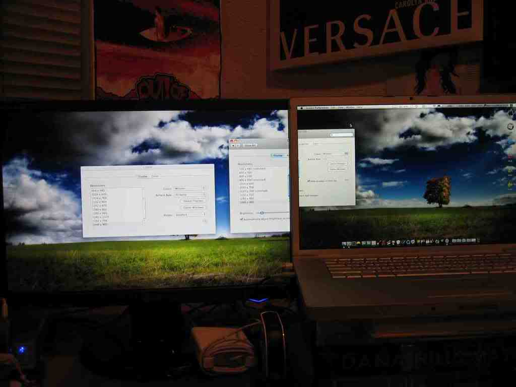

so i got a second display to replace the old sucky one.
its nice
but one thing is wrong.
things are way bigger on the new screen, compared to mbp screen.
like if something is 4 in tall on the mbp it will be 7in on the new screen.
my old didn't do that, so...
i also noticed that the max display for both is 1440x900 so in the display arrangment it show that it is the same size. which it is clearly not.
help is much appreciated.
i played with the display size witch both are 1440x900 but my mbp is 15 in and the new one is 19 in. searched on here, and actually read the manual.
also it is really hard to get the screens to line up but i think once the size is fixed they should line up. is there a program where i can put numbers in to move the screen instead of inaccurately moving it with the mouse
please help because i just wasted my entire pay check on this and it is not clearly working how it is supposed to.
i am totally stumped.

Assuming your external monitor is set to its maximum resolution, then it looks the way it looks due to the inherent pixel density differences between the two displays. Basically, the monitor on the left side has bigger pixels.
Until resolution independence goes mainstream then you're stuck with the pixel size differences. (Don't hold your breath waiting, it's a couple of years away.)
You'll need a monitor with the same number of pixels per inch. (essentially what was posted by another member)
You can either just measure the width, or use trig to get the DPI based on the diagonal screen size.
Off the top of my head, I think even 19" 1680 x 1050 will be slightly larger than the 15" 1440 x 900.

The problem is both are native 1440 x 900. One is a 15" diagonal, the other is 19" diagonal. The only thing that could be done to match the physical dimension of an object on the screen, is to reduce the DPI of the 15" (like to 1280 or 1024).
I'm thinking that the OP got the resolution of the 19" from reading his display as it is in his photo, and not from the product specs. If I were to start my 15" MBP with my 22" LG monitor connected it would display the same 1440x900 resolution. By connecting it after start up for some reason, it recognizes the display properly. The way to know would be to see what is displayed on his external LCD in the above posted photo. If it only says color LCD it's not recognizing the monitor properly. It should be displaying the model of the display.
Possibly. But, that resolution isn't uncommon for a 19". I have one sitting across the room [at 1440 x 900 native]. edit: just looked back at the OP pics - the last res in the list is the highest the display is capable of. I can't see how that would be inaccurate on a DVI display (making the assumption it's connected digitally).

ya sorry about the photo but thanks guys. (photo bucket was slow so i cut the image into about the 1/4 of its quality)

Just use your ruler and do some math.
Code:
 number of horizontal pixels
--------------------------------   =  # of horizontal pixels
 number of horizontal inches
For example:
Code:
    1024 pixels
---------------------  =  102.4 pixels per horizontal inch
 10 inches wide
So for 2 monitors to display the same image at the same physical size then they need to have the same number of points per inch (ppi). You can get the screens to have approximately the same ppi by changing their resolutions to make the math result in similar PPIs, but using an lcd display at anything other than it's native resolution isn't gonna look that great.

No OS has a resolution independent interface yet. Apple is working on it and it should be here in a couple of years, probably before MS Windows gets it.
I've spent a lot of time in Mac forums, a place where people tend to complain about anything and everything, and I don't recall anyone ever really caring too much about this. Most people don't care that things display at different sizes on different monitors. Also, this lack of ppi info isn't limited to apple either, I've very rarely seen a ppi spec located in any monitor manufacturer's spec page.
And if you care about knowing the ppi then you can just do the simple math. If you want to figure out the ppi info from the specs, you just have to convert the published screen size which is the diagonal size into the width size using 1 trig function. Then just like above divide the horizontal resolution by the screen width.
o so this is what i calculated
my display is (MBP) 1440 x 900 15.4 in
.2303 Dot Pitch (DP)
110 Pixels per inch (PPI)
my old display is 1280 x 1024 16 in
.2479 DP
102.45 PPI
my new one is 1440 x 900 19 in
.28 DP
89 PPI
in other words im returned it, and im glad i did. it was poop.
