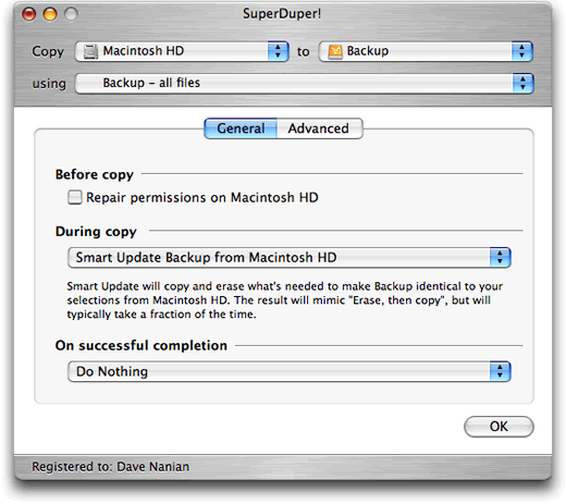

Have done this many times.... Gone from a small HD to a much bigger one with new partitions. Ive tried Carbon Copy Cloner and SuperDuper multiple times. From my experience, Carbon Copy Cloner has run into more "errors" where SuperDuper has done a flawless job of transferring the OS to a partition on a new drive. (I don't remember what they were other than the copy job not completing - on multiple occasions)
It's available here: http://www.shirt-pocket.com/SuperDuper/SuperDuperDescription.html
Really easy to use:
Make sure you repair permissions before the copy for good measure:
Good Luck!
